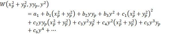

Since the system is rotationally symmetric, there is no real distinction between picking any (x,y) point rather than a point on the y axis alone (0,y). So, we end up with the generic description W(y²,yyp, xp²+yp²). Note we still have no closed expression for that wavefront, it is merely a mathematical statement saying that the wavefront depends only on the height of the object point, the height of the pupil intersection and the cosine of the angle between the object point and the pupil interception. So far it represents any rotationally symmetric system.
We can further compute the power series expansion of that generic function and we obtain
If you check the required units of the coefficients to produce a wavefront in meters you get ai in meters, bi in meters-1, ci in meters-3etc. The name third-order aberration theory comes from these units and means that we will focus our attention on the ci coefficients. There are higher-order aberrations (di and above) but only the ci can be easily computed from two rays. Also, systems with low third-order aberrations usually have even lower higher aberrations and it’s a good approximation to neglect them. More details on this later.
A specific remark corresponds to the bi which are the first-order aberration coefficients. I will not discuss them here but they correspond to paraxial optics (so-called Gaussian images of the point). We have already set a complete framework for the processing of paraxial rays in our previous posts so I do not feel the need to extend the discussion on these coefficients because it will be redundant to what has already been said but viewed under a different angle and might so eat unnecessary energy for a first exposition to system analysis.
You can remember that
represent a defocus, and,
represents a tilt (lateral deviation).
To complete our analysis on the W function, we have mentioned in earlier post that aberrations fall to zero as we get close to the optical axis. That means the aberration should be zero when we cross the center of the pupil
If we exclude the case y=0, this assertion can be true only if a1=b3=c6=0. The same reasoning can be applied to higher orders as well. Note that it is not something magic and it is coming from the fact that we describe aberration as the difference between any ray and the ray passing through the center of the pupil as it defines the general offset of the wavefront. For convenience in our mathematical treatment, we choose this offset to be zero.

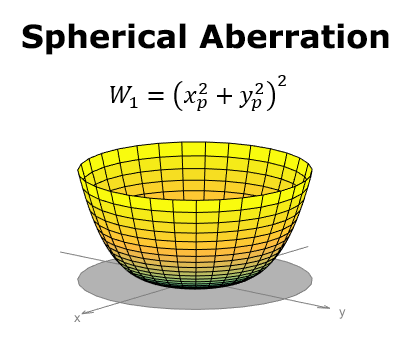

Spherical Aberration is shown in Figure 1. It is independent of the field position, y, and increase with the fourth power of the radial coordinate of the aperture. You can interpret spherical aberration as some sort of defocus that would be proportional to the square of the radial aperture intercept position. This means that rays close to the optical axis will not focus at the same position than rays close to the rim of the aperture. It also means that doubling the aperture diameter will multiply the spherical aberration by 4! It is usually the dominant aberration in non-corrected systems with low field angles.
Figure 1 – Spherical Aberration

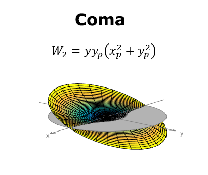

Coma is shown in Figure 2. It acts as a defocus that is both proportional to the field position and the pupil intercept coordinate along the field direction. As a consequence, coma is always negligible for very small field angles. The name coma comes from the comet-like shape this aberration produces. It’s shape is always oriented radially due to the yyp dependance.
Figure 2 – Coma

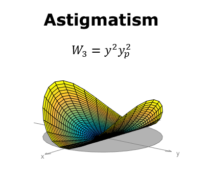

Astigmatism is shown in Figure 3. You can interpret astigmatism as some sort of defocus that would act only in the direction of the field position. That means you will have two different focus position, depending on if you are aligned with the field axis or with the perpendicular of the field axis. As for coma, astigmatism is negligible for low field angles since it depends on the square of the field position. As for field curvature, it also makes the system focus on a sphere rather than on a plane (more on this below).
Figure 3 – Astigmatism

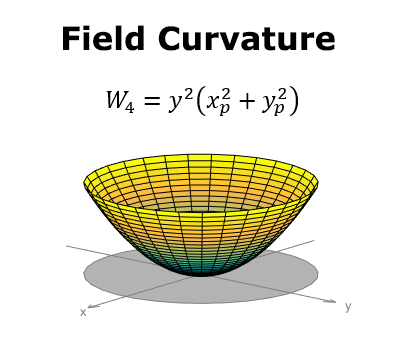

Field Curvature is shown in Figure 4. It acts as a defocus that is proportional to the square of field height. The consequence of the square dependence to the field position is that rays will tend focus on a sphere rather than on the plane. At contrario to spherical aberration, coma and astigmatism, the image of a point remains a point – just not where you expect it to be from a paraxial analysis.
Figure 4 – Field Curvature

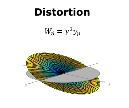

Distortion is shown in Figure 5. It corresponds to a lateral shift (tilt) that depends on the cube of the field position. Like for field curvature, the image of a point is still a point but it will be located at a different place than where you expect it to be from a paraxial analysis. Distortion is well known to photographers and can be corrected in software provided the correction to be applied is known (either from the design or from a calibration).
Figure 5 – Distortion

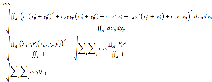

Still assuming that our wavefront is mostly described by third-order aberrations (which also means the system should be at focus so we have no influence of the bi terms), we can compute the rms as
where A is the aperture and the normalized Qi,j products can be precomputed for a circular aperture as
The rms can then be obtained by the sum of the weighted products of the ci. This (relatively) elegant concept therefore allows to evaluate an approximation of the Strehl ratio of a system by the simple knowledge of the ci coefficients. Note that the matrix is symmetric and is valid only for unobscured circular apertures. If the aperture is different, the table shall be recomputed. When using the two-rays approach described here-below to solve the ci, the value of y should be normalized by the maximum field angle (that is, y=0 for on-axis and y=1 for maximum off-axis).

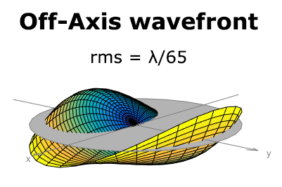

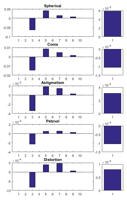

As an example, the long-working distance lenses bending of Figure 6 were optimized to produce close-to-zero seidel terms. The actual coefficients are given in Figure 7 and the predicted wavefront in Figure 8. All the results were validated against Zemax OpticsStudio and matches perfectly. Note however that the actual raytraced off-axis wavefront is λ/4 due to the higher-order aberrations that became non-negligible here. The cause is probably the 50 µm spherical aberration of the first element that is compensated mostly by the strong bending of the second lens. If these results were not satisfactory enough, the next design approach would probably be to swap the first lens by a doublet.
Figure 6 – Example system
Figure 7 – Experimental results (units in millimeters)
Figure 8 – Predicted off-axis wavefront for the system of Figure 6
