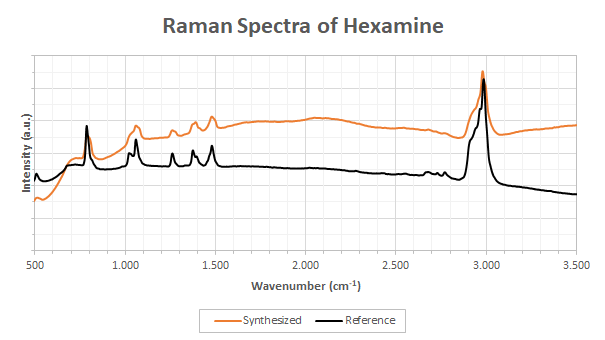

After performing the synthesis, I compared the crystals to a pure sample of methenamine obtained from a chemical supplier (99.9% pure). The two spectra, experimental and reference, are shown in Figure 2 and were taken using the OpenRAMAN Starter Edition. I still haven’t replaced the laser of the Performance Edition since I fried it and I therefore have to perform all the analysis using the Starter Edition which has a multimode laser leading to poorer resolution and doubling of the peaks. Nonetheless, the spectra shown here are a good example of what can be obtained using the entry level version of the spectrometer using the small 5 mW laser at 11 sec exposure (no baseline removal). It is therefore perfectly applicable by the amateur chemist.
Figure 2 – Raman spectra of methenamine
The results of Figure 2 tends to show that we are dealing with the same compound (synthesized vs. reference) but the synthesized methenamine has a broader fluorescence spectrum. This fluorescence background is actually the consequence of the impurities in the ethanol I used which is something I did not anticipated when performing the recrystallization.

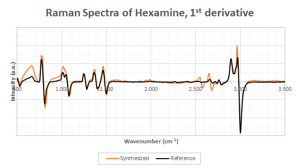

Let us look at the spectra in more details using a first order Savitzky-Gollay filtering. I already discussed the advantages of first order filtering in my post about esterification. The results are shown in Figure 3.
Figure 3 – Raman spectra of methenamine, 1st derivative
The peaks are clearly the same which confirms that the product synthesized is indeed methenamine. However, something interesting occurs in the region 2,500-3000 cm-1. First, there is clearly some extra peaks near 2,600 cm-1 but the peak at 3,000 cm-1 seems to be a bit stronger in the synthesized compound too. This means, without any doubts, that the synthesized product I’m analyzing is not as pure as the reference version. This may come from the impurities in the recrystallisation process although the crystals I analyzed were still a bit damp and I cannot exclude that not all the solvent evaporated when I performed the analysis.
Concerning the peak positions, we can exclude any contamination of C#N (triple bonds) as they would have appeared in the 2,000-2,300 cm-1 region which is empty in our spectra. The peaks near 1,000-1,500 cm-1 are most probably the C-N and CH2 bonds of methenamine. Although I do not have the N(R)3 peaks in my tables, NH2R occurs near 1,050 cm-1 and NHR2 near 1,150 cm-1. C-N are also expected to provide a signal near 900 cm-1. The peaks near 1,500 cm-1 are most probably due to CH2 bonds. As always, be aware that I have very little experience in peak identifications so do not take my words here for granted.
