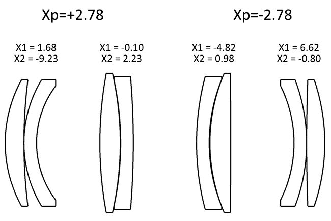

You may wonder what’s all this fuzz about partition ratios. The reason is best explained with an example.
Figure 1 shows four different doublets. They all have an equivalent focal length of 100 mm and are optimized to minimize chromatic aberration and to cancel both spherical aberration and coma (more on that later). The two first doublets (Xp=+2.78) have the first lens made of N-BK7 glass while the second glass is N-SF64. For the two lasts (Xp=-2.78), it is the opposite. It is exactly the kind of elements you want to use in your optical designs! Note that although the two sets seem to be mirror image but they are not as you can see with the individual lenses partition ratios (X1 and X2).
Figure 1 – Four optimized doublets of +10D each
The great potential of partition ratios is that they allow to separate the construction parameters from the correction of aberrations. When you change Xp, you don’t change the overall doublet power but you will affect more or less of this power to the front element. Similarly, when you change X1 and X2 you don’t modify the individual lens powers but only how much of that power is placed on the front surface. As we have seen in our previous post, X1 and X2 affects coma and spherical aberration. I haven’t touched about chromatic aberration yet but it is affected by Xp.
Changing the partition ratio allows you to smoothly affect aberration in a much less cumbersome way because you have only 3 parameters here to deal with (Xp, X1 and X2). Also, when increasing the distance L between the lenses, or the thickness T of each lens, the neat formula we have just set allows to keep the same bending ratio and overall power of the doublet without having to tune anything.
Once your mind has been freed of all the unnecessary things, you can focus on finding the values of Xp, X1 and X2 that will optimize the performance of your doublet. This however goes beyond the scope of this post but we will unravel the mystery one piece at a time!
