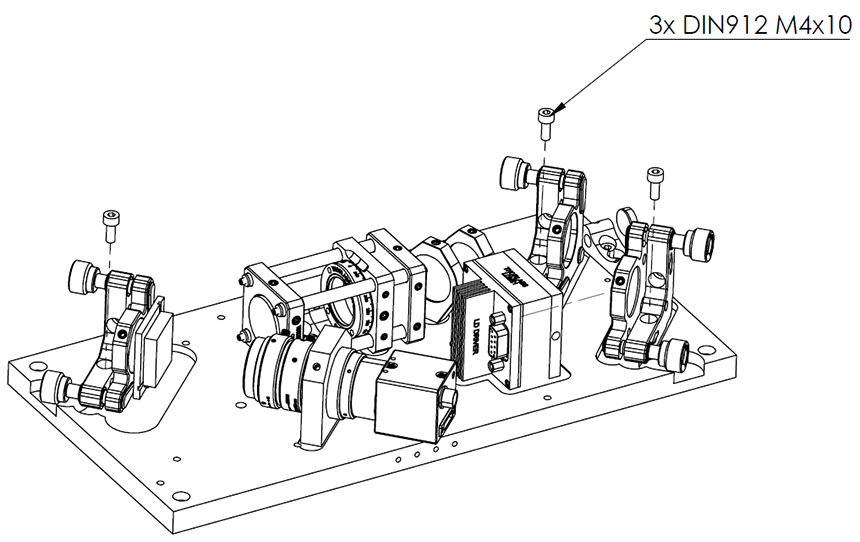

There are also three ways to think about an optical system, complex or not: (1) at the general architecture & specification level, (2) at the optical element level, and, (3) at the mechanical assembly level. For instance, when building the OpenRAMAN spectroscope, I first made an overall sketch of the system to determine all the important quantities (grating angles, focal length, slit size etc.), then I determined which optical design was able to give the expected resolution based on this architecture and, finally, I checked how the optical elements would be mounted together. An illustration of the output of all three steps is given in Figure 1.
Figure 1 – The three steps of optical system design
