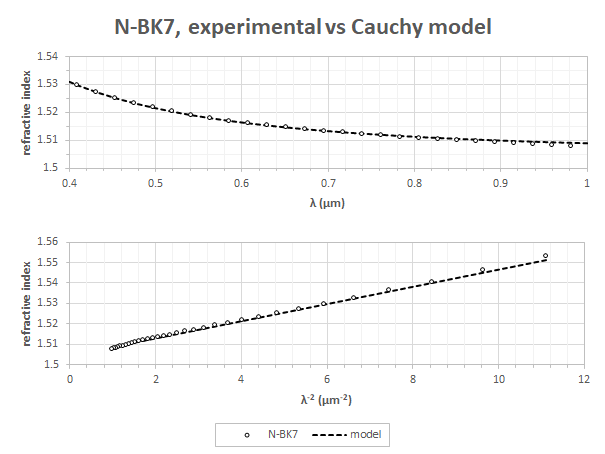

Very early optical researchers noted the dependence of the refractive index of a material with inverse squared wavelength and proposed an empirical relation known as the Cauchy formula
A typical glass will therefore have a λ-2 dependence, as shown in Figure 1. Note the linear dependance in the bottom plot. The agreement of experimental data for N-BK7 with the model between 0.4 µm and 0.75 µm (visible spectrum) is ∆nrms=0.0015 (0.1%).
Figure 1 – Dependance of a normal glass with wavelength

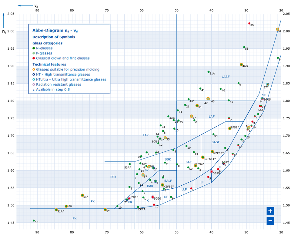

Figure 2 – Traditional glass chart (from Schott website https://www.schott.com/en-gb/special-selection-tools/interactive-abbe-diagram)
The method presented here-above is particular to this post. You will usually find a different approach in your classical textbooks that I will briefly discuss now to view things along different perspective.

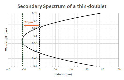

Although the power of the thin-doublet is equal at the auxiliary wavelengths λfand λc, it has a slightly different value at the design wavelength, λd. A typical power variation plot with wavelength is given in Figure 2. The difference in focus between the design wavelength and the auxiliary wavelengths is called the secondary spectrum. Note that the defocus varies by more than the reported secondary spectrum, even in the range defined by the auxiliary wavelengths [λf, λc].
Figure 3 – Secondary spectrum of a corrected thin-doublet

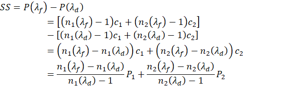

We can compute the value of the secondary spectrum as the power difference between the auxiliary and design wavelengths
and knowing that
we have

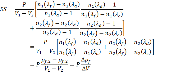

and, from the definition of the Abbe number,
we have the relation
where we introduced the partial dispersion measured at the f line, ρf, as
The secondary spectrum is therefore proportional to the difference in partial dispersion between the two glasses and inversely proportional to the difference in Abbe number between the two glasses. To reduce the secondary spectrum and increase the achromaticity of our thin-doublet, we must then select two glasses with similar partial dispersions but very dissimilar Abbe numbers.

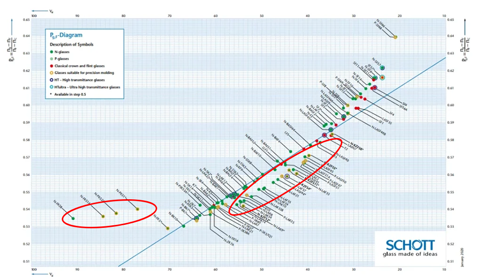

To assist the optical designer in this task, a new chart is introduced in Figure 4 to sort the glasses based on their partial dispersions and Abbe numbers. The goal is to select glasses that lies on a horizontal line (∆ρf≈0) but widely spaced apart (∆V≠0).
Figure 4 – Partial dispersion chart (annotated from Schott website)
We see that only a few glasses meet these criteria, and they are usually all expensive (highlighted in red in Figure 4). All other glasses lay very close to what is called the normal line which is directly linked to the concept of normal/abnormal dispersion glasses that we met previously. You will frequently hear the term ED glasses for “extra-low dispersion glasses” in marketing of telescope or camera objectives to emphasize the presence of an abnormal dispersion glass – usually leading to superior performances of the overall assembly in terms of achromaticity.

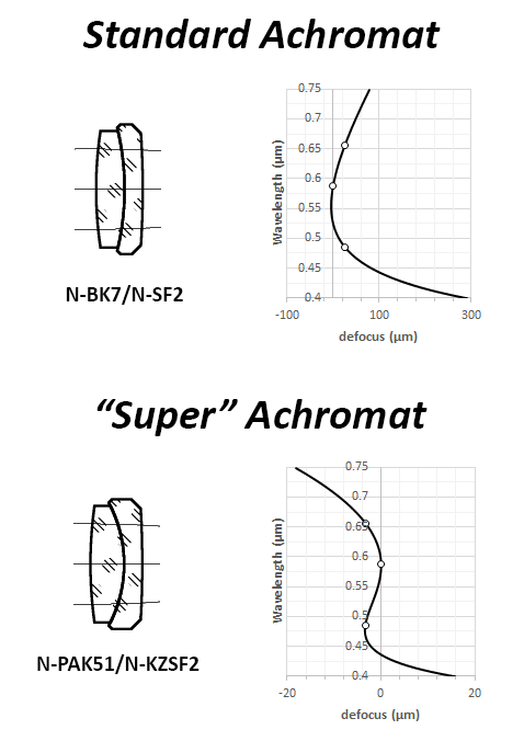

Historically, this favored telescopes with very long focal lengths (several meters) such as to be completely tolerant to secondary spectrum. For instance, a 100 mm aperture telescope with a standard achromat would require a focal length of at least 3 meters in the visible range! Things can be greatly improved by using glasses outside the normal line. Such achromats are usually referred to as super-achromats although the name is not standardized so you must be careful when it pops up at optics suppliers. An example of a f=50 mm super-achromat vs. standard achromat is given in Figure 5. The standard achromat uses the glasses along the normal line (N-BK7/N-SF2) while the super-achromat uses glasses outside of the normal line (N-PAK51/N-KZSF2). The secondary spectrum is decreased from 25 µm (standard achromat) to only 3 µm (super achromat).
Figure 5 – Standard vs super-achromat doublet

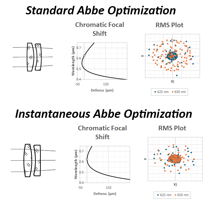

One of the advantages of these new formulas is that they guarantee that the wavelength dependency of the power near the design wavelength is minimal thanks to the zero first-order derivative and small second-order derivative. The resulting shape is therefore close to a parabola with its minimum located at λ0 and with very little curvature, i.e pretty insensitive to small changes in the working wavelength that might be due to current, temperature or batch-to-batch variations.
An example of a doublet lens optimized for desensitization at the laser wavelength is given in Figure 5. The bottom system is clearly optimized for minimum wavelength sensitivity near its design wavelength, λ0, at contrario to the top system which has more sensitivity (non-zero slope) at λ0 because it was built using the standard definition of the Abbe number. This can be seen in the RMS plot diagrams where the spread is quite different in the standard Abbe version compared to the instantaneous Abbe version which keeps the same spreading. Note the bending of the different lenses between the top and bottom solutions!
Figure 6 – desensitization of a laser system using instantaneous Abbe numbers

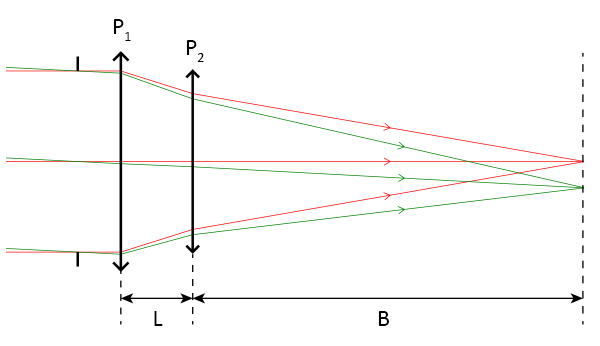

Until now, we focused the design process exclusively on thin-doublets but we know that these are theoretical objects only because real doublets will always have some thickness between their elements.
To illustrate this, I will consider the telescope system of Figure 6 made of a split doublet made of elements P1 and P2 with an aperture in front of it. The distance between the elements is noted L and the image is formed at some distance B from the second lens.
Figure 7 – A thick doublet achromatic telescope
The ABCD matrix of this system is
where the total power is now
Using P directly as a shorthand we have
Let’s have a look at what happens to a ray of height y and direction u traversing this system:
Since the topic of this post is about the chromatic behavior in optical systems, let’s study how the interception coordinate, y’, changes with wavelength:
Several interesting conclusions can be drawn from this mathematical expression.
First, for rays parallel to the optical axis (u=0), we find that the ray intercept at the image plane varies with wavelength by a quantity
The condition to get an achromatic system is therefore more complicated than simply cancelling the derivative of the power versus wavelength (dP/dλ). The true achromatic condition for this system is
from which we can solve the power partition ratio using the expression of the refractive indices like we did previously.
Note that when L=0, the thin-doublet case, the expression decays into dP/dλ=0 which is exactly what we solved in the first part of this post.
The second teaching that we get from our development is for off-axis rays (u≠0). If we assume the system is achromatic for on-axis rays (see here-above) we’re therefore left with
which cannot be zero unless dP2/dλ itself is zero which is not the case for a regular lens (or we wouldn’t be in the trouble of achromatizing anything).
In conclusion, a thick doublet system that is chromatically corrected for on-axis rays cannot be corrected at the same time for off-axis rays. We could build a thick doublet system that is achromatic (dy’/dλ=0) for a given (y,u) couple but we cannot build one that would satisfy the achromatic condition for all (y,u) couples. This is the limitation of doublet systems. The solution to this problem is to add more lenses, at the very least one more.

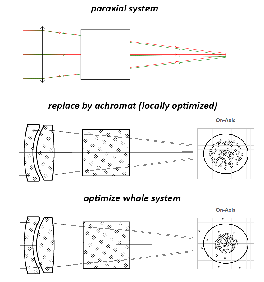

As for third-order aberrations, there is no generic formula to solve all the optical systems at once but there are well-known solutions to specific problems. And just like we can use thinlenses as an approximate starting point for real systems, we can use thin-doublets as a starting point to achromatization.
Let’s illustrate this with the example of Figure 7 showing an achromatic telescope system with a beamsplitter cube and its on-axis rms performance plot. On top, you have the equivalent paraxial system. At the middle, we replace the paraxial lens by an achromatic doublet optimized for spherical aberration (S1), coma (S2), and longitudinal chromatic aberrations (C1), ignoring the presence of the cube. Then, at the bottom, we optimize the whole system for best rms performance. The adjustments here are minor because of the limited aperture size but in faster systems the modifications would have been more important. This emphasizes that approximations can yield could results in systems that aren’t too fast.
Figure 8 – Achromat telescope with beamsplitter cube optimization process
The optimization process used to generate thick elements from thin ones or to optimize the whole system globally goes beyond the scope of this post and will be covered later. The only important point to consider is that we can first optimize elements locally (ignoring the other elements of the system) to generate an approximate solution before we optimize the whole system at once. For systems that aren’t too fast, the approximate solution can fall very close to the fully optimized one.
