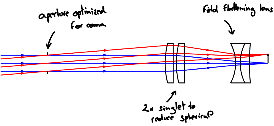

The final design of the objective is shown in Figure 1.
Figure 1 – Final design
The strongest source of aberration comes from the spherical of the high-power lens. To have a magnification effect, the effective focal length of the objective should be short. Using a 200 mm tube lens (one of the standard for microscopes), a 5x magnification requires to have a 35 mm equivalent focal length. With such short focal lengths, we quickly get spherical aberration if we use only one lens. By splitting the power over two identical 50 mm lens (Thorlabs LA1213-A) we almost cancel completely the spherical aberrations.
However, two lenses of 50 mm make something that is between 25 and 30 mm focal length depending on the spacing between the two lenses but, here, I said that the effective focal length was 35 mm. This is because the two lenses used alone have plenty of field curvature as demonstrated in the video. To compensate the field curvature, a 20 mm focal length negative element (Thorlabs ACN127-020-A) is inserted in the optical train. This negative lens will cancel the field curvature independently of its position relative to the other lenses, but it will also reduce the power of the system. The only way to limit the power reduction is to place the lens very close to the object plane. By leaving about 6 mm between the object and the lens, we decrease the objective equivalent focal length to 35 mm.
Choosing the correct lens to compensate for the field curvature is a tricky task because each lens will correct more or less the field curvature depending on its refraction index and the radii of its interfaces. It is a bit like a trial and error process and you should test several negative lenses to see how they perform. If you cannot find a good match, you have to replace one or two of the other lenses and retry all your negative lenses to see if you get a better match.
Once you have reduced the spherical and field curvature, you can try to optimize the position of the aperture to reduce coma. For infinity-corrected microscope objective, the aperture is usually placed at the back of the objective (opposite to the object side) and for finite conjugate objectives or relay system it is better to try to build a symmetric system with the aperture placed at the centre. The fact that you place the aperture at the back side of the microscopy objective in infinity-corrected system is not surprising because you have to consider the microscope setup as a whole including the tube lens. Indeed, the objective-tube lens system makes a finite conjugate system and we know that finite conjugate system must be designed as symmetric with the aperture at the centre. By placing the aperture at the back of the microscopy objective, it split the objective-tube lens in two almost-symmetric part (conceptually). To achieve the best performances, you can build your microscopy setup as a 4f system then.
Finally, the last part is to tune slightly the objective aperture diameter and field dimensions until your objective performances becomes diffraction-limited. If you notice bad-on axis performances, try to reduce the aperture diameter first. If you notice bad off-axis performances, try to reduce the field dimensions. This is how I settled the properties of the custom objective here to 0.07 NA and field number 25. 0.07 NA is a bit short for commercial microscopy objective which are move in the 0.10 NA range for that magnification but that was the best I managed to get with stock elements without complexifying the setup even more. On the other side, a field number of 25 is very good when compared to commercial objectives. On the price range, it is a bit cheaper than the Olympus 4x Plan although the latter is achromatic and offers a little bit more resolution.

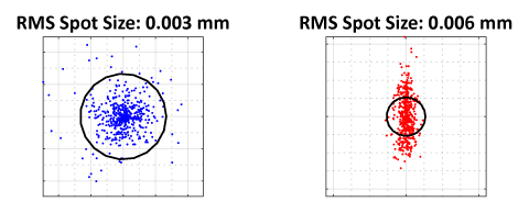

Let’s start with spot diagrams.
The idea behind spot diagrams is purely geometric. We take a bunch of rays that passes through the lenses at different positions, apply the refraction laws at the various air-glass interfaces using raytracing techniques and look at where the rays intercept the image plane. If the system was perfect, all the red rays of Figure 1 would merge to the same point and all the blues rays should merge to another point. In practice, it is never the case and we get a distribution of positions. This means that, depending on the travel path of the ray through the optical system, we get slightly different ending position. Because the image of a point is not a point anymore, the image becomes blurry. The amount of blur will depend on the distribution spread of the spot, hence the name spot diagram.
Spot diagrams are often represented for on axis source (blue rays in Figure 1) and off-axis rays (red rays in Figure 1) for 70% and 100% maximum field. A circle is usually drawn on top of the spot diagrams to represent the diffraction-limited performances of the system. Remember that because we use a purely geometrical technique, we ignore the effect of diffraction when we render the spot diagrams and in the real world you can never beat the diffraction limit. The setup will be diffraction-limited when all (or almost all) the points will lay inside the diffraction limit circle.
The rays of Figure 1 have the spot diagrams of Figure 2 for a gaussian source of 625 nm with 18 nm FWHM (typical for a red LED illumination). We see that the on-axis performances are diffraction limited and that the off-axis performances (at 2.5 mm field) are slightly above diffraction limit and suffer a little bit of astigmatism, another type of aberration that was not discussed in the video and which originates in a slightly different focal length in the transverse direction.
Figure 2 – Spot Diagram of Figure 1
Working with spot diagram is usually the first thing to look at when designing optical systems because it gives you indication on the type of aberrations you are facing. Large spreads for on-axis rays indicates spherical aberration or defocus for instance and cone-shaped distribution for off-axis rays are typical of coma aberrations.
When we look at the spot diagram of Figure 2, we clearly see that the resolution limit will be about 3 µm (neglecting diffraction effects) on axis because two points lying closer than 3 µm will have spot diagrams that will start to merge together in a common distribution shape. Off-axis, things are a bit more contrasted because the resolution will differ depending on whatever the points will be placed next to each other horizontally or vertically. Clearly, the horizontal separation power will be better than the vertical separation power.

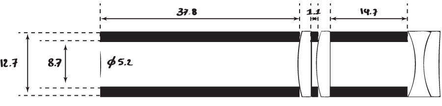

Here, we will build the objective using the most basic lens mounting techniques: spacer tubes.
Spacers tubes are just regular tubes but with carefully controlled dimensions and, eventually, with some extra features to prevent it from having specular reflection. Also, the ends of the tubes are barely chamfered such that they press square on the lenses. When the edge of the tube contacts a spherical lens, it will push on the lens surface such that they auto-centre to correct offset and tilt. This technology is the most straightforward lens mounting technique and it can give you a 0.1 mm centring accuracy typically.
The spacers for the objective are shown in Figure 5. I would strongly suggest you to produce the spacers using a lathe from POM (acetal) plastic but if you do not own one, I have added .stl files at the end of the post so that you can print the spacers using a 3D printer. If you do so, I would advise to dip the spacers in a thick black matte paint to prevent reflections if using FDM printing method or that the model produces dust on the optics if you used SLS printing method.
Figure 5 – Spacers used to align the lenses

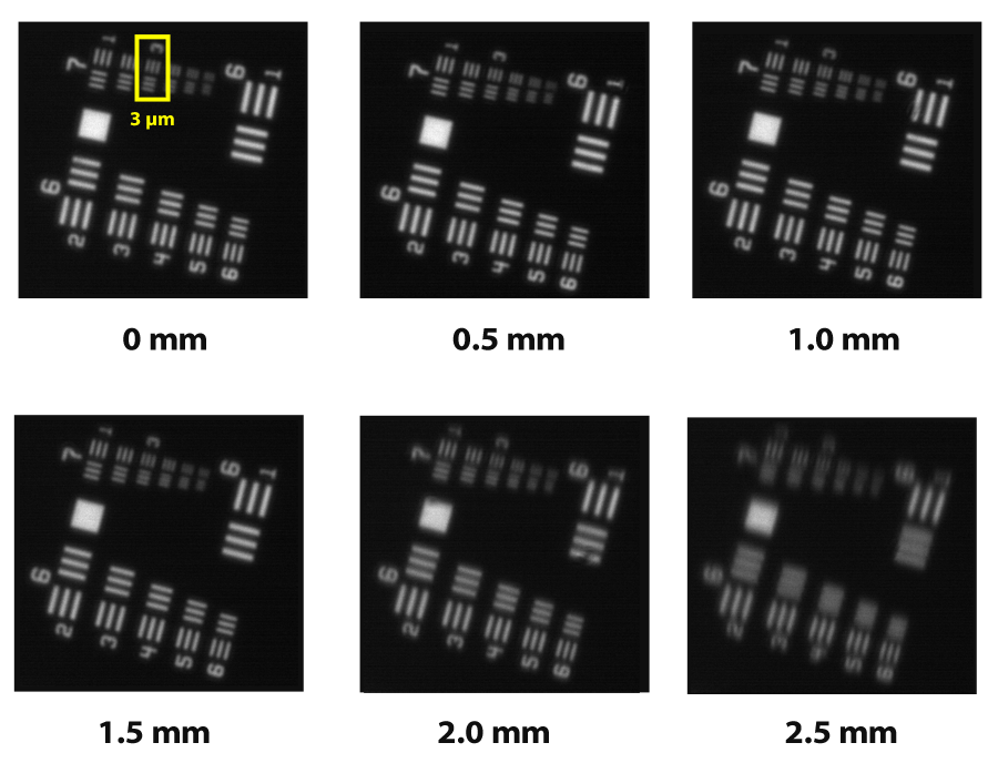

Finally, I have tested the performances of the objective on an actual USAF 1951 resolution test target from the centre of the field of view and up to the edge (2.5 mm off-centre) to assess the performances. Please have a look at the video for a description of the test setup.
The results are shown in Figure 6 for different field position. The yellow square is the 3 µm features that we expect the objective to resolve from the simulations.
Figure 6 - Results on an USAF 1951 resolution test target at different field position
We see that the objective performs exactly like in the simulations with the 3 µm bars clearly defined on-axis and almost defined off-axis. Moreover, we see that the bars can be resolved in one direction but not the other in the off-axis image which confirms the astigmatism predicted by the simulation software. Full performances were measured up to 1.5 mm off-centre.
Considering the nature of the elements (stock lenses) and the mounting used, these performances are very good. The objective does not perform as good as a commercial one in terms of numerical aperture and chromatism, but it definitively shows that it is possible to build successful optical design setups using simple mounting techniques and off-the-shelve lenses.
