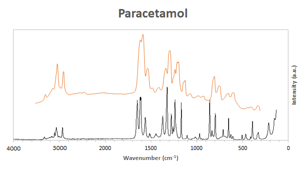

All the data have been acquired using the Starter Edition. I unfortunately fried my laser of the Performance Edition and I don’t have the money right now to replace it… Also, I spotted some extra peaks in some spectra (e.g. paracetamol) which I cannot explain yet. I am conducting additional experiments to understand where this effect is coming from as it may reduce the spectral resolution.

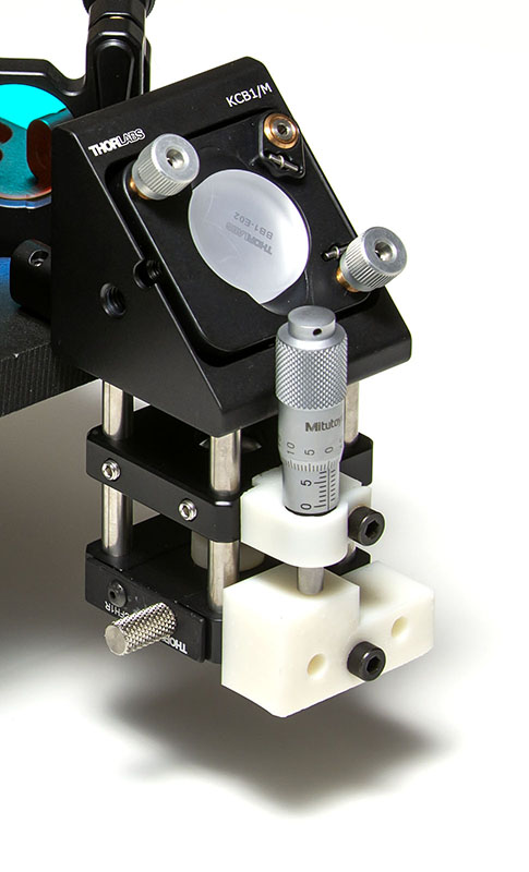

A picture of the device required to measure solid samples is given in Figure 1. It consists of a right-angle mirror with adjustable orientation, a 19 mm doublet achromat to focalize the beam on the sample, a tray to place the sample on and a micrometre adjuster for adjust the focus on the sample surface.
Figure 1 – Experimental device

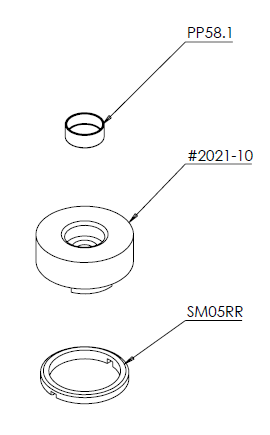

The powder samples are placed in a small aluminium cup that can be bought from ChemLab Analytical (ex-Fiers if you are familiar with our standard suppliers). These cups are solid by 250 pcs and are guaranteed to have no residue that could contaminate your sample. The cup itself is hold in a 3D holder which can be machined as well in plastic like POM. The holder is mounted on Thorlabs tray using a glued SM05RR retainer ring. The cups shall ideally be replaced for every measurement although, like for the test tubes in the liquid device, you can reuse them about 10 times or so if you don’t mind a bit of contamination. The 3D holder itself can be used many more times as, in theory, it never comes in contact with the chemicals. In practice I see that it tends to stain and should also be replaced at the occasion. A schematic of the holder is shown in Figure 2.

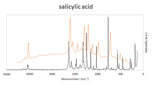

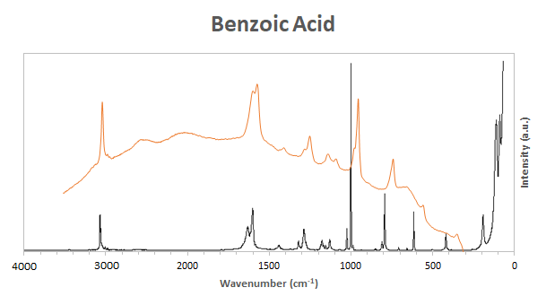

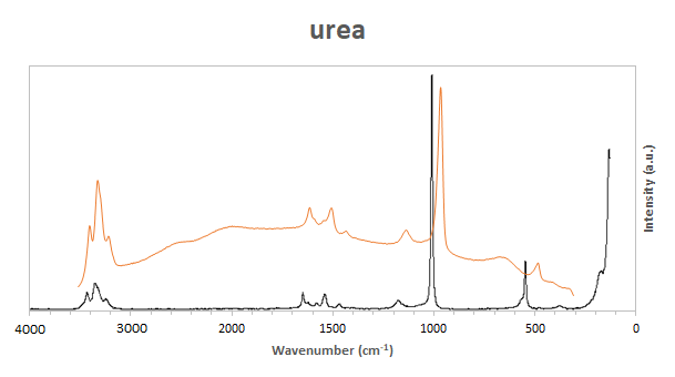

Among these, I was able to correlate four of them with the SDBS database : benzoic acid, paracetamol, salicylic acid and urea. The spectra are given in Figure 3 to Figure 6.
Figure 3 – Benzoic acid (orange: OpenRAMAN, black: SDBS database)
Figure 4 – Paracetamol (orange: OpenRAMAN, black: SDBS database)
Figure 5 – Salicylic acid (orange: OpenRAMAN, black: SDBS database)
Figure 6 – Urea (orange: OpenRAMAN, black: SDBS database)
Generally speaking, we observe a slight shift of the wavenumbers of about 50 cm-1 which can be explained by an incorrect laser frequency or an invalid wavelength calibration. Also, no baseline removal was performed. All the large peaks were identified and most of the medium/small peaks could be observed as well. The resolution of the Starter Edition is not sufficient to discriminate all nearby peaks however.

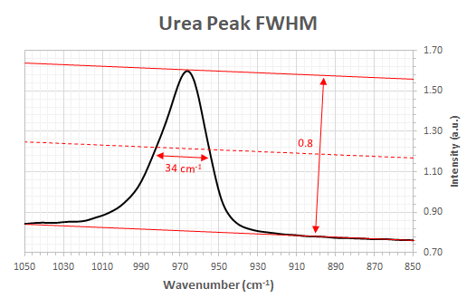

Concerning the resolution, I was able to evaluate it to 34 cm-1 using the narrow 1000 cm-1 peaks of urea, as shown in Figure 7. This is the very same resolution that was obtained with the nitrobenzene peak around the same wavelength with the liquid cuvette. This is also confirmed by the data of Figure 3 as we can detect the two peaks at 1604 and 1634 cm-1. After subtracting a linear baseline from the 850-910 cm-1 region, the signal to noise ratio of the peak in Figure 7 was evaluated to 730:1 (single acquisition – no averaging). I did not keep track of the exposure time used but I believe it was about 5 seconds here.
Figure 7 – FWHM from urea peak at 1000 cm-1

Some peaks are doubled – or even tripled! I have no idea where this is coming from as it does not happen with all peaks. I will investigate both the laser for multiple modes and eventual reflections in the system. I cannot exclude that this may be coming from the sample itself because I essentially noticed it with paracetamol which was coming from painkiller pill. All others chemicals used were certified chemicals and I don’t notice anything suspicious in their spectra based on Figure 3 to Figure 6.
The mechanics itself is not 100% as I would like it to be. In my device, the lens cage is not sliding smoothly on the rods due to a slight bending introduced by incorrect tolerance in the right-angle mirror. As a result, the micrometre driver itself is not enough and you have to use force of your fingers to move the cage plate. I don’t know if all right-angle mirror holder have the same problem or if it just mine but you may need to enlarge slightly the holes of the lens cage plate to let it move more freely. Don’t overbore them because it might also block if tilted! Maybe some bushing might be required… but then I would replace the whole cage plate by a custom 3D part as well.
