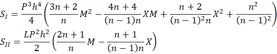

The Handbook of Optical Systems, Volume 3: Aberration Theory and Correction of Optical Systems gives formula for them based on the partition ratio, X, and the marginal ray intercept height, h. They are
with the magnification number, M,
and the thin-lens partition ratio, X,
where u’ and u are the marginal ray angles after and before the lens and c1 and c2 are the front and rear curvature of the lens respectively.
It is worth analyzing a bit the formula for spherical aberration and coma.
In the case of coma, we see that there is always a bending of the lens that will cancel it:
which is around X1 for a glass with n1.5 and M=1 (collimated beam).

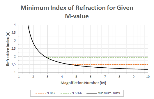

A solution to the problem S1=0 exists only when
Figure 1 shows how to select a glass for a given M value through its index of refraction. The plot gives the minimum index of refraction to use for a given magnification number, M, and also displays N-BK7 and N-SF66 glasses. Only the values to the right of the black curves allows zero spherical aberration.
Figure 1 – required index of refraction for given M value
N-SF66 is the Schott glass with the highest refractive index in the visible and can only achieve a solution for M>3. N-BK7 is a very common glass and only achieve a solution for M>4,5. No known glasses can produce zero spherical aberration for collimated beams (M=±1). Even Germanium in the infrared with its index of n=4 can only reach a solution for M>1,6.
