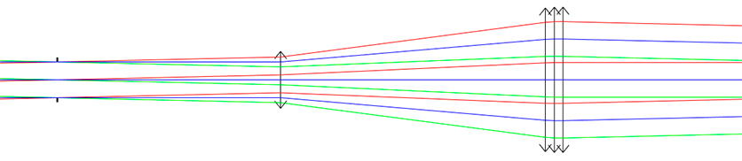

The paraxial lens system is shown in Figure 1 and consists of 4 thin-lenses. It was designed for an equivalent focal length of 131.25 mm, a projection distance of 300 mm, a numerical aperture of 0.02 and a field of slightly more than ±1° (6 mm image disk). Furthermore, the design is telecentric such that rays reach the image plane perpendicularly for all field position. Since the design is rather compact compared to the 300 mm back-focal distance, I cropped Figure 1 to the lenses system region only and do not show the image plane.
Figure 1 – Thin-lenses system for a long-working distance telecentric projector

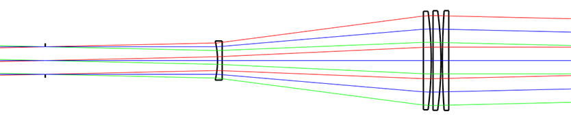

A real-lenses system was computed based on the prescription data of the thin-lenses and is shown in Figure 2. All the lenses are singlet lenses made of N-BK7 and have a minimum edge thickness and center thickness of 1 mm for manufacturability purposes.
Figure 2 – Real-lenses system for the long-working distance telecentric projector

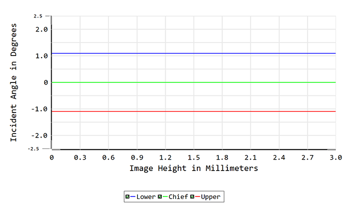

The design was confirmed to be telecentric, as can be seen in Figure 3. The mean angle (chief ray) is zero for all field positions.
Figure 3 – Angles of interception for image height

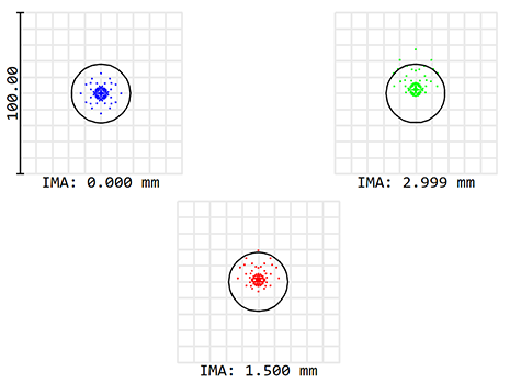

A spot diagram in Figure 4 shows that the system should be very close to diffraction-limit. The complexity of the system of Figure 1 is therefore justified in relation to its prescriptions (STOP size and maximum field). The system is actually limited here by spherical aberration in the negative element on the left hand-side of Figure 2. If we had to increase the size of the field or STOP we should split this lens into two or more to keep diffraction-limited performances.
Figure 4 – Spot diagram

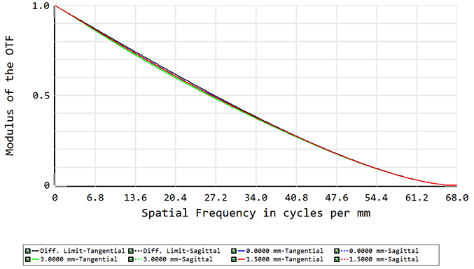

The quality of the system is furthermore confirmed by the MTF as shown in Figure 5. Details down to 20-25 µm should be visible on the full projection area (6 mm image disk).
Figure 5 – MTF

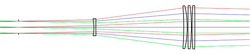

As an example, using just one click in the Matlab program to restrict X to be either -1, 0 or +1 we can restrict the design to stock elements (provided individual focal lengths can be found as stock), such as shown in Figure 6. This can dramatically reduce the cost of the system since every custom lens that needs to be manufactured as a NRE tooling cost associated. Typical price of all the lenses of Figure 2 (for a single system) is about 400€ + 1,200€ tooling cost whereas the system of Figure 6 could be typically obtained for less than 250€. Production costs of higher quantities of the custom system will usually drop very fast and it is not uncommon to pay almost the same price for 1, 5 or 10 systems!
Figure 6 – Design of Figure 1 restricted to stock elements
