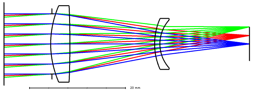

An example system using an asphere and a singlet element is given in Figure 1. I called it the perfect dialyte due to the beauty of the equations symmetry and the fact that it can produce perfectly focused images provided the two lenses are aplanatic. I’m certainly not the first to come across these equations, but in none of my optical design textbooks did I ever met a description of such system. Tell me if you have literature references of an equivalent system!

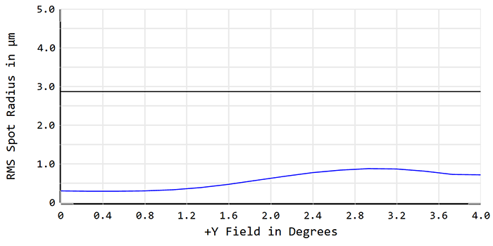

The system is diffraction-limited at f/4, 8° total FOV (4° half-FOV) as can be seen in Figure 2. I haven’t presented this kind of figure yet but it shows in blue the RMS spot size as a function of field angle. The black-line represents the radius of the Airy disk such that the system is diffraction-limited if the blue line is well below. Note that the system can be slightly extended, either up to 10° FOV or by opening the aperture a touch but higher-order aberrations quickly degrade the system performances.

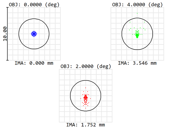

A traditional spot diagram is shown in Figure 3 for three different field angles. We already see some higher-order aberrations in off-axis rays although the system is still diffraction-limited. Note that the worst result is not obtained at the maximum field angle but at some lower value, close to 3°, which is typical of zonal aberrations (more on that later). This is where Figure 2 brings-in important information that you may have skipped in your traditional spot diagram.

Note that the system of Figure 1 is only one member of my perfect dialyte family. Here, the distance L between the two lenses was fixed because I wanted to use a singlet as second aplanatic lens. If we had used a different type of aplanatic lens, for instance a second aspheric lens, we could have chosen any value for L.
