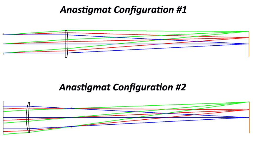

The first solution is a plano-convex lens with the plano side oriented towards infinity and the second is a meniscus lens.
To compute the position of the stop, we first need to compute the values of Q using our former formula to cancel coma
We find
which we convert to a distance d using the chief ray slope θ
using the fact that (by definition)
Conversely, we find
The two solutions are given in Figure 1.
Figure 1 – Anastigmat singlet configurations for a collimated beam
If you are a bit in the optical engineering world, the top solution (plano-convex) should trigger your attention: the lens is placed “with the wrong orientation”! All junior optical engineers know that plano-convexes lenses shall always be oriented with the curvy side towards infinity to minimize aberrations! In fact, this is even a question that my employer used to ask during job interviews. At that time, like most people, I answered like the textbooks: curvy side forward! And now I’m telling you to do the exact opposite.

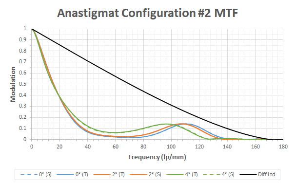

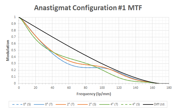

This is confirmed by a MTF analysis. The results are displayed in Figure 2 and Figure 3 for the plano-convex configuration and meniscus configuration respectively. MTFs are given for a 4° maximum field-angle and a speed of f/10.
Figure 2 – MTF of the plano-convex configuration
Figure 3 – MTF of the meniscus configuration

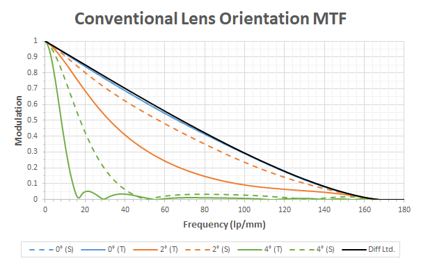

As a comparison, the MTF of the same plano-convex lens but with the conventional orientation (on-axis configuration) is given in Figure 4. The STOP position was optimized for coma as well.
Figure 4 – MTF of the plano-convex configuration with the conventional orientation
As expected, the first configuration yields an overall better MTF due to its reduced spherical aberration compared to the second one. We can also see that the conventional lens orientation offers a very good on-axis performance but quite poor off-axis ones at contrario to our off-axis optimized configurations. One important aspect here corresponds to the amount of astigmatism in the various MTF plots. Indeed, our two anastigmat configurations show no (or very little) astigmatism while the conventional lens orientation has plenty of it (as can be seen in the separation between the S and T curves). Also, both configurations show very consistent image quality throughout field which is, again, not the case of the conventional orientation.
