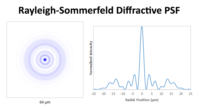

The point spread function can be seen as the impulse response of the optical system. It shows how an infinitely small source point (eventually in the form of a collimated beam) is spread on the detector surface. An example of PSF is given in Figure 1 with the full image on the left and a cross section on the right. The amplitude of the plot does not really matter and different normalization rules are often applied such as normalizing by the integral of either the plot or the cross section. You can review the various normalization methods in our previous post.
Figure 1 – Example of Point Spread Function (PSF)

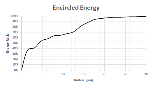

Just like we computed the rms value of the geometrical spot size, we can extract information from the PSF of Figure 1 through simple mathematical operations. We can compute the rms of the PSF but in practice this is rarely done. Most optical design softwares rather rely on the concept of encircled energy which is the ratio of the energy (integral of PSF) within a given disk to the total energy of the PSF. A tighter PSF (sharper spot size) will have the same energy contained in a smaller disk than a broader PSF coming from a poorer design. Similarly, the encircled energy of a sharp PSF at a given disk size will be higher than the encircled energy at that same disk size for the poorer design.
There are then two ways to address the encircled energy quantification. Either you give the energy ratio at a given disk size or you given the disk radius that contains a given amount of energy ratio. The exact amount of energy ratio is up to you and can be 50%, 67%, 90%, 95% etc.
The encircled energy plot of the PSF of Figure 1 is given in Figure 2. It reaches 50% at 4.3 µm, 67% at 10.6 µm and 95% at 18.0 µm. Mathematically, it was obtained by discrete integration of the cross section of Figure 1.

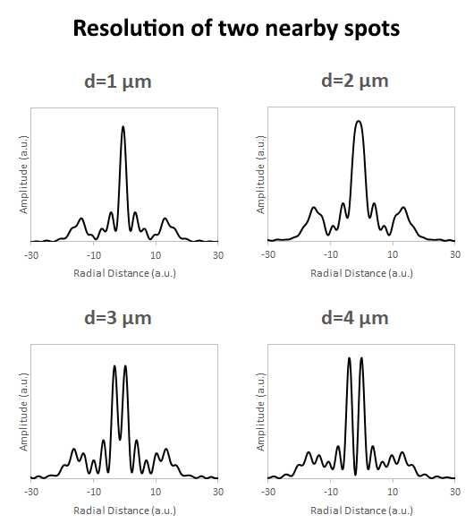

The usual though experiment to address resolution power consists of placing two nearby light-emitting spots and watch at which separation distance we can observe two peaks on the detector. The results for the PSF of Figure 1 is shown in Figure 3 for distances of 1 µm, 2 µm, 3 µm and 4 µm.
Figure 3 – Resolution plots for various separation distances
We can see that the two peaks start resolving at 3 µm and we can therefore say that the resolution power of the system is about 3 µm. The exact value depends on how you define the term resolve. Some people will be looking a complete separation, some other will be looking at 20% dip and some other will say it is when a dip just start forming but you don’t see it yet (this corresponds to cancelling of the second derivative).

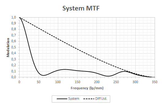

Mathematically, the MTF is obtained as the modulus of the Fourier transform of the PSF and is normalized such that MTF(0) = 1. The MTF of the PSF of Figure 1 is given in Figure 4.
Figure 4 – MTF of the PSF of Figure 1
It is customary to include the MTF of the corresponding diffraction limited system as well in the results because it gives an indication on the effects of aberrations on imaging transfer properties. Once again however, these plots contain a lot of information and we need some ways to extract a single number from them. Resolution is then often described as the frequency at which the contrast drops below a given amount, usually 30%. In Figure 4 this corresponds to 34 lp/mm which represents features of 29 µm. One other important quantity is the frequency at which the MTF drops to zero for all succeeding frequencies and is called the cut-off frequency of the system. Whereas it is still possible to observe features smaller than 29 µm in Figure 4 despite they will be very dim, it is impossible to observe any details above the cut-off frequency since they will have zero modulation, that is they don’t transfer through the system.
The exact value you use to characterize your system is up to you (50% modulation, 30% modulation, cut-off…) but in all cases you need to specify the criterion you selected as you present your resolution figures. Giving cut-off will obviously yield a very high resolution but users will usually find it dishonest because they will, by definition, never observe any features which would actually have that size. On the other hand, selecting a modulation drop too restrictive (like 50% modulation) will give you lower resolution figures and will make your system looks worse than your competitors even if you achieve the same resolution as they do. It can also make the life of the users more difficult when they have to compare datasheets that all have different criterions to express resolution.

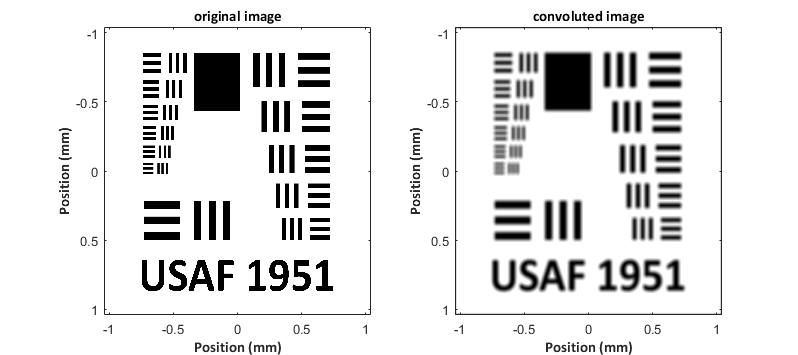

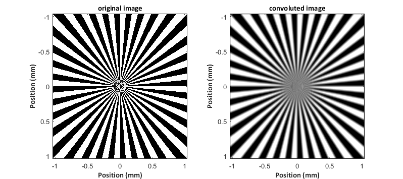

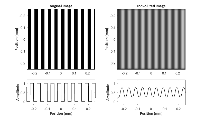

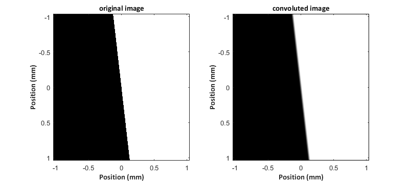

Experimentally speaking, you will find several resolution test targets available at optical suppliers like Thorlabs. I have generated simulations of the most important ones including Ronchi targets (Figure 5) which are the famous black/transparent stripes, the USAF 1951 target (Figure 6) which is widely use to evaluate a system resolution, the slanted edge target (Figure 7) which can be used to derive the full MTF of the system and the Siemens/star target (Figure 7) which is, to my experience, the least used of the list here. All the images were obtained by convolution with the system PSF of Figure 1. You can observe the drop of modulation/contrast in the cross-sections of Figure 5.
Figure 5 – Ronchi target
Figure 6 – USAF 1951 target
Figure 7 – Slanted edge target
Figure 8 – Siemens target
