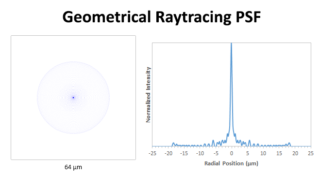

If we take the RMS spot diagram of last post and accumulate the rays to a bitmap placed on the image plane, we obtain the impulse response of the system which is called in optics the Point Spread Function (PSF). It shows how a single source point is spread as it transfer through the system.
If we would apply a PSF based on purely geometrical approach for the on-axis field of Figure 1 (blue rays), we would obtain the results of Figure 2. The 2D image of the PSF is given on the left hand-side while the transversal cut is shown on the right hand-side of the figure. PSF are always normalized before being displayed so the intensity of the plot does not matter at this time of the analysis but we will come back later on this.
Figure 2 – Geometrical PSF

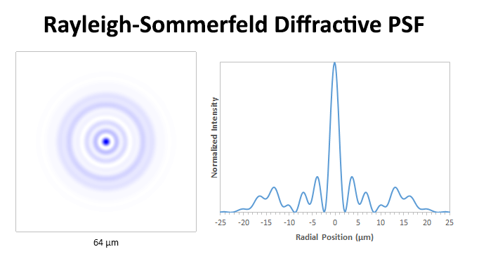

If you had to measure the PSF of the real system however, you would be likely to measure something much closer to Figure 3.
Figure 3 – Rayleigh-Sommerfeld Diffractive PSF
The results of Figure 3 includes the effects of diffraction and requires a bit more computation than the simple geometrical raytracing used for Figure 2. Note how the diffractive PSF displays some annular patterns which are clearly not predicted by the geometrical raytracing alone. The PSF itself also appears much broader which will result in a lower image resolution at the end.

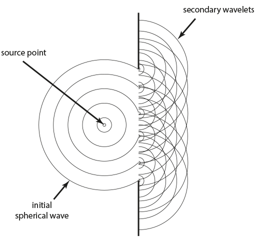

In the early Huygens model, light propagates through space as waves (just like sound would do). Each point source of light would emit spherical waves and the surface of these spherical wavelets could be seen as secondary source of spherical waves themselves. As the spherical wave of the source point would hit an aperture, some of the secondary sources would be blocked while other would passes through as represented in Figure 4.
Figure 4 – Huygens model of point source with aperture
As a consequence of Figure 4, some of the light would extend to regions that do not follow rectilinear path from the source through the edge of the aperture, giving a qualitative explanation of what is actually observed when light traverses apertures. It however lack a quantitative approach for which we need to move to the work of Fresnel and its successors. Since these models can be relatively complex and requires using mathematical tools that I haven’t used since I was a student (like Green functions), I will stick here to a soft approach.

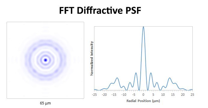

The PSF of the system of Figure 1 was computed using the FFT method and the results are shown in Figure 5. The results are here very close to the one of Figure 4. The ripples in the 2D profile is due to a low sampling of the pupil but it is possible to improve on this by using larger maps when computing the Fourier Transform.
Figure 5 – FFT Diffractive PSF
