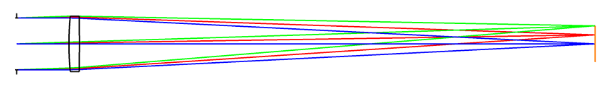

An example lens is given in Figure 1. It features a 10D lens optimized for no spherical aberration and no coma at 587 nm over a field of 2° for an aperture of 10 mm.
Figure 1 – Aspheric lens corrected for coma and spherical aberration

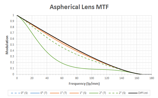

The MTF is given in Figure 2. As it can be expected by the remaining astigmatism and petzval, the performances are only good on-axis. At 2° a large drop can already be observed due to the strong field curvature of that lens. The performances are however diffraction-limited up to 1°. The off-axis aspect will be fixed in a later post, no need to rush for now.
Figure 2 – MTF of the lens of Figure 1
