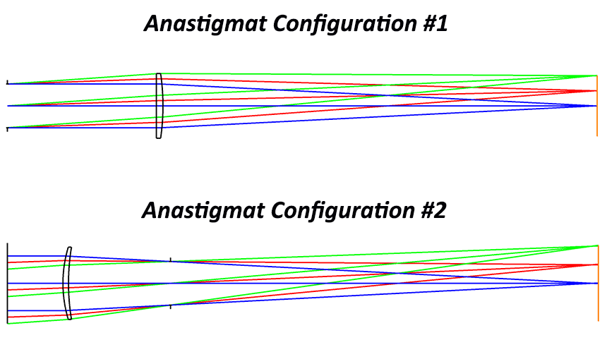

As a reminder, the two anastigmat, acomatic, lens systems we previously derived are repeated in Figure 1. They both show no coma (S2=0) and no astigmatism (S3=0) when some lens shape is respected and the stop is placed at a specific position relative to the lens.
Figure 1 – Anastigmat, acomatic lens systems

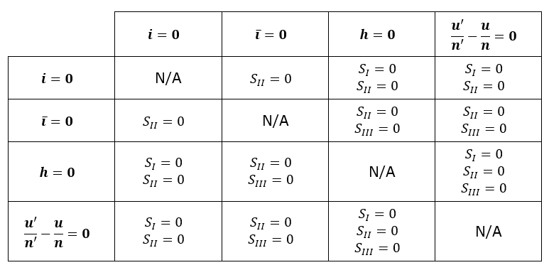

By combining the various cases of Figure 2 for both interfaces to make a singlet lens, we can therefore produce an element that has reduced aberrations. Limiting ourselves to the three first aberrations, we can produce lenses that have either (1) no coma, (2) no spherical and no coma, (3) no coma and no astigmatism, (4) no spherical, no coma and no astigmatism. The various combinations are listed in Figure 3. Note that some combinations are technically infeasible or meaningless (those on the diagonal).
Figure 3 – Table of possible patterns for a singlet lens element

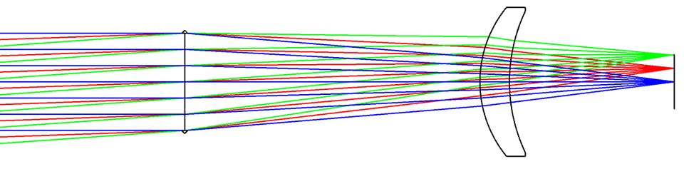

An example of convergent aplanatic lens is given in Figure 4. I placed a paraxial lens in Zemax to produce perfect focusing, so don’t pay attention to the leftmost element on the figure.
Figure 4 – Convergent aplanatic lens
In the convergent aplanatic case we have the radii of curvatures
with T the lens thickness and n its refractive index.
We can compute the equivalent focal length, f, of the lens as
which simplifies to the following expression for thinlenses (T=0)
To create a lens of given power P=1/f, the two here-above formula allow to compute at which distance z from the paraxial focus position of the system you need to place the lens. You can then compute the corresponding radii of curvatures.

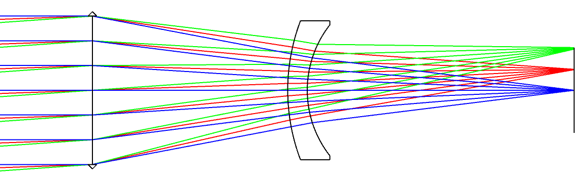

The divergent case is treated similarly. An example is given in Figure 5.
Figure 5 – Divergent aplanatic lens
The radii of curvatures are this time
and the equivalent focal length
