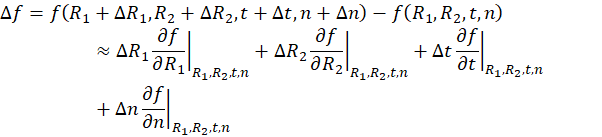

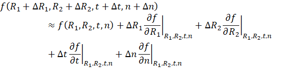

Imagine you have an analytical formula that tells you what is the focal length of a system composed of a single lens knowing its parameters R1, R2, t and n. From a Taylor expansion limited to the first order you also expect that the function will be linear for very small deviations to the nominal values
where the partial derivatives ∂f/∂… are computed around the nominal values R1, R2, t and n.
That is, the focal length of the system perturbated by the values ∆R1, ∆R2, ∆t and ∆n can be computed from the nominal focal length plus terms that depend on both the partial derivatives of the analytical formula and the perturbations value.
The error in focal length is therefore given by the deviation to the nominal value

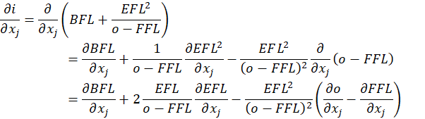

Any other property based on the ABCD matrix can be computed as well. For instance the paraxial focus image position is
and therefore
You can directly reuse the derivative of EFL, BFL and FFL computed here-above. By the way, the sets of xj can also include the value of o which is also a system parameter! Including it or not is merely a question of what you are trying to compute at the end. If the object (e.g. a target) is included in the mechanics and have a fixed position with some uncertainty, you might be interested to see by how much the image plane shift. On the other hand, if you can freely adjust the object position to get a sharp image then you can throw away any variations of o as they don’t make sense in that case (∂f/∂o=0).

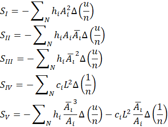

Although you can develop the analytical expression of ∂M/∂xj for simple systems, you will soon struggle as the complexity increases. This applies not only to complex systems but also to more complex quantities. For instance, in our previous post we have shown how to approximate the wavefront through the third-order aberration theory and Seidel formula:
with the Seidel terms summed over the N interfaces of the system
where
and (h,u), (h,u) are the marginal and chief ray height and angles respectively, which can be obtained from the Mi matrices.

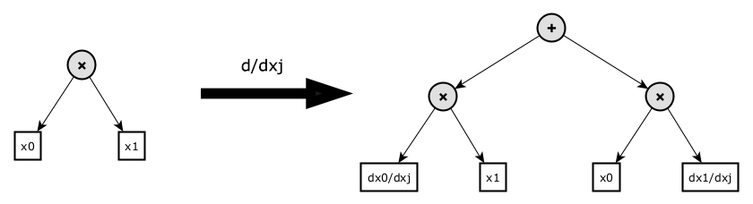

For instance, Figure 1 represents the tree structure conversion of the operation x0x1 for which we expect the differential to be ∂x0/∂xj x1 + x0 ∂x1/∂xj.*
Figure 1 – Tree structure conversion for the multiplication node
Leaves have a special differentiation rule which is
Each property differential therefore has its own (new) tree structure that is based on the initial property tree. Evaluation is then performed bottom-up as for any other tree, except this time you get the property partial derivative to xj.

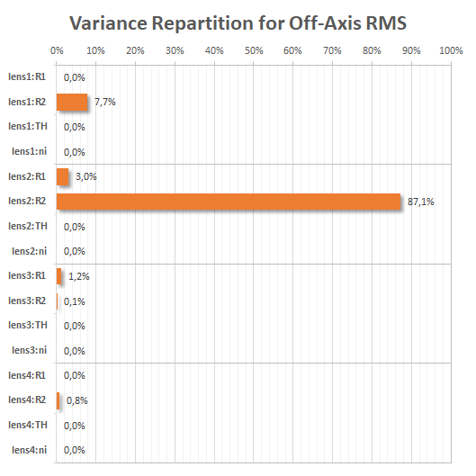

The performances obtained in the example enable direct feedback during the design process which opens new door. In particular, the system not only report the total expected variation on the final property but also how each element affects the total variation. For instance, using the provided tolerances of above, the program evaluates that the wavefront is susceptible to vary by 0.25 lambdas (compared to 0.02 lambdas nominal) with the repartition of variances given by the results in Figure 3. We clearly see that lens 2 is responsible for most of the change and we can therefore focus our attention on its re-design. A look at the variation of the Seidel coefficients reveals that most of the wavefront variation comes from distortion followed by astigmatism.
Figure 3 – Repartition of variance across the system parameters
The overall idea of the paraxial tolerance analysis is to provide quick feedback during the design stage. We can therefore imagine some sort of color or star-based systems where the software automatically informs the designer which elements contributes the most to the variance of the system.
