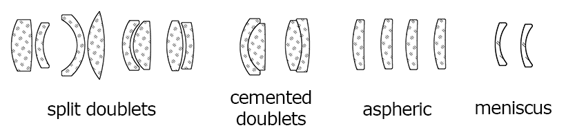

In the very last post, I then showed how a system of two lenses with little airgap (thin doublets) could be tuned such that they are aplanatic as well. We also saw that there exists up to 6 solutions for a given choice of two glasses and 2 solutions when only one glass is used. This means that we now have 12 different ways to make an aplanatic lens. They are shown in Figure 1. Note that there exists an infinity of aplanatic lens designs (e.g. the Perfect Dialyte is an aplanatic lens system on its own) and here we only focused on some specific solutions for thin systems made of up to two lenses. Also, there are four possible aspheric lenses out of two glasses choice since it’s possible to put the aspheric term on either the front or rear surface and we have two glasses to select from. Similarly, there are two meniscus lenses possible from the two glasses available.

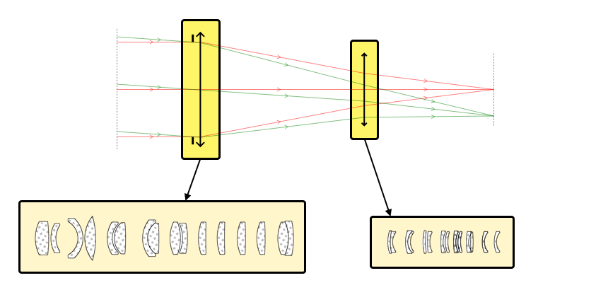

We can therefore substitute any of the lenses of Figure 1 to our Perfect Dialyte design. Actually, not all of these lenses because some solutions are not possible. For instance, it is not possible to use a meniscus lens in front of the design for infinite-conjugate systems (see here why). Also, if we try to use an aspheric lens as rear optics, it will decay into a meniscus lens with no asphericity due to the specific conditions met for that lens (see here as well why). We are therefore left with the solutions of Figure 2.
Figure 2 – Solutions to the Perfect Dialyte problem
And this is precisely where things become interesting! We have 10 solutions for the first lens and 8 solutions for the second lens, summing up to a total of 80 designs for a given choice of two glasses. Actually, only a fraction of these systems will be fully-corrected because of the conditions required to balance the Petzval (only systems composed of an aspheric and meniscus lens of the same glass or based on two doublet lenses of the same glasses will be corrected for Petzval). Similarly, we saw that cemented doublet may have residual spherical aberrations depending on the glasses choice. Nonetheless, all these systems will be pretty close to being fully corrected and should offer high image quality. And this is for a given set of two glasses knowing that the Schott catalog alone contains several hundreds of glasses to pick from!

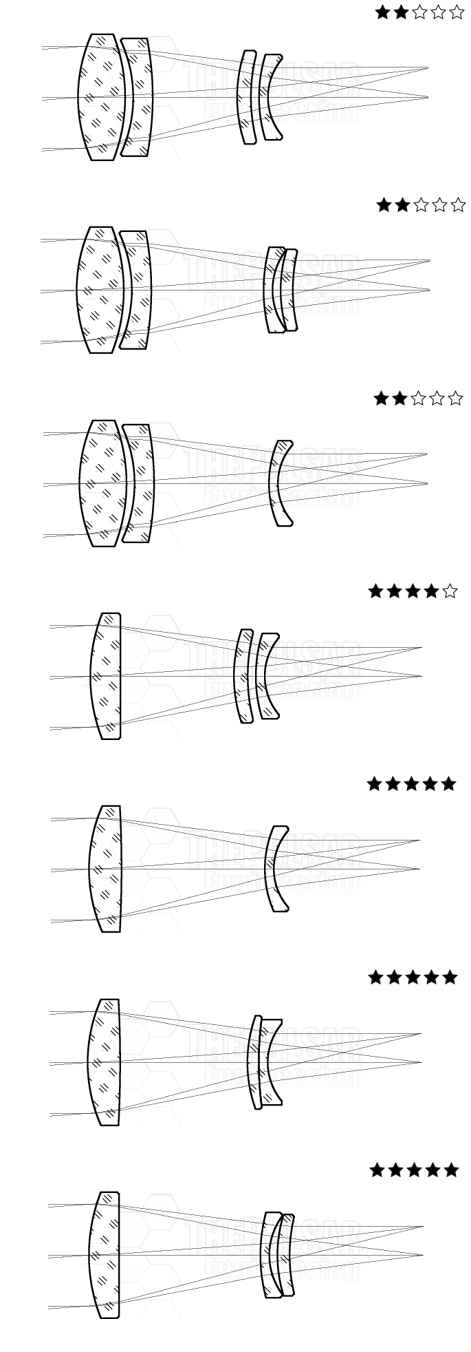

Figure 3 shows some of these procedurally-generated systems with a star ranking based on how far they are from diffraction limit. These systems were generated in only a few minutes, CAD included, for a selection of two common glasses from the Schott catalog. I included systems that had high and low performances to be representative of the kind of solutions generated by the algorithm.

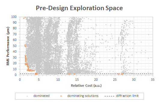

Here, I ranked those pre-designs based on two criteria: (1) rms spot size performance on the whole field, and, (2) relative cost. RMS spot size performance was evaluated as the worst value between on-axis, off-axis and zonal rays as explained here. Relative cost was evaluated using the glass listed relative cost, the estimated blank volume for each lens and by adding a penalty factor for cementation and aspherization processes. Each pre-design can therefore be evaluated along two parameters and there is not a single optimal design but a group of them based on the concept of domination. A system is said to be dominated if there is any other system in the list that has better rms spot size performance and better cost at the same time. We can therefore focus our attention on pre-designs that dominate all others. Note that since this is a bit restrictive and we might leave good solutions on the side, I expanded here the selection to designs that have less than a given number of dominators (10 here, but this is an arbitrary choice).
The results are summarized in Figure 4. Of the 75,680 total systems, 26,910 were evaluated leaving 170 solutions to focus our attention on. Each evaluated system took on average 38 ms on a regular desktop computer and using only 7 Mb of RAM, making the search very scalable to cloud-based architectures.
