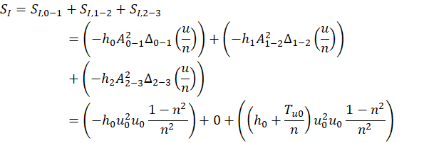

The total spherical aberration of the plane window is obtained as the sum of the three individual components
and so

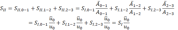

Similarly, we obtain the coma
which gives

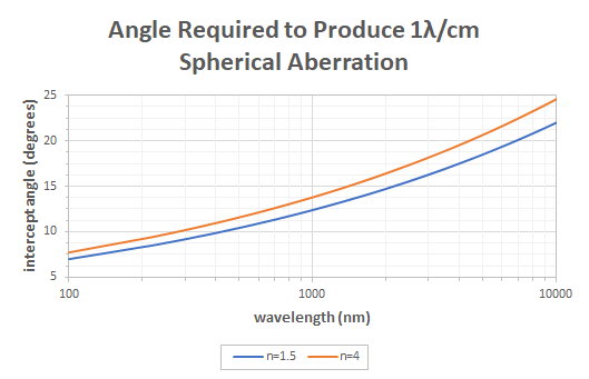

Figure 1 illustrates the order of magnitude involved in the spherical aberration introduced by plane windows for a 1 cm thick window. The results do not depend widely on the refractive index as can be seen in the plot.
Figure 1 – Angle required to produce 1λ of spherical aberration with a 1 cm thick glass window
In the visible range, angles of typically 10° are required to produce 1λ of spherical aberration in a 1 cm thick window. Conversely, a 1 mm window will produce a 0.1λ spherical at the same wavelength and angles. Similarly, a 15° angle on a 1 cm thick window at that same wavelength will produce (15/10)4 = 5λ of spherical aberration or 0.5λ on our 1 mm thick window.
