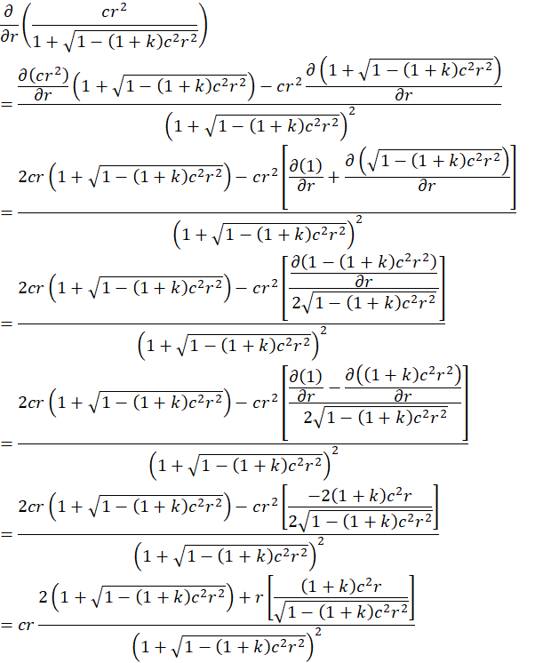

Since the system is symmetric, the expression for dz/dx and dz/dy will be similar and I will only derive the expressions for the dz/dx case. If you are not familiar with derivation operations, here is a remainder of the rules required for this post:
The first thing is to express the derivative in relation to the formula using the radial coordinates:
Concerning dz/dr we have
Applying the rules to the standard conic section surface we get
Posing
We can simplify the equations to
Then,
for which a solution only exists if
meaning that

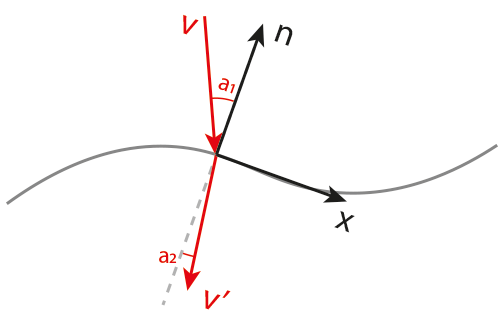

To find the refraction law, we will first split the ray directions into the orthonormal basis n and x, n being the normal vector of the surface and is considered as facing the ray. I will also consider that the incoming direction vector has been normalized (length is 1).
The situation is displayed in Figure 1.
Figure 1 – Refraction of a ray
Under these conditions we have
where α1 and α2are the angle of the ray with the normal before and after refraction.
We find
and therefore
We also know that a ray coming from a material of refractive index n1 to a material of refractive index n2 will follow the Snell-Descartes law of refraction:
and so
The cosine of the incoming angle can be obtained from the dot product of the incoming vector with the normal (I reverted the sign due to the orientation of the normal)
The cosine of the outgoing angle can be obtained using a small trick:
It is important to check that
which would indicate a Total Internal Reflection (TIR) event.
One advantage of the trick used to compute the cosines of the angles is that they do not rely on expensive trigonometric function evaluation but rather use the more simple square root.
The final formula is therefore

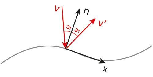

Reflections typically occurs on metallic surfaces such as silver or aluminium mirrors but will also happens on dielectric coating as wells or during TIR events. Reflection of a ray is illustrated in Figure 2.
Figure 2 – Reflection of a ray
Decomposing the ray as before, we get
Therefore,
we obtain the reflection formula
