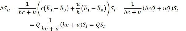

We can compute the coma for two different chief rays (h0,u0) and (h1,u1) but the same marginal ray (h,u):
Since S1 does not depend on the chief ray (h,u) we have
The added coma due to the change in chief ray is
Knowing that, from the Lagrange invariant, we have
we have the relation
leading to
with Q the eccentricity factor
This means that, knowing the seidel coma of the surface at some chief ray (h0,u0), we can compute its value for another chief ray position (h1,u1) using the eccentricity factor as

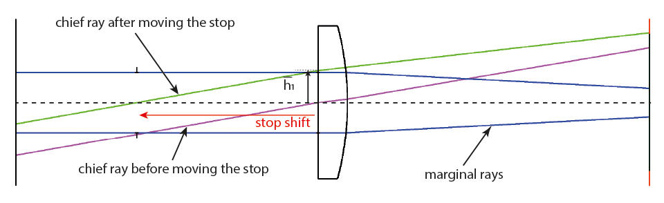

In practice, we affect the chief ray by moving the stop in the system. This is represented in Figure 1 where you can see that moving the stop lower the chief ray interception height with the surface.
Figure 1 – Stop-shifting a lens
Let’s analyze a bit what is going on exactly in Figure 1. You can see a lens in black and a STOP that is moved from the lens to some other position in front of the lens. The initial chief ray, in purple, crosses the optical axis at the lens, so h0=0. This is because of the definition of what a chief ray is. By moving the STOP, we get the green chief ray which intercept the optical axis at the STOP position (again, by definition), and now intercept the lens at some higher position h1. You can obtain the value of Q by using the here-above formula. In Figure 1, since the marginal ray intercept the lens at about the same height as the new chief ray and the initial chief ray intercept height is zero, we get Q≈1.
