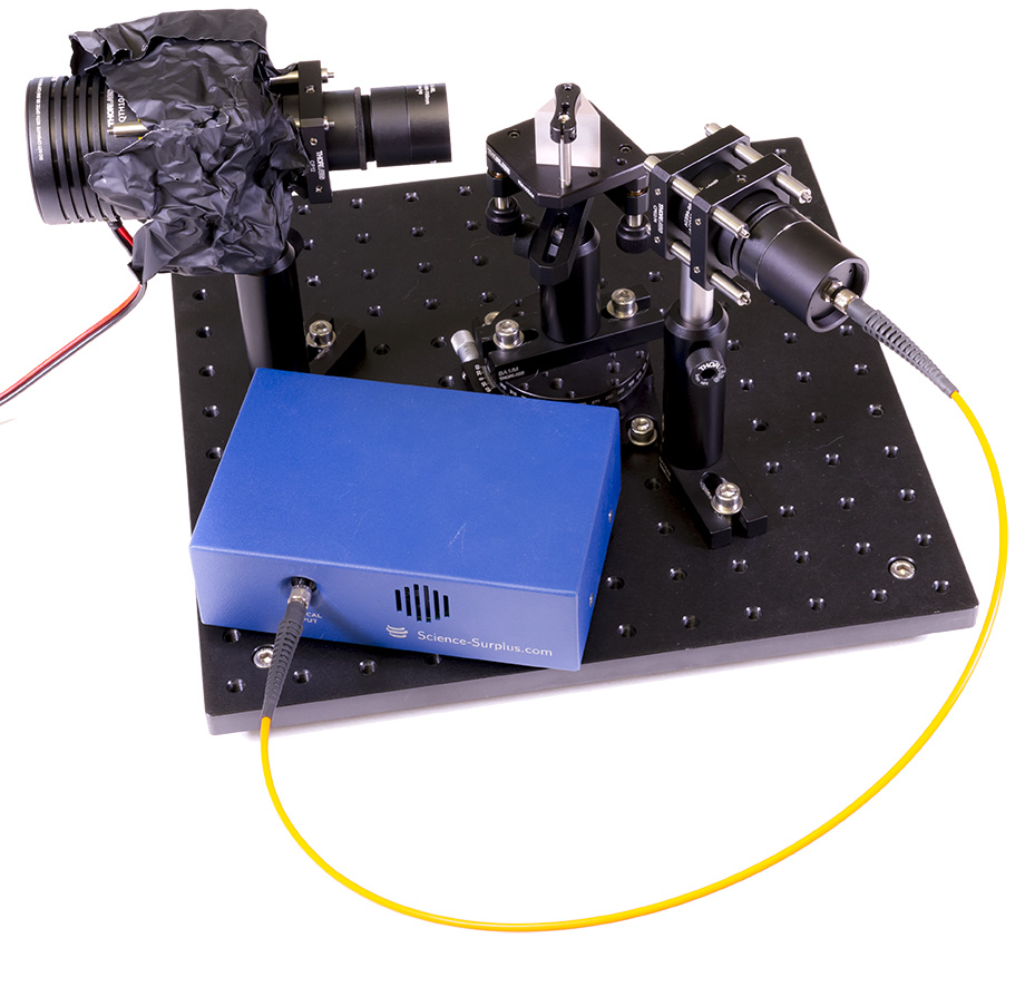

A photography of the setup is given in Figure 1. Clockwise from the top-left corner you can see a tungsten lamp source with a 50 µm slit and a 50 mm doublet lens, a prism, another 50 mm doublet lens and a 50 µm fiber connected to my Science-Surplus spectrograph. I am using the spectrograph here as a comparison tool but normally you would take the fiber to do whatever you want.

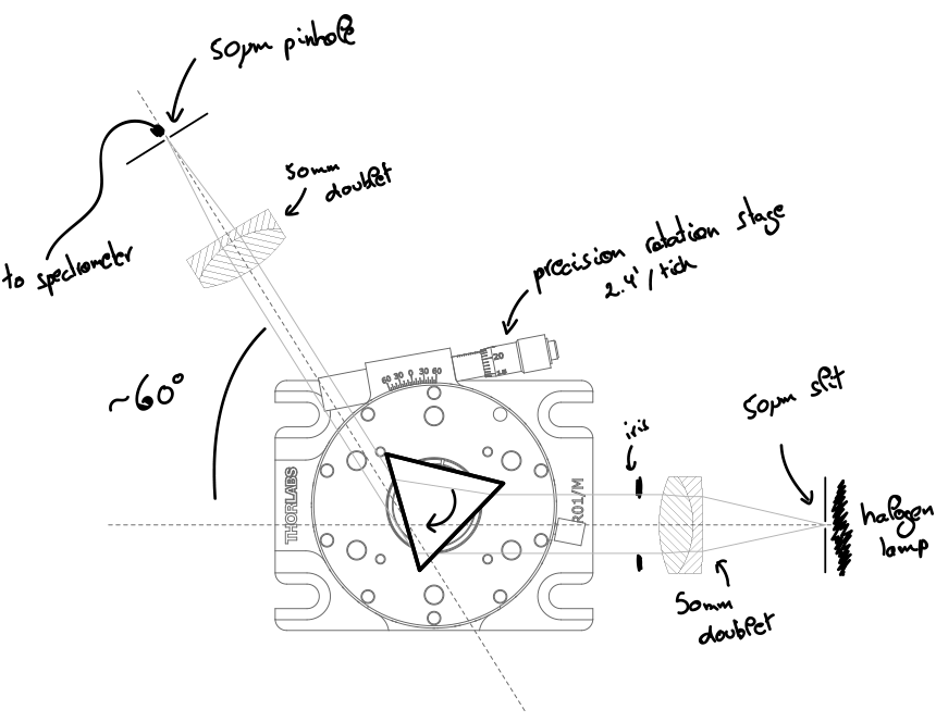

The operating principle is close to the one of a spectrograph except that we only keep the centre of the image by placing the pinhole at the place of the CCD/CMOS sensor. Therefore, we collect only one colour (hence the name “mono-chromator”). To change the wavelength range that we select, we have to turn the prism such that we change the incidence angle. To do that, I am using a PR01/M precision rotation stage that has a micrometre screw which rotates the stage by 2.4’ (0.04°) for every tick marks. If you would like to automatize the setup, you can replace the manual stage by a motorised one. Just pay attention that you need to be able to make very small and repeatable displacements. Note that a nice subsequent advantage of only keeping the centre of the image is that the image is almost aberration-free, which helps in collecting the light properly and to achieve a good bandwidth for the output.
Note also that even if the incidence angle between the input beam and the prism change as we rotate it, the deviation angle between the input and exit beams does not change and is about 58° in this setup. It is not easy to control this angle very accurately when working with a breaboard mounting plate so the best is to built the setup and calibrate it once all the elements are in place.

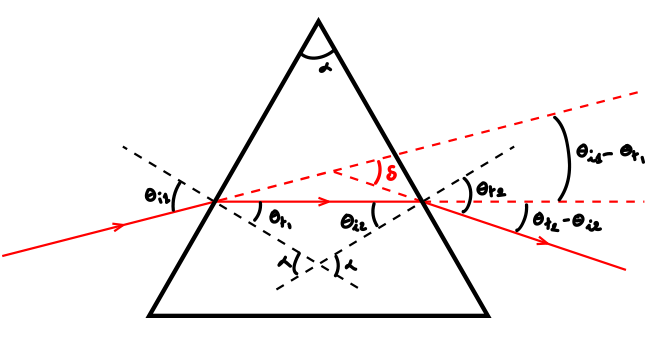

Let’s look at how the prism select our wavelength range now. This is based on how light is refracted inside the prism. The situation is illustrated in Figure 3 and the developments were taken from the book “Optics” by Hecht.
Figure 3 - Calculating the deviation angle of a prism
A light ray enters the prism of apex angle α with incidence angle θi,1 relative to the prism normal surface. The beam is refracted to an angle θt,1 through Snell’s law
where n1 is the refraction index from air and n2 is the refraction index of the prism for the wavelength λ of the ray. Hecht makes the approximation that the refraction index of air is unity for all wavelengths or that the prism refractive index is expressed relative to air.
The refracted ray hits the second surface of the prism with angle θi,2 where it is again refracted to the exit angle θt,2. From Figure 3, we see that θi,2=α-θt,1. After some mathematical rearrangements, we get the expression for the deviation:
By keeping the deviation angle δ constant, we can therefore select a wavelength λ by changing only the incidence angle θi,1. I would like to mention that this is a choice I made for the setup presented here because I felt it was more straightforward to implement. Some monochromator designs keep the prism orientation constant and rotate the lens and exit slit orientation around the prism centre.

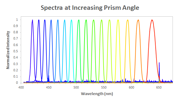

The setup working principle was verified experientially using the setup of Figure 1 by rotating the prism by 5 ticks marks (1 tick is 2.4’) and recording the output spectrum using the Science-Surplus spectrograph. The results are presented in Figure 4 and are limited to the range 400…650 nm due to the spectrograph limitations.

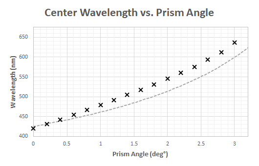

The centre wavelength was computed from the prism angle relative to the initial position and compared to the theoretical value computed for a deviation of 58°. The results are presented in Figure 5 and show a trend that respect the theoretical expectations although there is a gap of about 50 nm for some wavelengths. This deviation may be due to a slightly different deviation angle or by an effect of the air refraction index which was neglected in the theoretical approach. I have not pushed the simulations farter as I was happy with the results which confirms that the modelling approach was correct.
Figure 5 - Centre wavelength with prism incidence angle (relative)

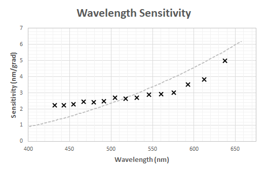

The wavelength sensitivity can be directly interpreted from Figure 5 by differentiating the results and is presented in Figure 6. The wavelength sensitivity shows how the centre wavelength shifts for every tick of the rotation stage. If you are using a motorised stage, it represents the smallest repeatable angular steps that you can make.

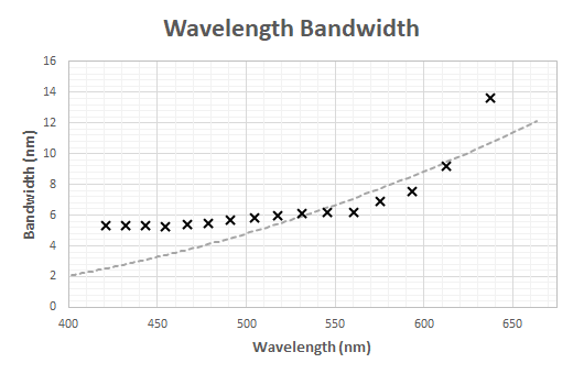

Finally, it is important to understand that a monochromator does not select a single wavelength but a wavelength range. Because we are accepting all the lights rays that passes through the output pinhole, it means that we will inevitably accept wavelengths that are slightly off the wavelength of interest (what we call the centre wavelength). This is why in Figure 4 we measured spectra that had some wavelength spread.
To reduce the spread, you can use a smaller pinhole or a longer focal length. But be careful however that you should always design a monochromator whose bandwidth is in excess to the wavelength sensitivity. Indeed, if you have a very precise monochromator that has a 0.01 nm bandwidth but has a wavelength sensitivity of only 1 nm, how would you go from, say, 500 nm to 500.5 nm because you want to study an absorption band at 500.5 nm for instance? The fact is that, you cannot because you can only go from 500 nm to 501 nm since your smallest angular step only does a 1 nm and not a 0.5 nm. Also, what if you want to have a complete spectrum and not just discrete tiny part of a spectrum? The only way to do that is to open your output pinhole to get a larger bandwidth such as to cover from 499.5 nm to 500.5 nm and from 500.5 nm to 501.5 nm and so on. And if you really need to have a 0.01 nm bandwidth, you will have to find a rotation stage that have much smaller step angle.
Figure 7 - Output bandwidth with a 50 µm slit and 50 mm lenses
