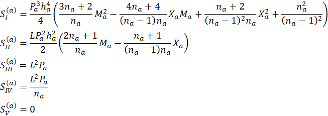

The aberrations of a single thinlens at the STOP are given by
where the subscripts a stand for each individual lens.

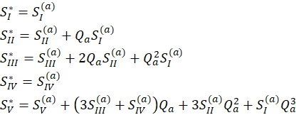

Each of these quantities then need to be corrected by the stop-shift equations to take into account the actual position of the STOP
where Q is the eccentricity factor given by the ratio between the interception height of the chief ray and the marginal ray.

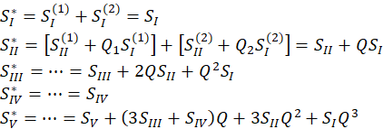

This is where things simplify a bit because thin doublets have no airgap and therefore shares the same eccentricity factor
and therefore

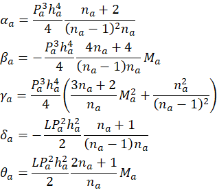

Because each of the thinlens aberration function is a relatively complex formula, I will rewrite the equations for spherical aberration and coma as polynomial functions of their respective bending Xa
where the coefficients are
we therefore have

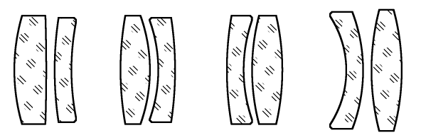

Figure 1 shows an example of the two solutions for a 20D doublet made of the same glasses. The first solution is referred to as the Gauss form while the second solution is known as either the Fraunhoffer or the Steinheil form depending on the choice of the glasses when we use different glasses. Note that although we talk about thin-doublets, I reoptimized the case using a thin air gap for manufacturability purposes but the initial conditions were obtained using the formula here-above.
Figure 1 – Two solutions for a 20D doublet

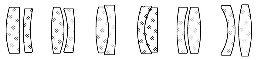

As a conclusion, we saw that there are two aplanatic solutions for thin doublets of the same glass, four aplanatic solutions if we use different glasses and two more nearly aplanatic solutions by cementing elements.
The total six solutions to our 20D doublet problem are given in Figure 4.
Figure 4 – Combined solutions to our aplanatic doublet problem
