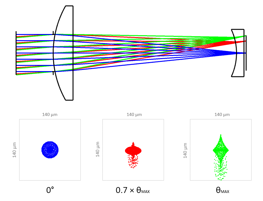

According to this criteria, an image will be considered at its best focus when the root-mean-square value of the radial interceptions of the rays with the image plane is minimal. It may look daunting when expressed like that but we have already met rms spot size in the past. Put shortly, rays traced across the pupils from the same object point source will meet the image plane at different positions. The rms spot size is a measure of “how large” the spread on the image plane is. An illustration of the spot diagrams for three different field angles are given in Figure 1 with one color per field angle.
Figure 1 – Example of spot diagrams for three different field angles

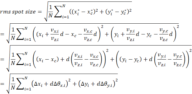

The rms spot size after a shift of image plane d can therefore be computed as
the centered coordinates.
Note that vx/vz and vy/vz are respectively the deviations (tangents) along x and y respectively.

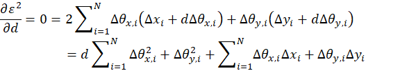

From this expression, we can use the least-square theory to compute the value that minimize the error ε2:
and therefore
The best defocus position of the image plane is therefore obtained in a single-pass without any need of iterations.

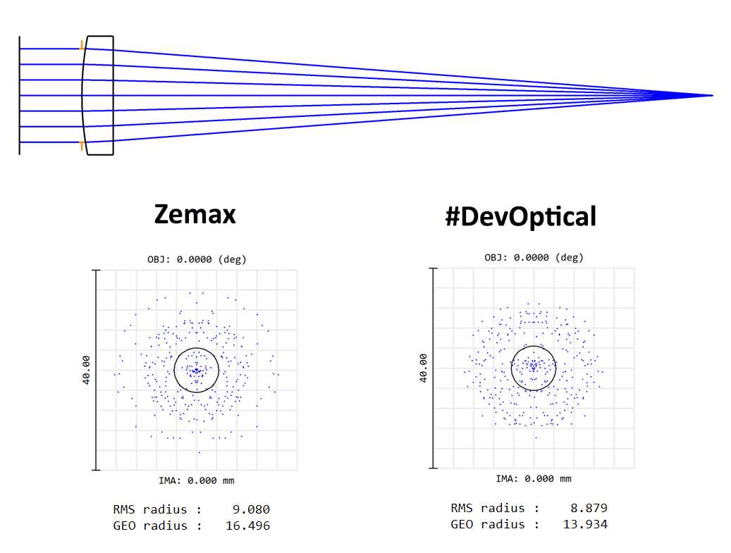

For a 100 mm focal length planoconvex lens with a 15 mm diameter aperture, Zemax found a best focus position at 96.230 mm yielding a rms spot size of 9.080 µm. The formula here-above predicted a best focus position at 96.196 mm (a 34 µm difference) and yielded a rms spot size of 8.879 µm in Zemax itself! The results are presented in Figure 2.
Figure 2 – Validating the quick focus algorithm in Zemax
This doesn’t look much of a difference but it’s still a very unexpected results as it is possible, in Zemax software, to find a position that yields a better rms spot size than what the software quick focus feature is able to find.

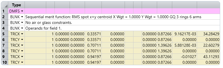

I repeated the experiment using this time the merit function wizard to yield the minimal rms spot size to see if the quick focus used some sort of approximation and if a real, iterative, merit function would yield better results. The merit function generated is displayed in Figure 3 and generated a best focus of 96.230 mm – just like the quickfocus button.
Figure 3 – Best rms spot size merit function
I believe the non-optimal results given by Zemax is a direct consequence of the uniform pattern used in its computation. Indeed, we have seen in our former post that using a repetitive pattern can yield inaccurate results and that it is better to use a pseudo-random distribution in the pupil space. Clearly here Zemax is using a pattern in its merit function and it probably also is when you click the quick focus button. In our algorithm, I used a Poisson distribution and the results of Figure 2 are given using a dithered pattern (a less performant pseudo-random technique than a Poisson distribution). That may explain very well the observed behavior.
