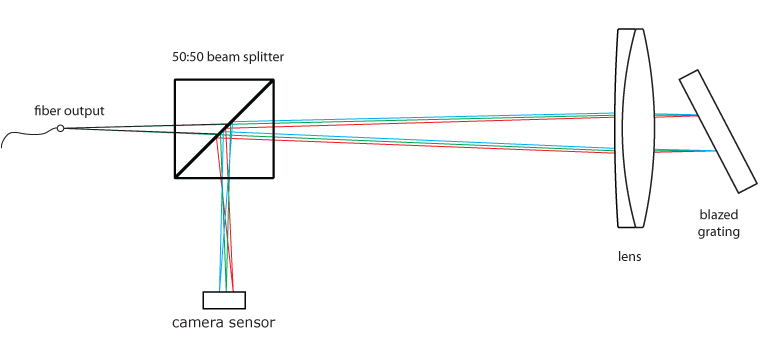

The system I have built is based on a Littrow configuration which is represented on Figure 1. If you have read carefully my previous posts, you will also recognize the basis of the setup as the angular detection setup built recently but with a fiber output as the light source this time. This is for sure not a coincidence since I wanted to demonstrate how generic the autocollimator setup can be in an optical lab.
Figure 1 – Littrow Configuration
If you remember the angular measurement setup, you will recall that light escaping the source is first collimated by the lens before being reflected by a mirror with a tilt angle ∆θ. After reflection by the mirror, the light is then focalized on the camera sensor with a lateral shift of f∆θ (for small angles), where f is the focal length of the lens.
Gratings are, however, not mirrors and act slightly differently. Because of the groove pattern on the grating surface, each wavelength composing the light source will be deflected by a slightly different angle. The autocollimator will then translate this angular shift to a lateral shift on the camera sensor and we will see duplicates of the fiber head convoluted with the light spectra on the camera image.
I also said that the spectroscope built here is based on the Littrow configuration. This corresponds to a special spectroscopy setup where the incoming light beam is reflected almost directly back to the source. This works only for one specific wavelength which can be computed using the diffraction grating law:
this becomes
For instance, at 1,200 lines/mm and first diffraction order (m=1), the wavelength 500 nm has a Littrow angle of 17.46°. Other wavelengths angle can then be found using the diffraction law:
A small variation of wavelength ∆λ will produce a small angular shift ∆θ of (by differentiation):
Littrow configuration is so popular that a special type of gratings (the blazed gratings) have been optimized to concentrate energy into a given order when used in this specific configuration. This is the case of the visible gratings that I have purchased from Thorlabs previously, even if I did not used them in the Littrow configuration at that moment.

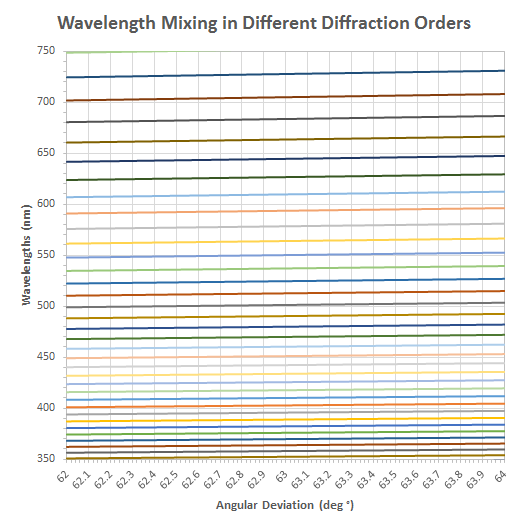

These Echelle grating may look like the panacea but it comes with a drawback that is due to the spectral sensitivity. Because we use it at high diffraction orders, some other wavelengths will mix because their “mλ” quantity will have the same value. For instance, 532 nm at order 42 will also be mixed with 520 nm at order 43, 510 nm at order 44, 545 nm at order 41, 559 nm at order 40 and so on…
With our setup we have an angular range of ±1° which will give the overlapping of diffraction orders of Figure 2. I have limited the plot to the wavelengths ranging from 350 nm to 750 nm. You can see in the figure that there are a lot of wavelengths mixing near to the UV region because of the higher diffraction orders. Of course, due to the blazed nature of the grating, one mode will be strongly enhanced relatively to the others and so you may not notice the mixing but you cannot take this effect for granted because tiny signals in the blazed order may be mixed with strong signals that are in higher (or lower) diffraction orders.
Figure 2 – Wavelength mixing at different diffraction orders
To avoid overlapping the various diffraction orders, we will have to use a second grating (or prism) to separate the orders orthogonally with the fine division. That way, we make the full usage of the camera 2d area because we will have the fine resolution along “x” (let’s say) and the coarse/orders division along “y”. A second way it to cascade two spectrometers and to feed the high-resolution spectrometer with a signal already filtered by a low-resolution monochromator. I will not cover this here and leave that for a future post.

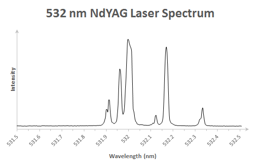

One way to use the setup without orders separation is to use an almost monochromatic source. Here, I have used the setup to study the longitudinal modes of my 532 nm NdYAG:2 laser. The results are shown in Figure 3.
Figure 3 – 532 nm NdYAG:2 laser spectrum
You can clearly see that there are several distinct lasing modes that are well separated. These longitudinal modes are responsible for the limited coherence length that you may experience with such lasers. The two modes on the left of the figure allows for an estimation of the resolution accuracy. These modes are separated by 0.010 nm which is the theoretical resolution of our spectrometer when limited by the imaging resolution. Also, when I recorded the data of Figure 3 I had to saturate a little bit the centre mode to view the side modes and so the peak at 532 nm is actually double (you may indeed notice a small bump on the side). The distance between these two mode is also ~0.015 nm although it does not appear frankly here.
The setup therefore behaves very satisfactorily and we have plenty of signal with a SNR above 500. What could we ask more?

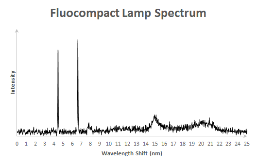

Despite all of that, I did however succeed in measuring the spectrum of a fluocompact light bulb. Sure, it required tons of blackout material around the setup, the longest expositions available on my camera and the gain set to 100 but it worked. The results are presented in Figure 4.
Figure 4 – Fluocompact lamp spectrum
