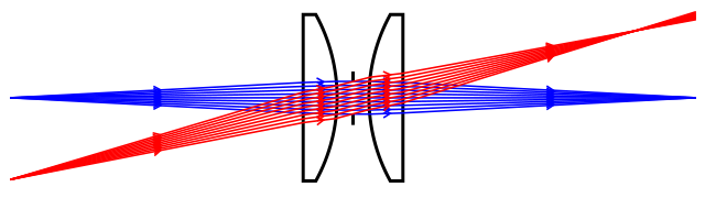

To illustrate, I chose the system of Figure 1 which is made of two plano-convex lenses separated by an aperture stop. The lens are both 50 mm focal length and the aperture stop diameter is 5 mm. We will simulate an image that is 25 mm height, which is as large as the diameter of the lenses.
Figure 1 – A simple optical system

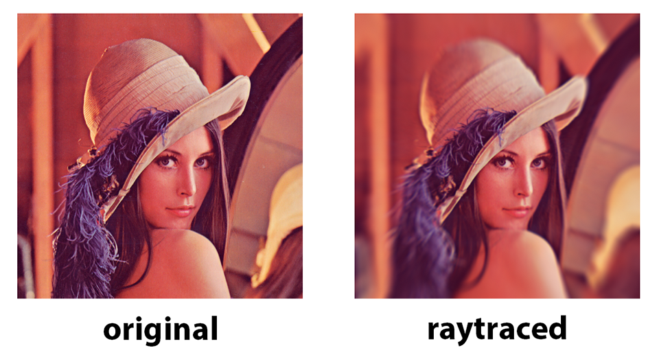

After applying the algorithm to the Lenna picture using a 33×33 sampling of the entrance pupil, I obtained the results of Figure 2. Note the loss of sharpness as the image goes through the optical system.
Figure 2 – Result of the geometrical image simulation process
Let us analyse the results of Figure 2. You can skip this section if you did not watch our former video.
The first thing we notice on the raytraced image is the loss of sharpness as we move away from the center of the image. This is typical for almost all optical systems as the center part of the image is always closer to the paraxial approximation and therefore has better overall quality. Comma, astigmatism and field curvature are typical aberrations that will induce blurry edges in a picture.
On the other hand, if you look closely, you will see that the furry-stuff of her hat has more blur than the rest. This is because the system of Figure 1 is far from being achromatic and blue light will usually be out of focus faster than other wavelengths. This is a clear example of what chromatic aberrations induce in a picture.
Finally, if you pay attention to details near the center of the image, such as the model’s eyes, you will see that they have loss a bit of sharpness even though we are in the center region of the image where coma, astigmatism and field curvature usually become insignificant. Even if chromatic aberrations might explain a part of the loss of sharpness, it is also typical of spherical aberration which depends only on the size of the aperture and appears everywhere in an image. We could have reduced the blurriness by decreasing the aperture size but this would translate into less light going through our system.
Clearly, if we had to perform this experiment, it would be better to limit the field of view to about 10 mm diameter rather than the full 25×25 mm² used here.

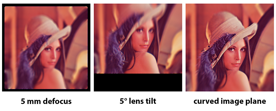

We can do many more things using geometrical image simulation and some are illustrated in Figure 3. It is a convenient way for a student to experiment with lens systems without going to the lab.
Figure 3 – Example of image simulation as we modify the optical system
