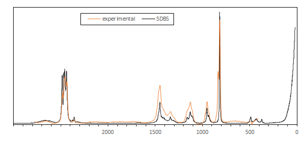

Even in the absence of the laser swap, the resolution already improves as can be seen in the new spectrum of iso-propanol shown in Figure 1.
Figure 1 – iso-propanol spectrum with the new imaging lens system

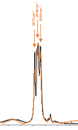

The biggest change with the old spectrum is located in the 3000 cm-1 region where the three peaks are now fully resolved as can be seen in Figure 2. The two peaks on the right are distant by only 19 cm-1 and appear fully resolved from each other.
Figure 2 – Close-up at the 3000 cm-1 region of the i-PrOH spectrum

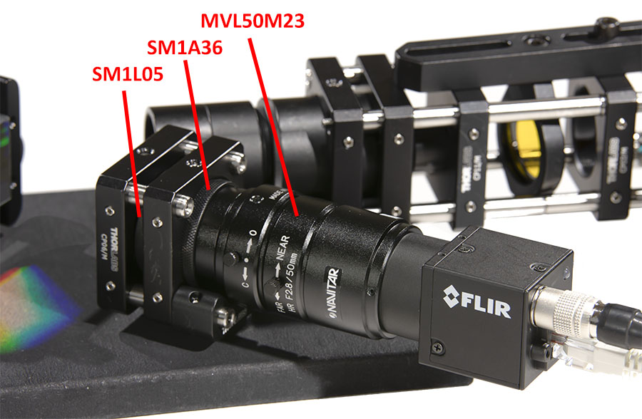

Since I was clearly not happy with the results, I decided to look for an alternative at machine vision lens manufacturers. I was lucky enough to find the NAVITAR MVL50M23 which fits right into the existing spectrometer setup and was able to deliver a theoretical 7-8 µm spot at f/4. The lens is old at 180€ at Thorlabs or 155€ if you purchase it directly from the manufacturer.
The quick assembly of Figure 3 will allow you to replace the old imaging lens by the machine vision lens. Because there is already a stop inside the lens, you can remove the external aperture in front of the collimation lens.
Figure 3 – The NAVITAR MVL50M23 in the spectrometer setup

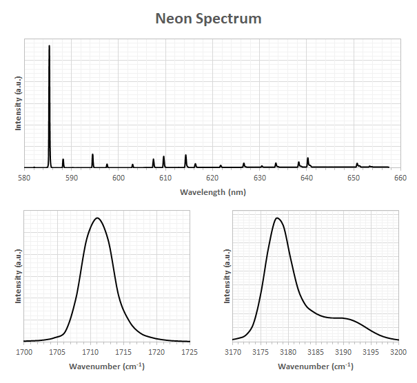

The resolution was confirmed experimentally with a Neon lamp as shown in Figure 4.
Figure 4 – Experimental neon spectrum with the new imaging lens
The resolution at 1700 cm-1 is about 6-7 cm-1 as predicted. Note however that at higher wavelengths/wavenumbers, a shoulder appears next to the peak. This was foreseen by the raytracing as shown in the PSF at 640 nm in Figure 5. Later experimentation with actual Raman spectra will show if this is a problem or not.

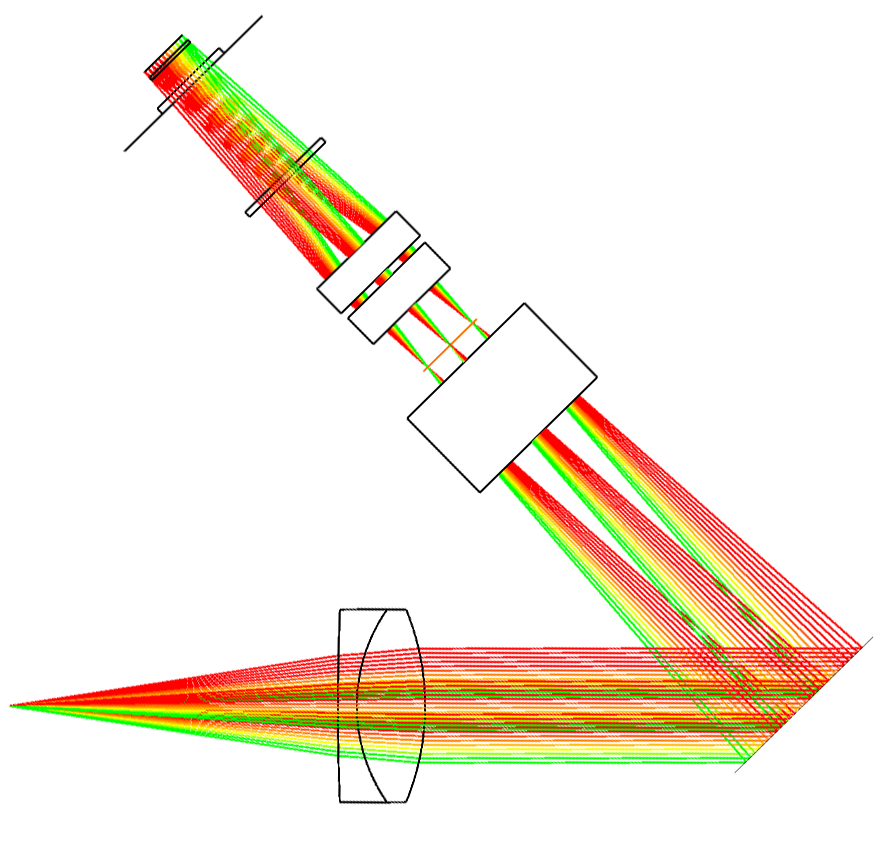

That being said, I was extremely lucky here and managed to get the blackbox model for the NAVITAR lens. This is how I manage to assess the actual performances of the system before building it. The system is shown in Figure 6.
Figure 6 – Spectrometer design with the NAVITAR lens included
The white rectangles are part of the blackbox model and represent group of lenses. You can notice the stop (in orange) located between the blocks. The smaller rectangles are windows that protect the objective and the camera. It is important to include them in the simulation because they will introduce small amount of spherical aberrations that will affect overall resolution.
The system is represented here for an input numerical aperture of 0.12 and you can see that it almost completely fills the 25×25 mm² surface of the grating. It is not recommended to use the full grating surface as edge tend to have more defects which can produce stray light into the system.
