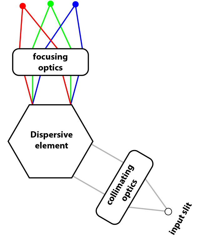

All dispersive spectrometers (i.e. grating and prism based spectrometers) are built on the same concept: the light to analyse is fed into a slit or pinhole, collimated with a first optical system, sent to the dispersive element (grating or prism) which can be seen as a mirror whose output angle is colour sensitive and the output beam is refocused by a second optical system on a linear sensor or on a camera. I have put the monochromator design (another pinhole in the refocusing part) away from the discussion because it obeys to slightly different rules. A generic schematic design is shown in Figure 1. Please note that just like the dispersive element can be a grating or a prism, the optical systems can be a refractive (lens) or reflective (concave mirrors) design. The exact nature of the elements does not change the outcome of the discussion that I will address here.
Figure 1 - Dispersive spectrometers generic design
If we were to replace the dispersive element by a mirror, the setup would simply be a relay imaging system of the input pinhole where the image of the pinhole would be shifted laterally based on the exact angle of the mirror and the position of the optical systems. The fact that the dispersive element is colour-sensitive will produce an image that is actually convolved with the spectrum of the input light. So, if our light source contains two lines colour, one 650 nm red and one 460 nm blue, we will get two images of the slit shifted laterally from each other by the angular dispersion between the red and blue colours multiplied by the focal length of the imaging system. A very important consequence of this convolution operating system is that even if the light spectral lines are infinitely thin (e.g. ultra pure single mode laser with 0.00001 nm line width), we would get an image that has the width of the input slit and not a zero width. Put differently, the slit size in a spectrometer acts s a low-pass filter on the spectrum to resolve and will smooth out any small details.

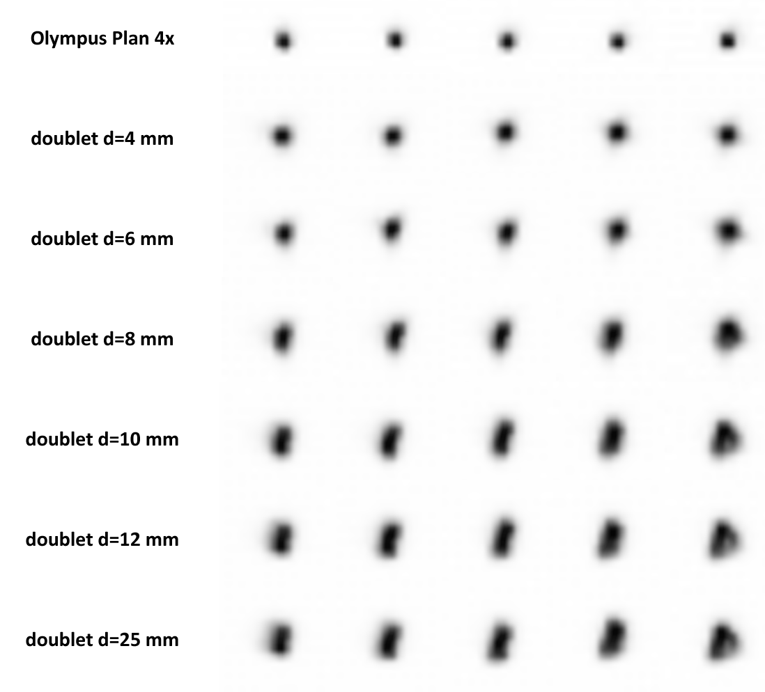

To illustrate this, I have performed a simple experiment with a 50 mm doublet lens (that already has a good image quality when compared to a singlet lens) and a 10±3 µm fiber. I assembled a spectrometer-like setup where I replaced the dispersive element by a mirror. I have then recorded the image quality using different apertures value. Indeed, closing the aperture will reduce the optical aberrations in the system (mostly spherical aberrations) and increase the image quality. I took the measurement at different places in the field of view, from centre to the edge of the camera sensor, and compared this to the result obtained with an Olympus Plan Achromat 4× 0.10 NA (45 mm focal length) which is known the be diffraction-limited on a field of 5.5 mm. The results are presented in Figure 2.
Figure 2 - Experimental results
As it could have been expected, the performances are much better for the smallest apertures.

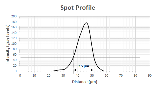

The size of the spot was evaluated at centre for the Olympus microscopy objective using a threshold of 63% (stdev value). The result is shown in Figure 3 and is 15 µm which is consistent with the size of the diffraction spot (3 µm) and the size of the fiber (10±3 µm).
Figure 3 - Size of the fiber image using the Olympus objective

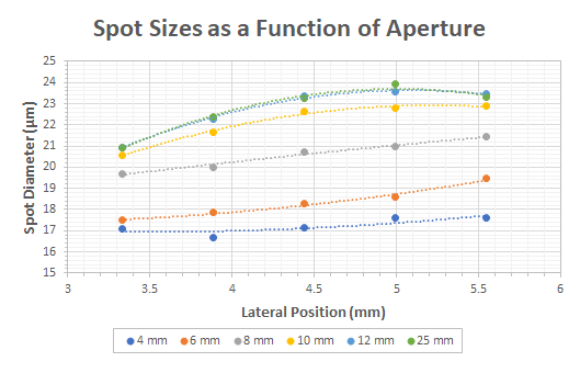

The same procedure is repeated for all the spots of Figure 2. The results are shown in Figure 4. Clearly, the system performs better at apertures of 4 mm and 6 mm.
Figure 4 - Spot sizes as a function of aperture diameter

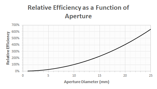

To build a spectrometer, one can then choose to use either the microscopy objective or to close the aperture of the doublet to about 4 mm. This is true for the image size but we have not look at the efficiency yet. Indeed, by closing the aperture we are also limiting the light throughput of our system from f/2 (25 mm aperture) to f/12.5 (4 mm aperture). This has a consequence on the efficiency. A plot of the efficiency ratio versus the microscopy objective collection power is shown in Figure 5.
Figure 5 - Relative efficiency as a function of aperture diameter
The system is therefore not so efficient for the same image quality as the microscopy objective but becomes much more efficient if we release a little bit our resolution requirements. There is then a trade-off to make here between efficiency and resolution. Does that mean that both systems are equivalent? No because, as we have seen, it depends on what we would like to achieve. Does that mean that all systems are potentially good as long as you use it properly? Once again, the answer is no. To understand why we need to make a performance analysis of the different systems that we are looking at.

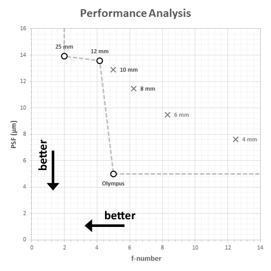

Performance analysis consist of comparing a set of solution in all their aspects (strong points and weak points) and see if any solution outperforms the others. This analysis has to be performed in the early phases of the design and optical design software comes very handy so that we do not have to make actual experiments as I did here but simulate them instead.
I have then plotted each measured on a graph that is shown in Figure 6. Normally, the exercise would be done through a simulation process in a software like Zemax OpticsStudio or OSLO.
Figure 6 - Performance analysis of the experimental results
To have the highest performance spectrometer we would like to have the f-number as low as possible (high numerical aperture, therefore high signal throughput) while maintaining the highest image quality and so having the smallest PSF possible. We see that some solutions clearly outperform others in Figure 6. A solution A is said to outperform another solution B if all the attributes of A are better than the attributes of B. All outperformed solutions can be removed from the analysis as they give no additional value. Which solution you pick from the remaining set will depend on the importance that you give to each attribute. The choice will be very different if you need more efficiency than if you need more resolution. A common solution to this, but far from being optimal, is to assign a weight to each attribute and to sum the weighted attributes to give an overall score for each solution. Then, you just pick the solution that has the smallest overall score. Each weight should be related to how important an attribute is to you. And if you are not happy with the final solution, it means the weights are not correct and you should consider revising them. That is the part where I don’t like the methodology because you go from a very objective approach (performance analysis) to a very subjective one (weight-based approach). But that is a different story and I don’t have enough space to cover it here.
In Figure 6, outperformed solutions are shown by a cross mark and outperforming solutions by a circle. A dashed grey line connects all the outperforming solutions found. When looking at Figure 6, it is relatively obvious that there are only two acceptable solutions: the microscopy objective and the full aperture doublet. Strictly speaking, the 12 mm aperture is not outperformed by the other solutions because it has a slightly better PSF than the full aperture and a slightly smaller f-number than the microscopy objective. However, none of these improvements are significant and we can disregard this solution in profit of the two remaining ones.
