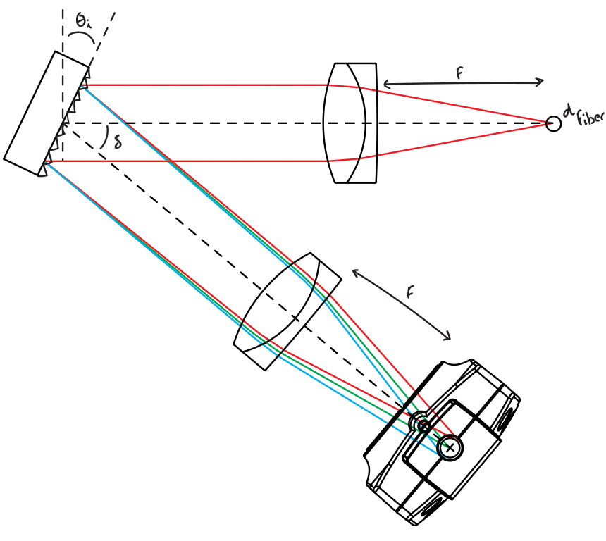

The overall spectrometer design is not so complex and is schematized in Figure 2. It consists of a fiber input (or a slit) placed at the focal position of a collimating lens, a 300 lines/mm blazed grating, an imaging lens and a CMOS sensor. It is worth mentioning that the design was fashioned around a 4-f system to reduce optical aberrations. That is, the distance between the lenses and the grating are also equal to the focal lengths. Please note that the grating acts as the optical stop of the system.

In the following sections I will first cover the theoretical design of the spectrometer presented here before moving to its assembly (including the base plate layout and 3D models) and the experimental results obtained with it.

Concerning the imaging side, most of the time you will use a factor 1 magnification which means that the imaging focal length will also be equal to 50 mm. Using a different magnification factor is possible but I have never found any practical cases where it gave added benefits.
Now that we have set the detector size and focal lengths, we can only play on the grating frequency and input/output angles to set the wavelengths at the proper position on the sensor. To choose the best parameters we will use the equation of the grating:

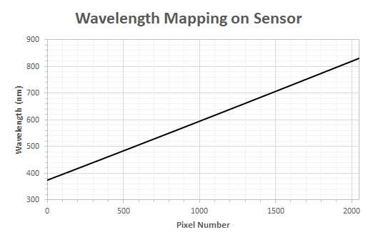

You can solve the equations analytically but I have found Excel to be a very nice friend to play in real time with the settings. For instance, here is what Excel will plot for the current system with δ=40° and θi=25.5° using a 300 l/mm grating. The results are shown in Figure 3.
Figure 3 – Excel plot of the system with δ=40° and θi=25.5° and 300 l/mm grating

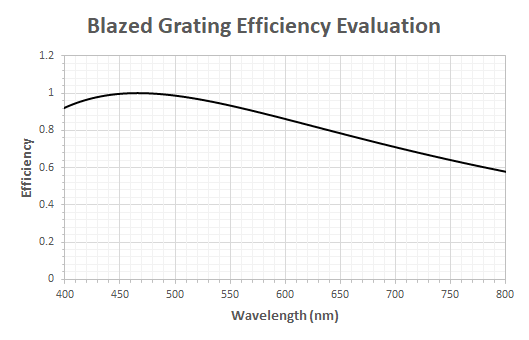

Finally, it is possible to estimate the efficiency of spectrometer in terms of light throughput. The lenses are the easiest elements as their transmission is usually available from the supplier. The camera quantum efficiency is more difficult to obtain but a typical, normalized, value is the one of silicon photodiodes. The grating efficiency is more difficult to estimate as it depends on many parameters but R. Casini and P.G. Nelson have proposed the following simplified (sic!) model that works relatively well for blazed grating under unpolarized light:
with θb the blaze angle and
I have found convenient to add this model to my Excel spreadsheet just to be sure that I am using the blazed grating in an optimized way. The plot for the current system is given in Figure 5.

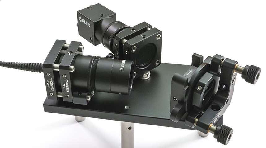

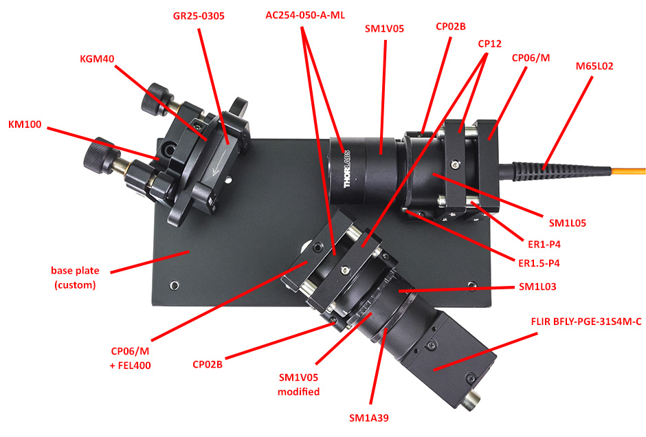

The optomechanical setup is shown annotated in Figure 5 and can be built under 1400€ (ex-VAT). It was designed for the parameters discussed in the previous section but can easily be extended to other ranges.
Figure 6 – Annotated opto-mechanical setup
The collimation system can be built using either a slit or a fiber, a 50 mm lens and a variable length tube. The length of the tube is adapted in front of an autocollimator until the image of the slit is projected at infinity and appears sharp on the autocollimator camera. The imaging system is built in a similar way except that the threading of the variable length tube had to be shortened on a lathe to a remaining thread of about 7 mm. If you cannot machine the part yourself, you may contact Thorlabs directly and ask a quotation for a custom part (at higher costs…).

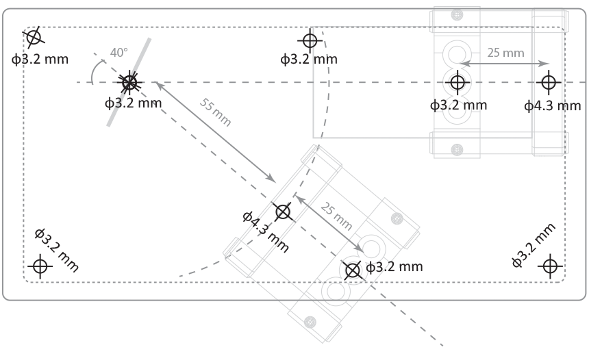

All the elements are placed on a custom base plate that you can either make yourself using a vertical column drill or a mill or you can also download a 3D model for SLS printing. I have not tested the 3D model yet but I designed it on the very same basis as the DIY layout so I’m 99.9% sure it will work. If you are using the 3D model, you will need to tap some holes using M4 helicoils. The 3D model link is given at the end of the post.
To make the part yourself you can also download the layout of Figure 6 at the end of the post. Simply print the pdf using 100% size (no scaling) option on adhesive paper and fix it on a 160×80×10 mm block of aluminium. I got mine from RC Machines. Drill the holes carefully at the selected positions using a vertical column drill or a mill. Do not attempt to drill by hand or you will screw up the alignment and waste your time. Tap all the 3.2 mm holes to M4 threading. To have a clean finish and reduce stray light, process the plate with coarse sandpaper and apply 2 layers of black matte paint. Finally, you will need to use some washers to get all the elements at the proper height. I have used 4 M6 washers below the CP06/M plates and 3 below the CP02B plates.
Figure 7 – Printed layout for drilling the holes

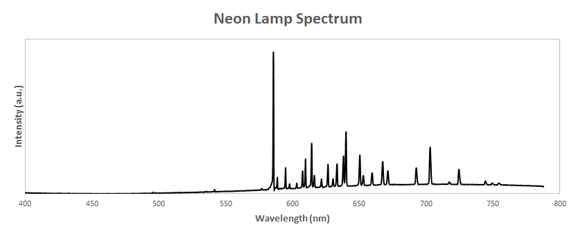

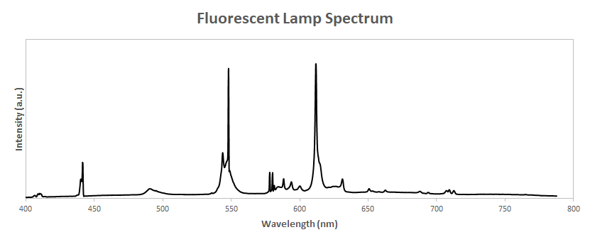

The spectrometer has been tested using both a fluorescent lamp (Figure 7) and a neon lamp (Figure 8). A wavelength calibration was obtained from the Neon peaks using the astrosurf data. The pixel to wavelength relationship was found to be perfectly linear (R²=1) as predicted by our equations as shown in Figure 3. The span was a little bit smaller than expected with a range of 425 nm instead of the expected 455 nm. Nonetheless, it successfully covers the 400 to 800 nm region.
Figure 8 – Fluorescent lamp spectrum – 10 µm fiber
Figure 9 – Neon lamp spectrum – 10 µm fiber
Although it is difficult to measure the actual resolution of the spectrometer as plotted in Figure 4, it is possible to estimate an upper bound using the neon spectrum in Figure 8. Indeed, several peaks of the neon spectrum are relatively close such as the one at 638.3 nm and 640.2 nm which are distant by 1.9 nm only. These lines are clearly resolved in the nominal configuration (the one that was used to generate Figure 8), so we can say that the resolution is better than 2 nm at 640 nm.

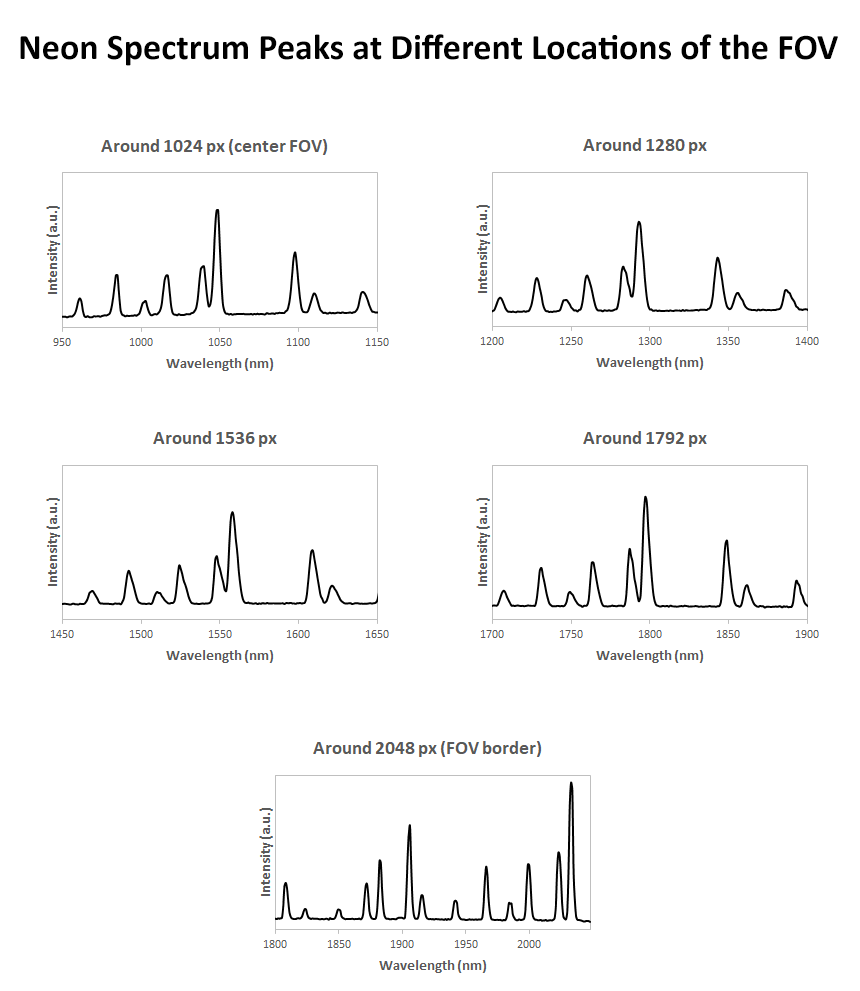

One of the factor that can limit resolution is the aberrations which are known to change in the field of view as we go from the centre of the field to its edge. To measure the effect of aberrations on the resolution, the grating was tilted such as to move the two lines near 640 nm at different location in the field of view. The results are shown in Figure 9. The lines are clearly resolved in all parts of the field of view and we can therefore say that aberrations are unlikely to affect the <2 nm resolution measured previously.
Figure 10 – Resolution of the neon lines at different locations inside the field of view
The other factor that can affect resolution is the colour of the light. To have an insight in how colour affects resolution, the spectrum of the fluorescent lamp can be used (Figure 7). The only difficulty here is that the lines are more distant. For instance, the two green lines of terbium and mercury are located at 542.4 nm and 546.5 nm and are distant by 4 nm. They are correctly resolved as we could have expected. We also have several lines at 577.7 nm and 580.2 nm for instance (distant by 2.5 nm) which are also correctly resolved. It is however difficult to tell more from this spectrum and different light sources should be tested for resolution.
To reproduce the optical bench, please download the layout file and print it on adhesive paper. All the 3.2 mm holes shall be tapped to M4. Once all the holes have been drilled/tapped, prepare the surface by first sanding it with coarse grain and degrease it properly. Apply a thick layer of matte black paint to reduce stray light.
