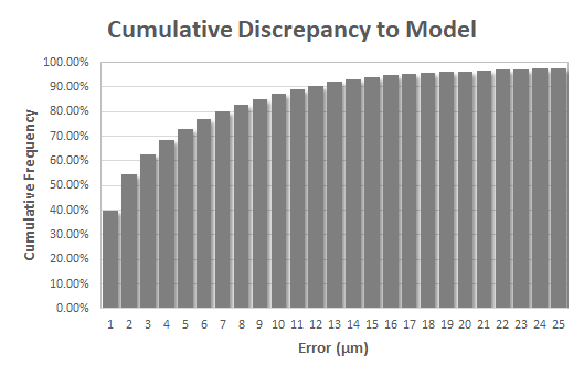

The model has a median error of 1.9 µm when tested on all the available achromats together for aberrations up to one hundred time the diffraction limit of each lens. The cumulative error is shown in Figure 1.
Figure 1 – Model error on all achromats tested together

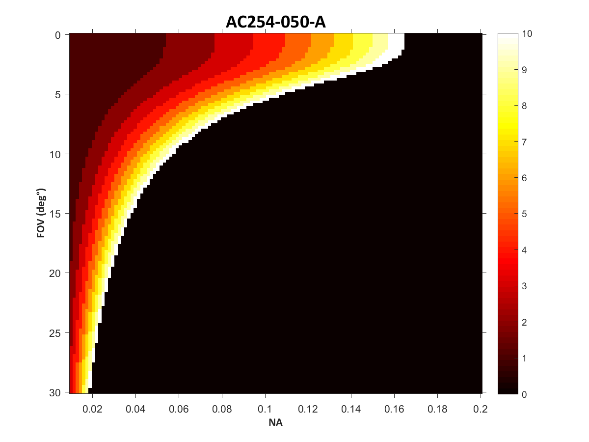

To find the coefficients pi,j, it was necessary to populate enough data to feed into the model to find a proper regression. I have then generated RMS spot radii of all Thorlabs achromat lenses by varying the NA between 0 and 0.2 and the FOV between 0 and 30° using an optical design software. I generated 128×128 points for each lens and pruned any RMS spot size that was larger than one hundred time the diffraction limit. I did this because I am not interested in strongly aberrated systems and I don’t care if I make error in estimating those as they will be crappy anyway.
Figure 2 shows the aberrations ratio with the diffraction limit with a limit of ten times the diffraction limit. As expected, a system with achromatic lens will have good performances with either a small FOV and a large numerical aperture, or a larger FOV at small numerical aperture. High-NA, High-FOV, systems are the most aberrated.
Figure 2 – Aberration vs diffraction limit for Thorlabs AC254-050-A lens
We could technically stop there because Figure 2 already gives you an approximation of the amount of aberrations for a given NA/FOV pair. However, it is not suited to quick automated calculations in Excel or the like and we would like to see if we can find a more compact way to represent Figure 2 behaviour.

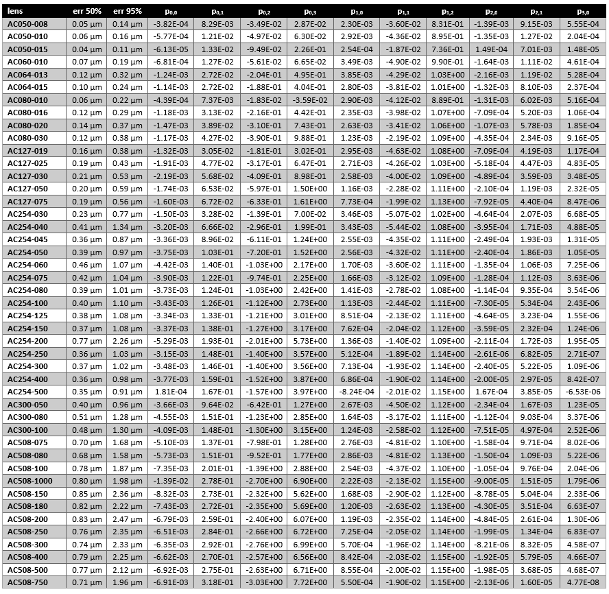

When we apply the regression of the N=3 model describes previously on each lens, we obtain the following coefficients:
From the table, you can see that the model correctly estimates the rms spot size of each lens quite well with errors clearly bounded below 3 µm. We could already use that model in place of the data sets like Figure 2 but it is still not as compact as we would like because we still have one model with a lot of coefficients for each lens.

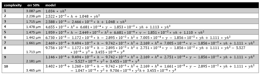

To figure out what would be the best model, I have generated sub-models by systematically activating and deactivating certain functions in the model set. With 10 functions, that yield a total of 210-1=1023 sub-models. Added to the original, full model, that yields 1024 models to try out.
For each sub-model I fitted each lens to find the pi,j values. At the end, we then have a set of <pi,j> values from which I pruned the outliers as defined by the Tukey fences. I finally took the median of each reminding values in the set as the overall pi,j value. I have then computed the fitting error on all lenses using the overall simplified model and regrouped the results by complexity of the sub-model basis using the number of functions in the basis.
I obtained the following results:
The best model has 6 functions in the basis and a median error of 1.442 µm but we can see that there is not much improvement by using more than 4 functions. I therefore decided to keep this last model which yields the results given at the top of the post:
Substituting y and h we get
with a median error of less than 1.5 µm on almost all of Thorlabs Achromat. By including the outliers, the median error grows to 1.9 µm. Interestingly, the simplest model (#1) seems to be unaffected by the inclusion of the outliers. So you can use the first model for quick hand calculation and still come up with something pretty close to the reality.
