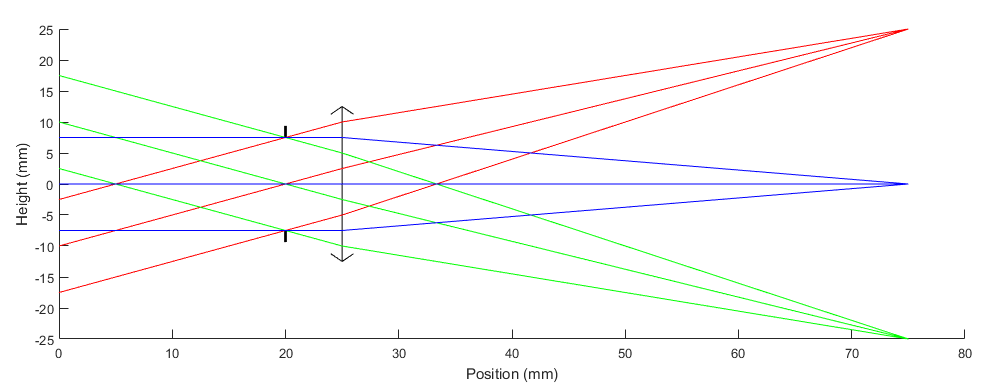

Figure 1 shows a lens with an aperture stop in front of it and three bunches of collimated rays passing through the system at different field angles.
Figure 1 – Simple lens with aperture stop
Although not all systems are as simple as the one of Figure 1, it helps seeing how the aperture stop controls the light rays entering the system. Note that all the different fields (red, green and blue) pass through the aperture stop and have their diameter limited by it.

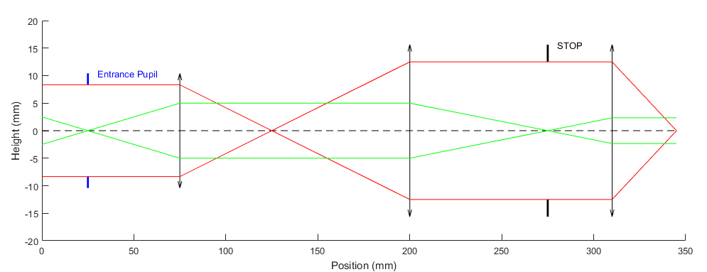

Figure 2 illustrates this with a more complex lens system.
Figure 2 – A more complex lens system with aperture stop and entrance pupil
If we ignore pupil aberrations, we are free to place the aperture stop in any of its conjugated planes which are called pupils. The entrance and exit pupils being therefore only two particular pupils of the system. Note that every lens in the system produces its own image of the STOP but the images are not always real and can also be virtual. When the image is virtual, it is not possible to place a physical aperture there.
Figure 2 shows a system that take collimated rays and image them on a sensor plane (at the right of the figure). The red rays simulate the image forming rays. The green rays passe through the center of the aperture stop and we can therefore locate pupils by looking for intersection of green rays. As you can see in Figure 2, the system possesses a real entrance pupil but no exit pupil because it is located at infinity. When the system entrance or exit pupil are at infinity, the system is said to be telecentric. Telecentric lenses have many advantages that I will cover in a later post.
The concept of entrance and exit pupils are extremely important in optical design because when you mate two optical systems together, you have to match their STOPs to avoid vignetting which is the clipping of rays. Since pupils are equivalent to STOPs because they are its image, matching STOPs means that the exit pupil of a system A must be super-imposed on the entrance pupil of a system B when you want to mate system A and B together. You should at least match the pupil positions but you don’t necessarily have to match the pupil diameter. The overall system aperture will be limited by the smallest pupil diameter but this may leave some room for positioning.
