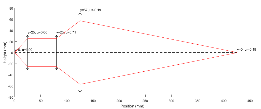

Figure 2 gives an example of paraxial raytracing through a system of thin lenses that was generated using Matlab. Don’t worry for the moment on how the lenses were chosen to achieve this specific behavior, we will cover that later.
Figure 2 – Example of paraxial raytracing
