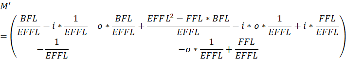

Let us take the generic systemM such that
and we will add two distances corresponding to the image and object plane positions
We find
for which we know that if we trace any ray that originates on axis (0,u) we should find an exit ray that is also on axis (0,u’) because of the imaging condition:
The condition is met if
for which we are not interested in the trivial solution u=0 and therefore we look for
After rearrangement we obtain
which is precisely Newton’s formula:
