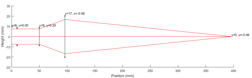

For instance, the system that has BFL=300 mm, FFL=40 mm and EFFL=135 mm consists of two thin lenses of focal lengths -37.7 mm and 65.5 mm separated by a distance of 46.1 mm. With a positioning tolerance of 50 µm and a tolerance of 1% on the focal lengths, we expect the final EFFL to be 135±6.3 mm, the final BFL to be 300±14.6 mm and the final FFL to be 40±2.8 mm. This is a relatively large error set when you compare to the 1% tolerance on the focal lengths! Either we can live with them or we will need some form of alignment procedure. The system is represented in Figure 1.
Figure 1 – Example system with air-spaced doublet

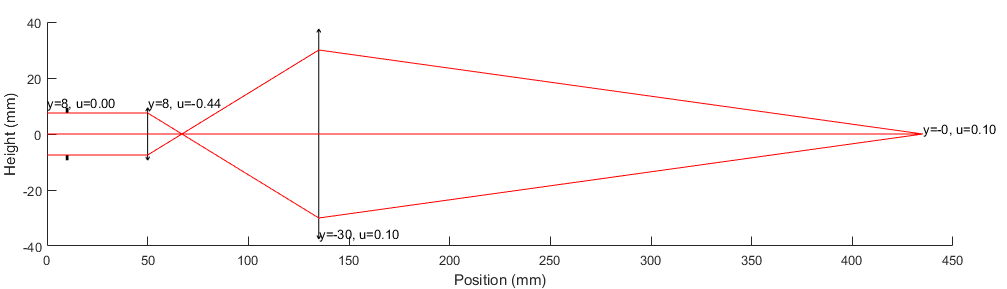

If we choose this time the same BFL and FFL but an effective focal length of 75 mm, we break the condition EFFL²>BFLFFL and have to flip the sign of the EFFL in the computations. This results in a ray that cross the optical axis as represented in Figure 2. Note that the negative sign is only a mathematical artefact due to the fact that the definition of the effective focal length is y/u’* and hence becomes negative when the ray crosses the optical axis.
Figure 2 – Negative equivalent focal length system
