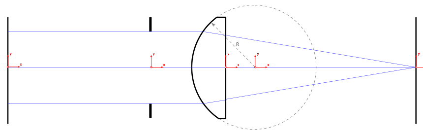

Figure 1 illustrates a simple raytracing with a STOP and a plano-convex lens. Rays emerges from an object plane, intercept the STOP then the first and second interface of the lens before reaching the image plane. Each surface (object, STOP, sphere, plane and image) have their own local space coordinates system represented here by xy arrows.
Figure 1 – Various local spaces in a raytracing problem
Note that when performing raytracing in a system, we usually express the starting and ending position in the local space of the first and last surface. That is, if rays emerge from an object plane to end at the image plane, the coordinates reported to the user will be in the local space of object and image plane respectively instead of in the world space coordinate system. This is purely for convenience of the user and does not change anything with the math.
