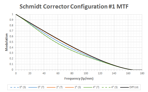

The MTF corresponding to the system of Figure 1 is given in Figure 2. We see that the system is close to diffraction limit up to 4°. The remaining aberration is Petzval curvature which produces a defocus proportional to field height. You may notice in Figure 2 that I optimized the focus position such that the field at mid-height is in-focus such as to limit the total defocus at 4°.
Figure 2 – MTF of the system in Figure 1
