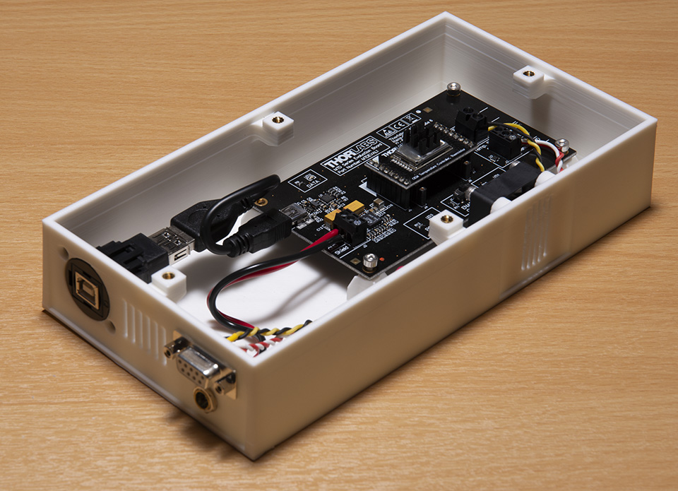

To avoid soldering anything, I relied on Thorlabs MTDEVAL1 board which comes with a very nice software to view the temperature and TEC settings (current/voltage). The software also allows for PID tuning as we have shown in this post. Since I wanted some kind of definitive solution, I made a housing in 3D printing and included a USB cable connector, power connector, TEC connector and a fan. The resulting box is shown in Figure 1.
Figure 1 – 3D printed box for the MTDEVAL1 board

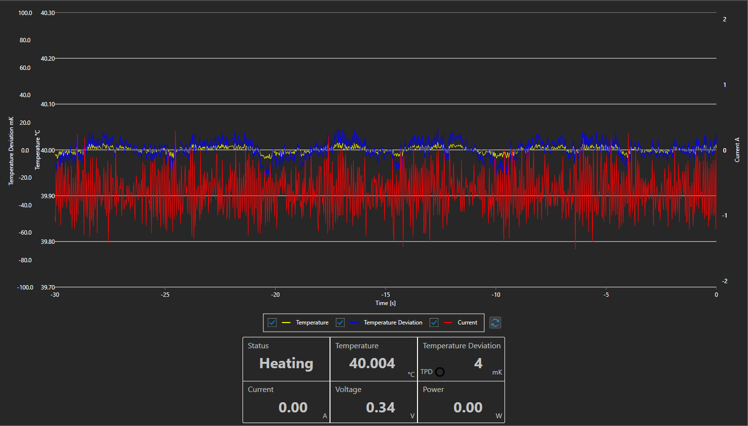

The complete system is functional and can drive the CPS532 laser at the 40°C set point that I discussed previously. Using the procedure for PID tuning, I found constants of P=2.340 A/°C, D=1.253 As/°C and I=1.092 A/°Cs with a cycle time of 30 ms. The system reaches the set-point within a few minutes and can recover quickly from thermal load variations. And while it’s difficult to check the exact temperature stability because the program does not export raw data for post-processing in either Excel or Matlab, we can still see in Figure 2 that the temperature is well stabilized within ±0.01 C° over a period of 30 sec. According to the MTD415T datasheet, this is at the temperature reading limit of the IC (datasheet says “better than 10 mK, typ. 2 mK”) and consists probably of a lot of electrical noise or read-out noise rather than actual temperature variations.
Figure 2 – Screenshot of operation using Thorlabs Software

First, the overall thing is extremely bulky. When you know that the MTD415T IC is about 2 cm2 and that the box is above 230 cm2, it feels like a lot of wasted space. This is mostly due to the size of the USB connector and the MTDEVAL1 board itself. While I used to be a big fan of these USB connectors, I realized that they’re clearly not made for small spaces as it was extremely difficult to squeeze the USB cable in the box without hurting the soldered USB connector on the MTDEVAL1 board.
Second, the MTDEVAL1 is relatively expensive for what you actually get (140 EUR ex-VAT). The board only contains a FT232 IC for USB communication and a voltage regulator(1). The board does not come with the TEC driver itself (you need to purchase it separately), nor USB cable, power supply or TEC cable.
(1) The initial MTDEVAL board was operating directly on 5V which could be fed to the MTD415x. When Thorlabs introduced the MTD1020T IC which can drive TEC up to 10V, they required to move the board to a 12V power supply, therefore including a voltage regulator to provide the +5V for the MTD415x variants.
A thermal analysis revealed that the fan was a good idea when putting the board in a closed box. Most of the heat was actually generated by the voltage regulator although the MTD415T chip itself went to ~35°C in natural convection conditions using a small heatsink on top of it. Using the fan, its temperature did not go beyond 30°C inside the box.

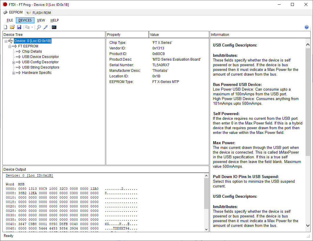

It appears that Thorlabs made its own variation of the FT232 Virtual COM Port driver and ships it with the Thorlabs brand on it. On the other hand, it’s still possible to access the FT232 eeprom data using the FTDI software FT_Prog as shown in Figure 3.
Figure 3 – EEPROM content of the FT232 IC inside the MTDEVAL1 board
From that data, I was relatively confident that I could directly hook-up a FT232RL board (such as this one) to the MTD415T by plugging the RX/TC lines (warning: FT232 TX must be connected to MTD415 RX line and vice-versa). The board can be accessed at 115,200 bauds through a program like Termite and commands sent as human-readable text (e.g.Te? to retrieve the current temperature). All the commands are very well described in the MTD415T datasheet.
A very good news is that there does not seem to be any protection in the Thorlabs Software at all because I was able to connect to my own FT232RL IC without any issue. The only thing I noticed was that the software does not display any name when enumerating the COM ports (while it does for the MTDEVAL1 board). I tried playing with the VID/PID and string descriptors in FT_Prog but wasn’t able to program the FT232RL EEPROM because I actually got a Chinese clone with no eeprom! (as confirmed by this post since my S/N was A50285BI). Conclusion: don’t buy your ICs on Amazon… I will have to repeat the experiment with an official FT232 IC.
Nonetheless, the conclusions of these tests are very positive as I was able to show that it’s very easy to hook up a FT232RL IC to the MTD415T and still get access to the Thorlabs software for PID tuning and modifications of the temperature set-point.
