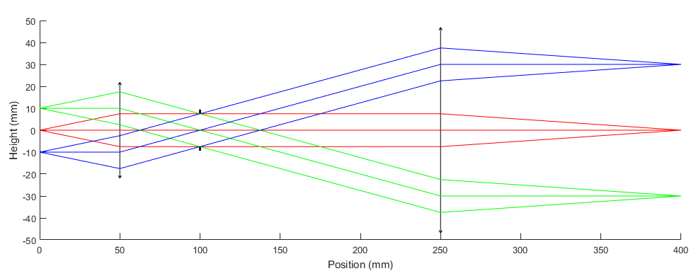

Rule #1 is interesting because if the input of the system corresponds to a pupil location (see part 3 for a discussion on aperture stop and pupils), we know that all chief rays will pass by coordinate y=0 (by definition of what a chief ray is).
Figure 1 illustrates this for a single thin-lens with the aperture stop placed at the FFL distance of the lens. See how all chief rays exit with u’=0.
Figure 1 – Example of a telecentric lens
Notice how all fields (red, green and blue bundles of rays) strike the image plane identically with an average angle of zero. This condition occurs as soon as the aperture stop or a pupil is located at the FFL distance of a lens system. It is called a telecentric system.
Telecentric systems are widely used in optics. They offer homogeneous illumination independent on the field position and they have orthographic projections meaning that the magnification does not dependant on the depth of the sample. They are widely used in optical metrology instrument but also became some sort of standard for DSLR cameras because the camera sensor behaves better when the rays strike them perpendicular. Edmunds optics has a nice webpage on telecentric lenses that you can check. I personally work with telecentric lenses every single day at the office!

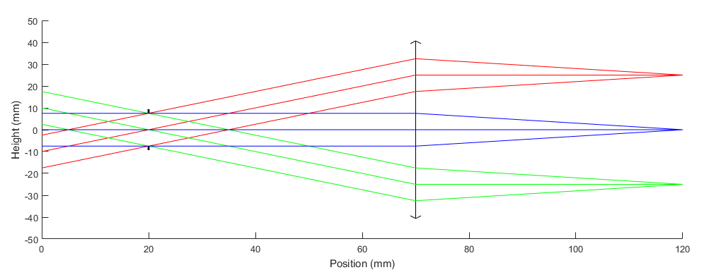

The system described by matrix M is known as a 4f system. The name originates from using two lenses of focal length f, each surrounded by air gap of f in both direction; the total length of such system being then 4f*. You don’t have to use the same focal lengths to call such system a 4f system however.
Figure 2 shows a simple 4f system with a threefold magnification. Note that here I’m using single thin-lenses but in practice you will use many more lenses to overcome aberrations.
Figure 2 – A simple 4f system with K=3
The system described by matrix M has however an odd behaviour: its C terms equals to zero which means it does not have an EFFL, or, more precisely, it would have an infinite one. By consequence, it does not have a back nor front focal length either even though its A and D terms are non-zero (recall that BFL=-A/C and FFL=-D/C from our former derivations). Because it has no focal lengths, it cannot be represented by our generic definition introduced before and belongs to a different class of systems: afocal systems.

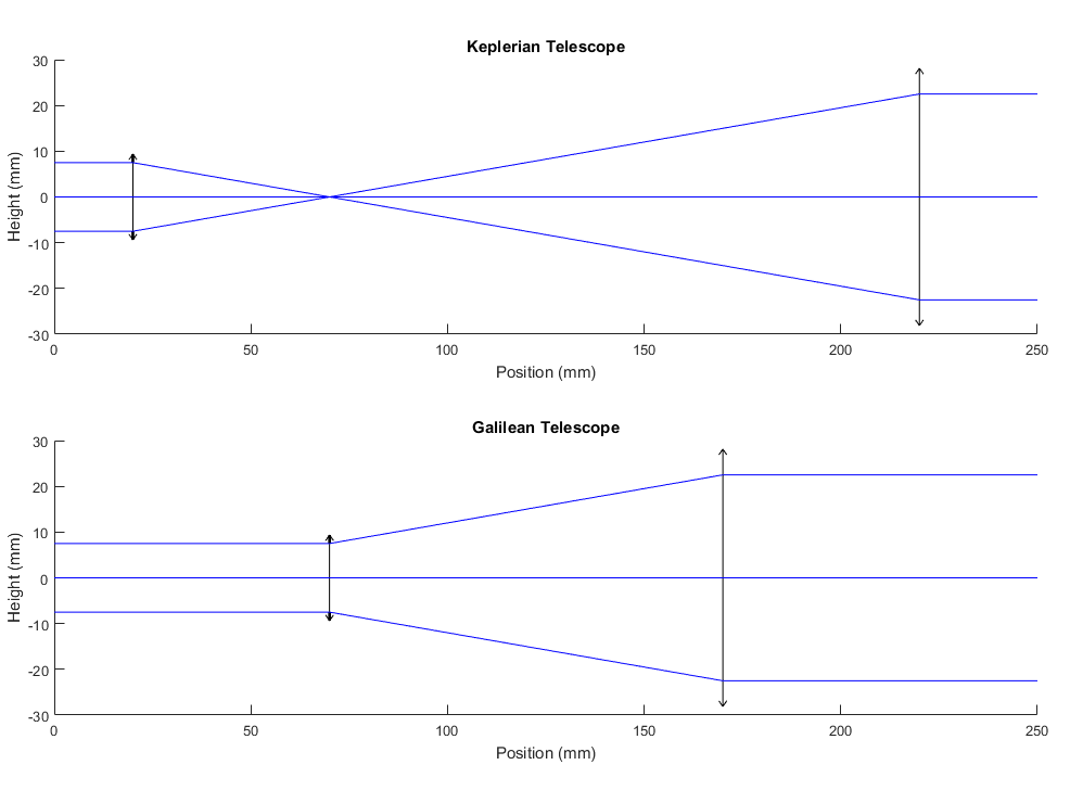

Such systems are however widely used as well to magnify slopes or expand beams. They are known as telescopes. In the inverting configuration (same EFFLs signs), they are referred to as Keplerian telescopes. In the non-inverting configuration (EFFLs of different signs) they are referred to as Galilean telescopes.
Keplerian telescopes form an intermediate image while Galilean telescopes don’t. This can have consequences in some systems, such as when enlarging a laser beam, as focusing a high-power laser at an intermediate image plane can lead to serious safety concerns. Galilean telescopes are also more compact than Keplerian telescopes because the back (or front) focal length is negative, thus shortening the distance between the two elements.
Figure 3 illustrates a Galilean vs Keplerian telescope with the same focal lengths of the sub-systems (here simple thin-lenses).
Figure 3 – Galilean and Keplerian telescopes
Finally, it is worth noting that telescopes systems do not generally include an aperture stop like the 4f systems or the clear aperture the lenses makes the aperture stop. This is very common in mirror-based telescopes where the larger mirror (called primary mirror) defines the stop of the system. Most of the time, the telescope is part of a more complex system that will define the stop position.
