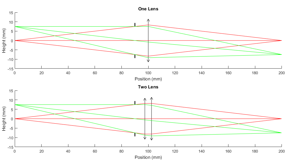

Figure 1 shows a raytracing plot of such replacement for a 1:1 imager system of a f=100 mm lens.
Figure 1 – Replacing a thin-lens by two thin-lenses
