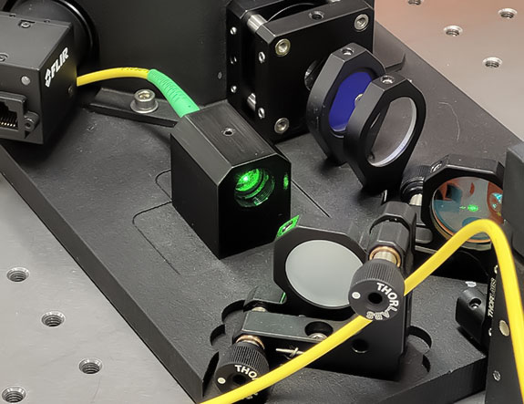

The modified spectrometer is shown in Figure 1.
Figure 1 – Fiber-coupled laser installed on the setup

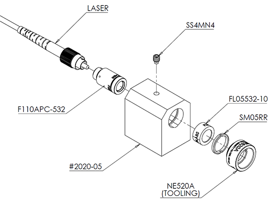

The complete system is shown in Figure 2. It consists of an external, fiber-coupled, laser, a collimator lens (F110APC-532), a filter (FL05532-10) and a neutral density filter (NE520A) in case the laser driver does not offer strong-enough attenuation for the alignment phase. All parts are held together using an update version of our former laser holder part of the Starter Edition. Note that this new part is both compatible with the Performance and Starter Edition.
Figure 2 – Assembly of the add-on

The collimation of the laser light from the optical fiber is done through the F110APC-532 collimator. Technically, it only consists of a lens in a stainless steel housing with a fiber connector at the other end. It is a relatively expensive part for what it does but it is also a standard solution for the collimation of fiber-coupled lasers so it’s usually a go-to during concept validation phases. Thorlabs propose the collimators for various wavelengths (here, 532 nm), fiber connector (here, FC/APC) and focal length. If your laser is not FC/APC, select the appropriate connector instead. Concerning the focal length, I selected one that would match the aperture size of the alignment frosted disk and I recommend that you keep the same. There is no adjustment for focus with these collimators but I never felt the need to do so up to now.

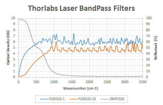

The filter was a bit more tricky to select because Thorlabs propose either a 1 nm bandpass or a 10 nm bandpass version. The 10 nm one is less half the price of the 1 nm filter but the blocking optical density is less (104.5 compared to 106). Also, the 10 nm filter has 70% transmission at 532 nm whereas the 1 nm filter has only 40% transmission. In the balance, we also need to account for DLMP550 dichroic mirror which will let some of the light pass through instead of being reflected to the sample port.
The responses of the various filters are given in Figure 3 along with the DLMP550 reflectivity.
Figure 3 – Filters Optical Density
In a commercial Raman spectrometer, we would like to select the sharpest cut-off possible for both the bandpass filters and the dichroic mirror. However, such sharp filters comes at a price roughly equal to the whole OpenRAMAN instrument! Some trade-off is then necessary but the question remains between the FL05532-1 and FL-05532-10 versions.
I chose to go for the 10 nm version mainly for the price and the transmission of laser light (70% vs. 40%). I was a bit afraid concerning the cut-off but I did not notice any leakage signal from the fiber in my experiments up to now.

Finally, concerning the housing (#2020-05/2 part), it is a refinement of the initial concept of the Starter Edition with a prismatic holder that can accommodate a 11 mm diameter cylinder so it is both compatible with the F110APC-532 collimator and the CPS532 laser from the Starter Edition. While the part can technically be made in SLS printing (provided you rework the front part for the retainer ring thread and eventually check the clearance for the filter), I chose to go for CNC metal machining this time. I sent the parts to XOMETRY who did a nice job for about $120 for two (was almost the same price for just one). If you chose to go the same way, be sure to select the fine grade (ISO 2768 fH) for the filter clearance because the dimensions on the drawing are outside of the standard ISO 2768 mK tolerance.
