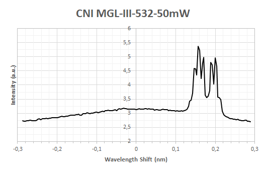

When placing the order for my CNI MGL-III-532-50mW I specifically asked to have a linewidth of 0.15 nm maximum. When the laser arrived, I measured the longitudinal modes distribution using my high-performance spectroscopy setup. The results are shown in Figure 1.
Figure 1 – CNI laser longitudinal modes distribution
Although the result complies with my request, I’m not 100% sure they understood the specification correctly because in the QC document they mentioned a 15 pm linewidth. So, if you choose to order a laser yourself, I would instead recommend to ask for “FWHM < 0.15 nm” just to be sure you are talking about the same thing.

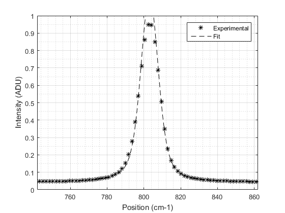

The performances translated directly to excellent peak widths in actual Raman spectra. Using a 15 µm slit, I obtained a peak width of 11.5 cm-1 for iso-propanol (major peak located at 800 cm-1 - uncalibrated). The results are shown in Figure 2.

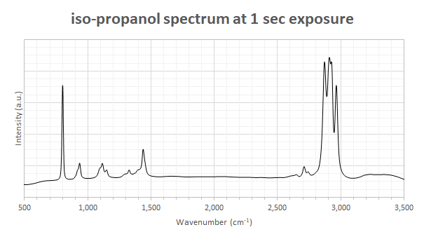

As an order of magnitude, at 1 second exposure I get plenty of signal for iso-propanol with a dynamic range of more than 10,000 for the main peak. You can see in Figure 3 that the spectrum is very clean despite the low exposure time used.

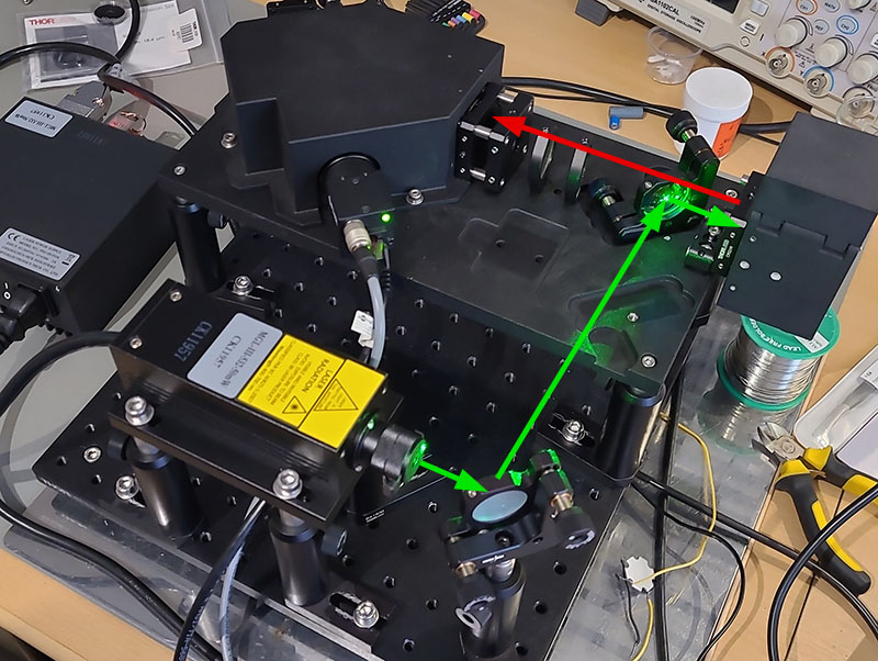

Finally, there is currently no modified baseplate to use the CNI laser. One will come in the near future (when I can find some time!) but until then you can simply fix the standard baseplate on a 300×300 mm breadboard like shown in Figure 4. While not optimal, it is stable enough to be used for experimentation.
