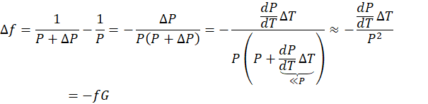

Imagine our barrel grows with temperature change ∆T by an quantity ∆x. For a telescope system, this means that we need the focal length of our telescope to change its back focal length by the same amount. In a thin-doublet, the back-focal length is equal to the effective focal length such that ∆f=∆x.
The change of power of the thin doublet is equal to
and the change in focal length is therefore
but we also have
such that
To create an athermal telescope, we need to select a glasses combination such that its total thermal power is equal to the inverse of the barrel coefficient of expansion.

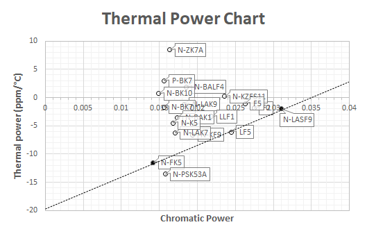

Historically, to select glass combinations that would yield a given thermal power, optical designers would use plots of glasses thermal power versus 1/V. The total thermal power of an achromatic thin doublet being given by the intersection with the origin axis of a line passing by the two glasses. This is illustrated in Figure 1 with a line passing by the glasses N-FK5 and N-LASF9 and interesting the origin at -19.49 ppm/°C.
Figure 1 – Thermal power plot
The method of Figure 1 is still in use today and most softwares like ANSYS OpticStudio provide thermal power charts to assist the optical designer.

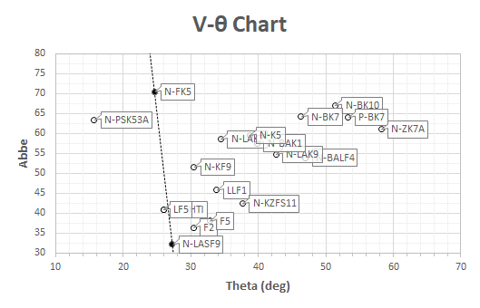

That being said, I estimate we can do better in today’s computer age. Indeed, since all glasses combinations yielding a specific total thermal power must be joined by lines intersecting the axis at that specific coordinate, we end up with radial lines centered on the point (0, GT) where GT is the targeted thermal power. Any glasses combination that are radial to this point are potential candidates. Also, we already know that the best candidates will be those with a large difference between their Abbe numbers, V.
I therefore propose the updated (V, θ) chart of Figure 2 with θ computed as
Figure 2 – V-θ chart
This time, we need to identify glasses that line up on a vertical (same angle relative to the (0, GT) point) and favor those that are the most separated as to keep a large Abbe number difference. For instance, in Figure 2, we see that the couple N-FK5 and N-LASF9 meet our conditions. We also see that N-KF9 and F2 would yield a closer thermal target match but that they are closer along the Abbe number axis so they would yield a doublet with probably more higher-order aberrations. The same conclusions can be drawn for other couples like N-K5 or N-LAK7 with N-KZFS11. An exhaustive search will yield a family a solutions that we could depart based on our requirements.

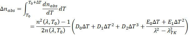

Last but not least, we are now left with the mathematical derivations required to compute the refractive index change with temperature that I discussed earlier. In practice, you don’t need to compute the value yourself but can rely on your optical design software to provide the values for you. I made a glass selection application that can compute the different thermal charts we have seen here. The derivations can be found in Schott’s TIE-19 document.
For each glass, manufacturers will measure how the absolute refractive index of the glass changes with temperature and express it as polynomial coefficients of the formula below:
with T0 the reference temperature (usually 20°C), ∆T the temperature increases relative to T0, λ the wavelength of the light, D0-2, E0-1 and λTK constants given by the glass manufacturer.
The refractive index change from T0 to T0+∆T is obtained through integration of the previous formula:
