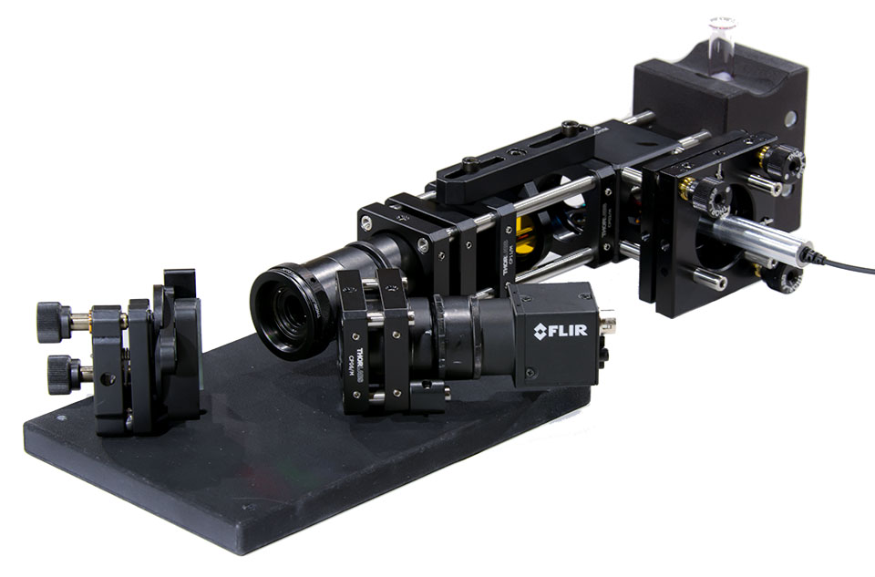

For those of you who can’t wait, a photography of the breadboard is given in Figure 2. Its working principle will be detailed in section 2 of this post. I will present experimental results in section 3 and discuss those results in section 4.
Figure 1 – Breadboard used for this post

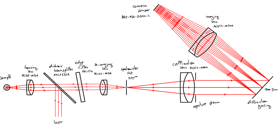

The overall idea of the Raman spectrometer setup is simple: we send a lot of excitation photons, collect the emitted photons only and send them to a high-resolution spectrometer to resolve the different vibrational modes. Although the principle is simple, the devil lies in the details here.
To exploit the Raman effect we need to use an excitation source of extremely pure monochromatic light with a high energetic density. We need a very thin emission line (monochromatic source) because larger source will produce blurred spectra due to the many possible excitation wavelength. If the excitation source is λe, the vibrational frequency ν and the Stokes emitted photon λ, we have the relation
So, if we measure λ experimentally, the only way to get a good estimation of ν is to have a precise, unique, value of λe.
Also, we will want to send as much light as possible to our spectrometer for the resolution of the various emitted photon frequencies. Because we will typically use a very small slit to achieve high resolution spectroscopy, all the photons emitted outside a zone of typically 10-20 µm will be lost. That means we need to focalize all of the excitation light source into a very small spot that will then be imaged on the spectrometer slit.
Hopefully there exist one type of light source that shares both of these attributes: lasers. Lasers can be extremely monochromatic and have very high power densities when focused with high quality optics. This second characteristic is what makes them very dangerous to the eyes!
The setup is schematized in Figure 2. It consists of a laser light source, a dichroic beam splitter that reflects wavelengths below 550 nm and transmit wavelengths above 550 nm, a focusing lens, a sample vial containing the liquid to measure, an edge filter, an imaging lens, and a spectrometer containing itself a slit, a collimating lens, a diffraction grating, another imaging lens and a camera sensor.
Figure 2 – Setup schematics
I will now detail each group of elements and the importance they play in the experimental setup.

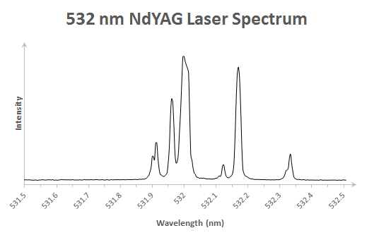

I am currently building a laser driving but it is not finished yet and in the meanwhile I am using a Thorlabs CP532 DPSS laser. I had already characterized its spectrum in a former post and obtained the result of Figure 3. It has several actives modes which will be the limiting factor for the resolution of this breadboard. It is also not so powerful with a power of about 4.5 mW.
Figure 3 – Laser spectrum

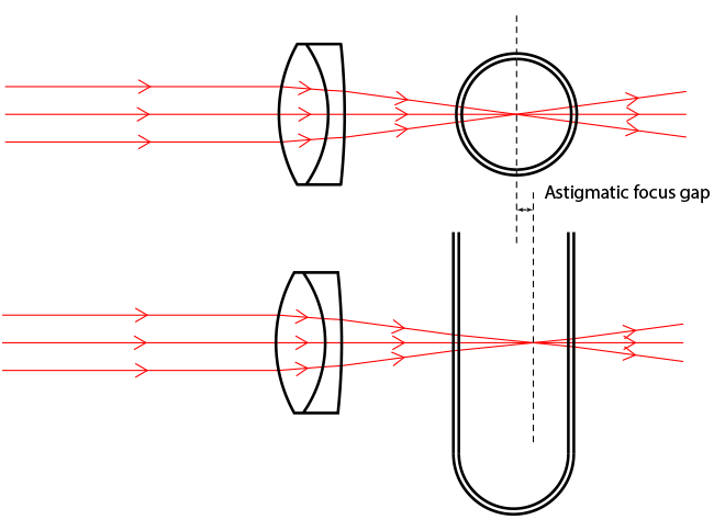

Concerning the vials, most people use a square cuvette. I did try this solution in a first place but I quickly changed my mind because the glass of the cuvette tends to adsorb fluorescent chemicals which will produce a background blur on top of your spectra. Because glass cuvettes are expensive (typ. ~100€) you will be tempted to reuse them as much as possible. This is where you start adsorbing all sort of fluorescent compounds. After some unsatisfactory tests, I decided to switch to cheaper test tubes with narrow 0.5 mm glass walls. If the tube start showing some fluorescence, I can just throw it away (or re-use it for other purposes than Raman spectroscopy). Since they are about 0.10€ per tube, it is an economically viable solution. In practice, I re-use the same tube several time and clean it with distilled water every time after recording a spectrum. I change it only for difficult measurements or when I see some fluorescence building up in the spectra.
However, going from a square cuvette to a cylindrical test tube is not without its problem. Along one direction the light will not be deviated because it arrives nearly perpendicular to the wall (no refraction occurs then). In the second axis however, refraction occurs which alters the focusing property of the optics. This is represented in Figure 4. Please note that the schematic is the actual raytracing, not a dramatization of the effect!
Figure 4 – Astigmatism in laser focalisation
This is unfortunately a problem because the focalisation spot will be spread between the sagittal and meridional focci. The whole volume will generate the inelastic scattering but each point in this volume will generate rays in all directions, leading to a blurred spot in the spectrometer slit plane.
One way to circumvent this would be to place a negative cylindrical lens of about the same power as the test tube. However, since the power of the test tube will change depending on the liquid being measured, only an approximation can be made. This is something I am planning to implement in an upgraded version of the spectrometer.

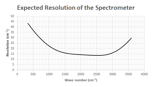

The spectrometer is the part of the setup responsible for separating the various wavelengths composing the Raman spectra. I have already dedicated extensive posts on how to build and align a spectrometer which you can read for all the details. I will therefore directly jump to the selected design parameters.
Keeping the same spectrometer layout as in my previous post, I got the best results using a 1200 lines/mm grating with a blaze angle of 17° 27’ (Thorlabs GR25-1205), 50 mm 1” achromats (Thorlabs AC254-050A-ML) and a slit of 20 µm. The angle between the two arms of the spectrometer is 40° and the grating is tilted by about 42.5° relative to the input beam to create a span of 540-660 nm (330-3600 cm-1) with the camera FLIR BFLY-PGE-31S4M-C. A 12 mm aperture was put in front of the collimating lens to limit the numerical aperture to 0.12 or f/4.
When aligning the imaging optics on the centre spot (as I did in my previous post), the intrinsic resolution of the spectrometer is expected to go from 0.35 nm on the centre to 1.3 nm on the edge of the sensor. This translates into a resolution going from 35 cm-1 at 500 cm-1 to slightly less than 10 cm-1 at 2000 cm-1 before it increases again at 2500-3000 cm-1. Taking into account that the laser I am using has a bandwidth of about 0.4 nm, the resolution is expected to decrease to an average of 20 cm-1 between 500-3000 cm-1 as can be seen in Figure 5.
Figure 5 – Expected Resolution of the Raman spectrometer
Please note that the resolution figures given here are very approximates at the moment since I used my shorthand formula to predict RMS spot size and that I inferred the FWHM of the system PSF from the RMS spot size and slit width, neglecting any diffraction effect. Consequently, the resolutions given here are more of an order of magnitude than a precise theoretical estimation.
I will cover a more precise resolution evaluation in section 4. Also, I am currently working on a better imaging system for this spectrometer that should achieve a ~15 cm-1 resolution on the complete spectrum. Stay tuned for updates as this is going to be a big piece too!

The complete setup was assembled as shown in Figure 1. I will create a dedicated step-by-step article on how to assemble and align the setup later but the main steps are:

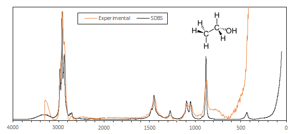

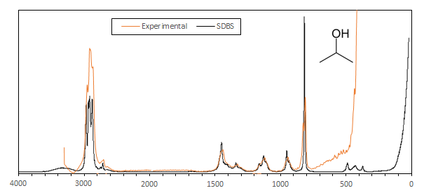

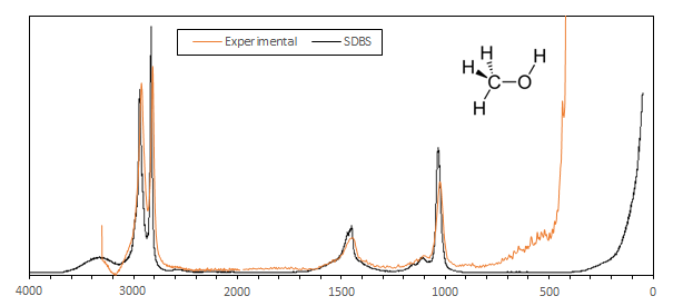

The spectrum of three common alcoholic solvents are given in Figure 6 (methanol), Figure 7 (ethanol) and Figure 8 (iso-propanol). They are the three most simple alcohols in organic chemistry and each one has one more carbon atom than the previous one. I chose them because they are simple molecules that will help draw the resolution properties of our spectrometer.
Figure 6 - Methanol spectrum
Figure 7 – Denaturated ethanol spectrum
Figure 8 – iso-Propanol spectrum
As can be seen in Figure 6, methanol has two large peaks in the 3000 cm-1 region (in-phase and out-of-phase -CH3 stretches). These peaks are 90 cm-1 apart and are clearly resolved. The two other peaks are found at the correct location with the right shape. We also see that the spectrometer does not detect anything below 600 cm-1. The sharp peak at 1050 cm-1 has a FWHM of 34 cm-1.
Ethanol, in Figure 7, makes the spectrum a bit more complex. The structure at 3000 cm-1 becomes more compact and the three peaks distant of 46 cm-1 and 51 cm-1 are barely defined. The two peaks at 1097 cm-1 and 1053 cm-1, distant of 44 cm-1 are also at the limit of resolution. Interestingly, the peak at 900 cm-1 is doubled with a separation of about 15 cm-1. I will come back to this later.
Iso-propanol, in Figure 8, make us draw the same conclusions. Its peaks at 3000 cm-1 are distant from 34 cm-1 and 29 cm-1 and are barely resolved too, but can still be distinguished.
This is in line with the predicted resolution of about 30 cm-1 although, for some reasons, the resolution in the ethanol spectrum is a bit less satisfactory. This might be due to the fact that I used denatured alcohol instead of pure one and that some other compounds are messing with the -CH3 stretch region.

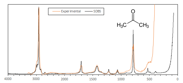

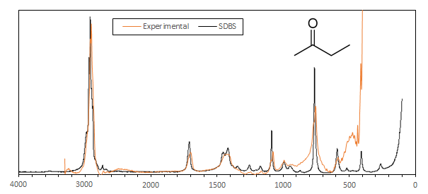

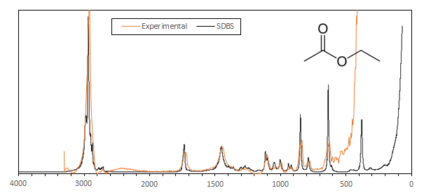

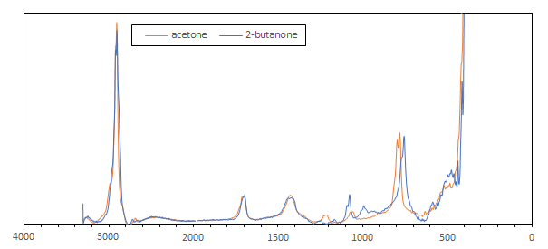

I also recorded the spectra for nitromethane (Figure 9), acetone (Figure 10), butanone (methyl-ethyl-ketone, Figure 11) and ethyl acetate (Figure 12). I will not detail them further as they share the same conclusive evidences as the previous figures. As a side note, ethyl acetate (Figure 12) was my very first Raman spectrum :-) I was just so excited when I saw all these little peaks appearing in front of me!
Figure 9 – Nitromethane spectrum
Figure 10 – Acetone spectrum
Figure 11 – Methyl-Ethyl-Ketone (MEK) spectrum
Figure 12 – Ethylacetate spectrum

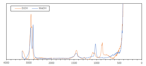

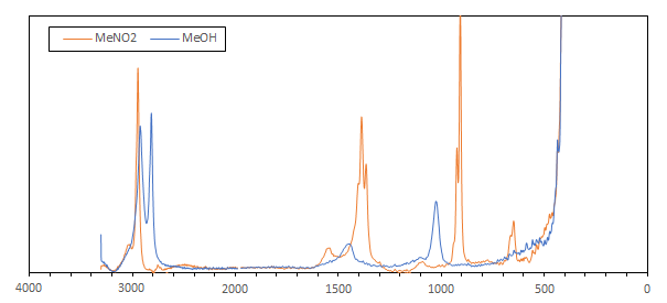

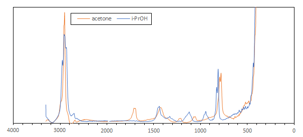

When looking at the previous results, I was extremely pleased to see that some substances that are chemically extremely close could be distinguished in their Raman spectra even when the change was in the carbon chain only. An example is given in Figure 13 with the spectra of acetone and methyl-ethyl-ketone which only differs by one methyl (-CH3) group. A similar result is obtained with ethanol and methanol in Figure 14. Substances that differ in oxidation stages such as acetone and iso-propanol can also be distinguished easily, as can be seen in Figure 15. Substituting groups has even more impact on spectra as can be seen in Figure 16 with a comparison of methanol and nitromethane.
Figure 13 – Acetone vs. MEK spectra
Figure 14 – Ethanol vs. Methanol spectra
Figure 15 – Acetone vs. iso-propanol spectra
Figure 16 – Methanol vs. nitromethane spectra
This is really what makes Raman spectroscopy so powerful for any chemist and why I am convinced that we are making a big step forward with this DIY setup. And since the results were promising I also tested some solid substances dissolved in water. Urea at ~50 mg/5 ml has shown a characteristic peak at 1000 cm-1 with a SNR of 1:5 which was just enough to bring it out of the noise floor. The result is shown in Figure 17. This is not so bad at all considering that this spectrum was recorded on a dilute solution with a 4.5 mW laser and 1 minute exposure! It opens up new doors even further…

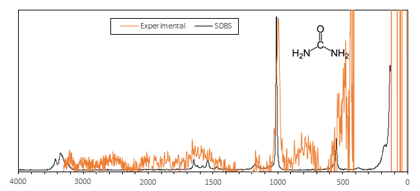

Figure 17 – Dilute urea solution

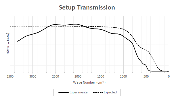

The first thing we notice on the different spectra of section 3 is that the setup is blind below 600 cm-1. This comes from the filtering of both the dichroic beamsplitter and the edge filter. I did not test them separately but I made a recording of a white LED through the system and got the results of Figure 18.
Figure 18 – Setup Transmission
The behaviour between 2500 and 3500 cm-1 is not important because it is probably due to a decrease in the LED intensity at high wavelengths. What is more important is the gap between the expected and experimental values at the small wavenumbers. The curves are shifted by about 200 cm-1 which does not allow any access to the 300-600 cm-1 range which is important for the characterization of halogen compounds. I think the effect is due to the edge pass filter which was not tilted with the appropriate angle and hence cut at a too-high wavelength. I am not very satisfied with this value and I will try to improve this later. By the way, 600 cm-1 corresponds to about 550 nm which is the nominal value of the edge filter.
Also, the setup goes from -91 cm-1 to 3350 cm-1 which is not optimal. A better alignment of the grating would expand a little bit the range on the higher wavenumbers. By adjusting the grating angle, it should be possible to cover a range of 300-3570 cm-1 which is just perfect for Raman spectrometry. A slightly smaller focal lens could reach 4000 cm-1 which might be needed in some application but will be done at the expense of resolution.

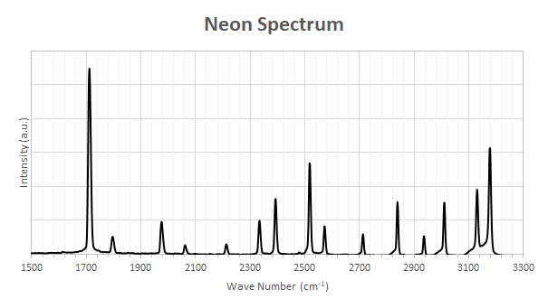

To break down experimentally the resolution between the contribution of the spectrometer and the laser, I first used a Neon spectrum to estimate the resolution of the spectrometer itself. The results are shown in Figure 19.
Figure 19 – Neon Spectrum
There is no peak in the Neon spectrum below the wavelength corresponding to 1700 cm-1 in the Raman spectra so I cannot estimate the behaviour below that value. On the other hand, I have found the spectrometer resolution to be about 0.4 nm up to ~2700 cm-1 where the peaks start to suffer from asymmetric broadening. This is actually well in line with the result predicted by the RMS formula which predicted a 0.4 nm resolution in the range 1500-2700 cm-1. The formula also predicted the resolution to drop after 2700 cm-1 to reach 0.85 nm at 3300 cm-1.
Although this explains the ~30 cm-1 resolution in the high wave number range, it does not explain anything in the medium wave number range, especially the doubling of the peaks.

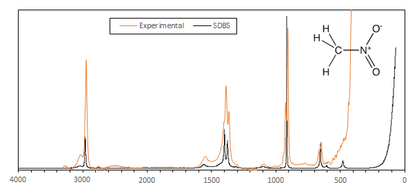

The simulated Raman spectrum of nitromethane is shown in Figure 20 together with the experimental measurement. The spectrum consists of two peaks at 1402 cm-1 and 1376 cm-1 as well as two other separate peaks at 918 cm-1 and 656 cm-1.
Figure 20 – Simulated nitromethane spectra vs. experimental

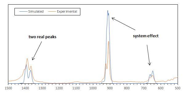

The simulated spectrum is extremely close to the experimental one and even manage to predict the doubling of the peak measured experimentally at 918 cm-1 and 656 cm-1. The simulations also predicted the small shoulder that can be seen near the 918 cm-1 and 1402 cm-2 peak.

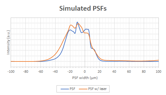

Simulations also teaches us that the peak doubling effect does not originate from the multiple modes of the laser but from the spectrometer PSF itself. The PSF with and without the laser effect are shown in Figure 21 for the 918 cm-1 peak. The doubling already appears (even tripling!) in the original PSF.
Figure 21 – Simulated PSF with and without laser effect
The poor PSF of the system is directly linked to the relatively simple design I used. The only way to achieve better resolution will be to work on the optical formula for the imaging lens.
