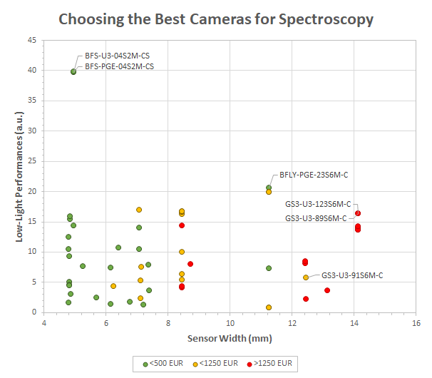

From these two criteria (sensor size and low-light performances), I made the plot of Figure 1. Cameras were split into three price colour groups (<500 EUR, <=1250 EUR and >1250 EUR) for easiness of reading. All prices are given ex-VAT.
Figure 1 – Choosing the best camera sensors for spectroscopy
I further pruned the list of cameras by selecting only the dominating entries. An entry is said to be dominating if it dominates all other values. And because this is so far a definition loop, a value is said to be dominated if there exist any other entry which has all its criteria better or equal to the value being dominated. So, for instance, the camera BFS-U3-04S2M-CS is a dominator because there exists no camera that has better detectivity. Camera BFLY-PGE-23S6M-C is also a dominator because there exists no camera that is at least as good in both its sensitivity and its sensor size in its price category.
I have annotated the dominators in Figure 1 with the camera name. Some of these cameras are available in both their GiGE (PGE) versions or their USB3 (U3) version. The final list therefore contains only five cameras that ought to be examined: the BFS-PGE/U3-04S2M-CS, the BFLY-PGE-23S6M-C, the GS3-U3-91S6M, the GS3-U3-123S6M-C and the GS3-U3-89S6M-C.
