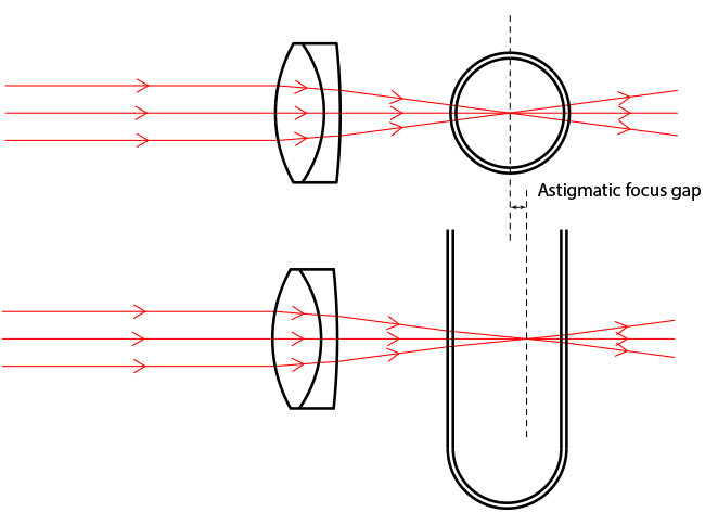

The astigmatism in the initial holder originates from the cylindrical shape of the test tube which acts like a cylindrical lens. When the laser is focused, the vertical and horizontal rays have different focus positions as represented in Figure 1. In practice, the light is focalised into a large volume which a waist that lies in-between the two focal plane and was about 180 µm large (RMS spot size). By the way, I am using here test tubes because glass can easily adsorb fluorescent compounds that quickly ruin your spectra and that they are much cheaper to replace than quartz cuvette (0.02€/pcs vs. 30€+).
Figure 1 – Astigmatism in initial cuvette
Astigmatism is a problem for Raman spectroscopy because the molecules in the vial scatter light back in all directions which results in a large blurry spot imaged onto the spectrometer slit. This can be directly confirmed by the experimental images where the slit is visible as ~50×4 pixels square image instead of a small disk. About 90% of the scattered light collected by the optics is lost that way in the original spectrometer setup.
An improvement of the setup would be to remove the astigmatism in the cuvette focusing mechanism such as to provide a tighter spot on the slit and so a higher yield of photons actually injected into the spectrometer. This is exactly what this upgrade is about.
To compensate the astigmatism of the test tube, I inserted a negative cylindrical lens between the vial and the doublet lens. The distances were adjusted to yield the tightest possible spot. My optical design software predicted a 9 µm RMS spot size which would result in a 9-fold improvement of the signal intensity at best since the slit integrates the signal vertically.

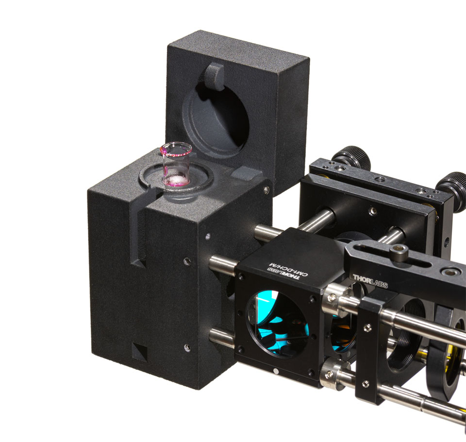

To hold everything I designed a new 3D-printed cuvette holder. I also took the occasion to add further improvements such as a foldable cap, the possibility to add an interlock to switch off the laser when the cap is open and a beam-dump behind the sample. The new cuvette is shown in Figure 2 and can be downloaded here. It is mandatory to print them using SLS technology. I paid 41.35€ for the printed parts to which you will need to add a few bucks for the helicoils, set screws and so on.
Figure 2 – New cuvette holder
The lenses are placed on mechanical tolerance and no adjustment is foreseen. They are held in place by M4 nylon-tap screws. The cage rods are fixed using M3 DIN913 set screws. A DIN7 3x50 m6 pin provides the axis for the cap folding mechanism.

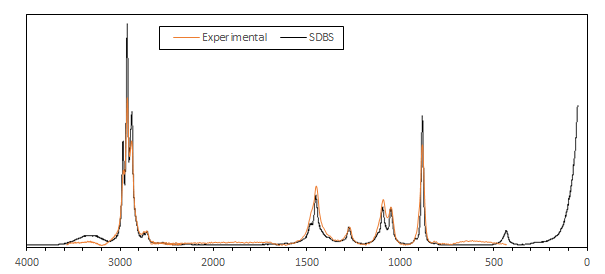

A spectrum of ethanol is given in Figure 3.
Figure 3 – Ethanol spectrum, 4.5 mW 1 min. exposure
The noise was estimated from the 1800-2000 cm-1 part of the spectrum and the SNR of the peak near 1500 cm-1 computed as 1:1035. The FWHM of the peak near 900 cm-1 is 20 cm-1 and the three peaks at 3000 cm-1 distant by 46 and 51 cm-1 are clearly defined. The spectrometer range was not changed by this upgrade and still covers the 500-3600 cm-1 region.
