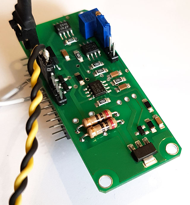

The driver can be bought from Thorlabs just a little under 150€ (ex-VAT) and Thorlabs also offers a power supply (LD1255-SUPPLY, 110€ ex-VAT) which makes your laser driver for a little bit above 260€. You will have to add some relatively standard components like a SUB-D9 connectors to plug into the LDM21 block and also a toggle switch to connect/disconnect the DISABLE pin to ground. The circuit with the extra wiring is shown in Figure 1.
Figure 1 – Thorlabs LD1255R laser driver
Thorlabs strongly recommend to disable the LD when switching on/off the power supply to avoid damaging the LD with transient voltages. Note that using the DISABLE pin does not stop the current from flowing but rather redirects the current through a transistor that short-circuit the LD. This has consequence for what I will discuss later in this post.

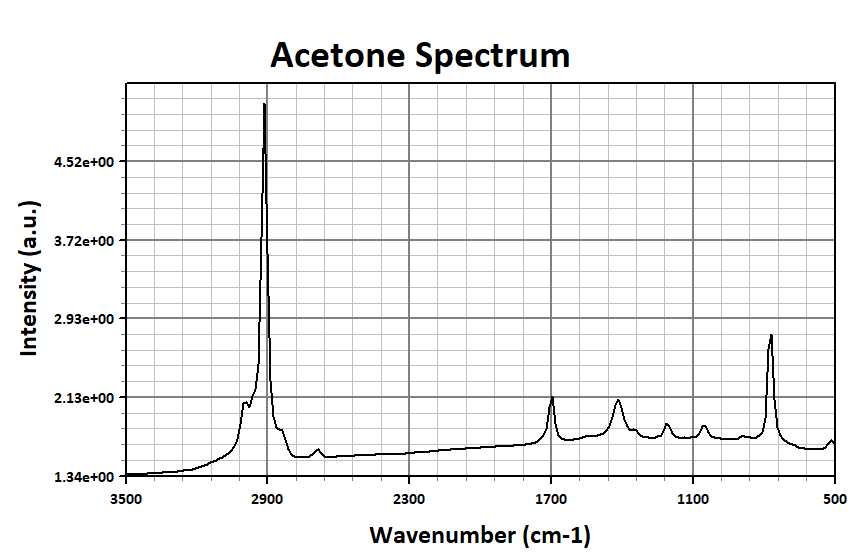

At maximum power, it required 8 sec exposure time to take the acetone spectrum shown in Figure 2. This is better than the Starter Edition performances (and with higher spectral resolution too!) but still well below the typical ~1 sec required when running the LD at higher currents using the LDC205C.
Figure 2 – Acetone Spectrum

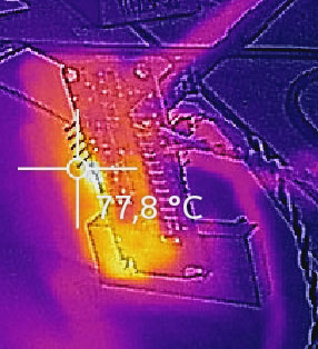

A quick look at the circuit itself shows that the driver uses very simple circuitry that is priced ridiculously high for what it is. For instance, the component that can be seen in the front of Figure 1 is most probably a simple linear voltage regulator used to smooth out the voltage by lowering it to something like 5-7V (minimum required input voltage is 9V so it makes sense). The big problem with linear regulators is that they dissipate a massive amount of heat that is proportional to both the current and the voltage drop which can be huge. This makes the circuit burning hot after only 1-2 minute of operation as can be seen in Figure 3.
Figure 3 – Massive heat dissipation in Thorlabs LD1255R
Thorlabs LD1255R driver is clearly not suitable for driving high loads for extended period of time. Running the circuit for more than a few minutes poses major risks of dramatic failure like burnt components or components desoldering from the board. You don’t want any of that to happen because you have no idea what such kind of failure may do to your LD that is connected to this circuit.

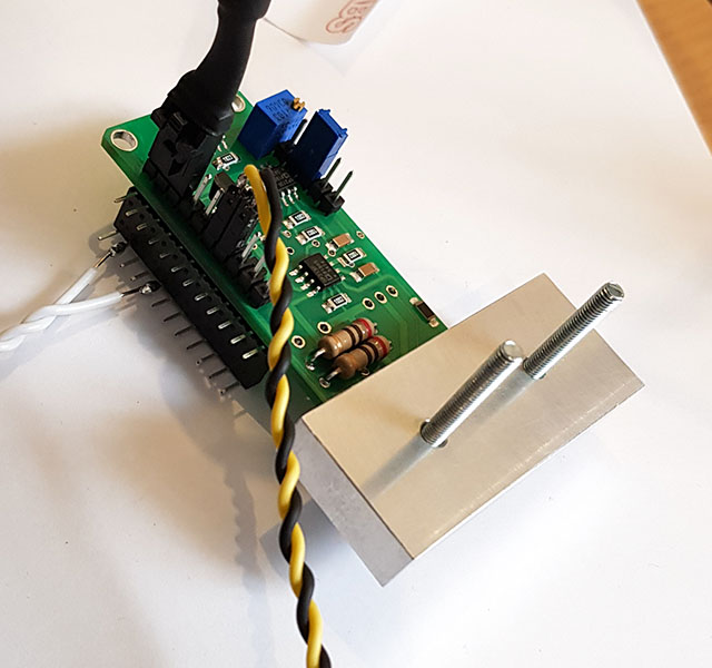

In an attempt to mitigate this problem, I machined a 20×50×10 mm block of aluminium with two M3 threaded holes to act as a heat sink to protect the (supposed) linear regulator. I added just a bit of thermal paste on the component for good heat transfer between the two. Be careful not to spill thermal paste on the leads of the component that would then short-circuits. A better alternative would have been to use thermal pad but I did not have some available at the moment. Note that the screws are tighten just enough to maintain contact between the component and the aluminium block. A picture is given in Figure 4.
Figure 4 – Custom heat sink to help heat dissipation
The custom heat sink helped lowering the temperature of the board to somewhat acceptable temperature but after 15 minutes of operation the circuit was barely touchable and the aluminium block had probably reached 60°C.

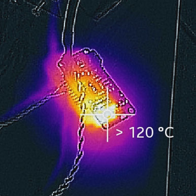

Further analysis revealed that there are still over-heating components on the back of the board this time as can be seen in Figure 5. I was able to measure temperature above 120°C there too but I was not able to take a proper picture to show it here (I miss an assistant to hold both the burning hot circuit and the FLIR camera).
Figure 5 – Still some strong heat dissipation in the circuit
The component that produce the heat observed in Figure 5 is a small 2-leads SMT component that I believe might be the current sense resistor of the circuit.

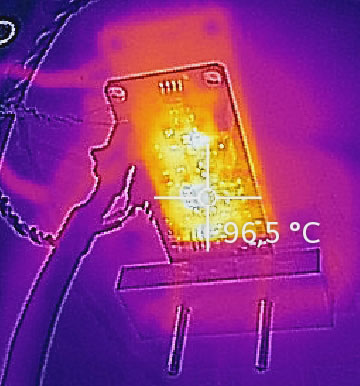

Even the front of the circuit with the op amps show strong heat dissipation. This is illustrated in Figure 6.
Figure 6 – More over-heating components…
