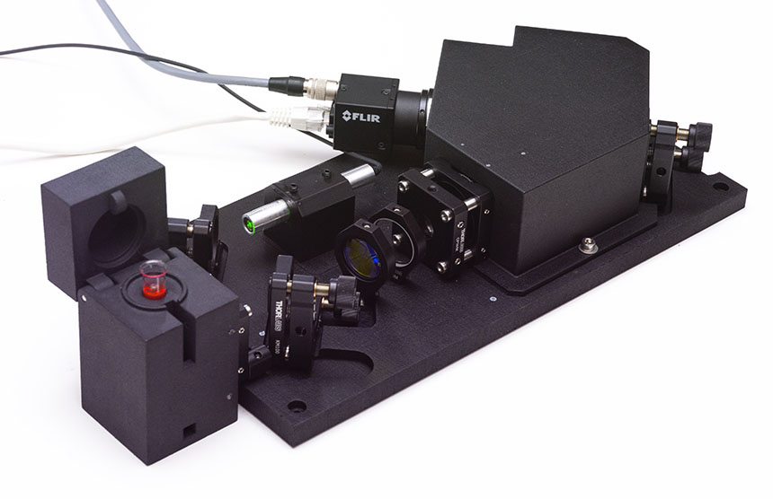

Lots of things have been moving in one year since I launched the initial breadboard version of the OpenRAMAN spectrometer and today I am really glad to announce the official first prototype of OpenRAMAN: OpenRAMAN Starter Edition. The spectrometer with the standard cuvette is shown in Figure 1 and the full assembly instructions are available at the companion website.
Figure 1 – Photography of the OpenRAMAN Starter Edition with the standard cuvette

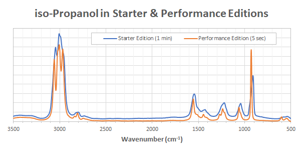

Figure 2 shows typical spectra obtained with both the starter and the performance editions to help you make a choice which edition is best for you.
Figure 2 – Spectra of iso-propanol taken with both the starter edition and the performance edition of the spectrometer

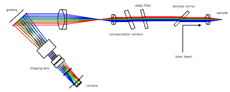

The optical design is given in Figure 3 and it basically is the design of the breadboard version with the imaging lens upgrade plus some technical improvements embedded on a custom base plate to ease up alignment.
Figure 3 – Optical design for the OpenRAMAN Starter and Performance editions
One of the first improvement that I gained from the former version was that there was a lack of freedom in the steering of the laser beam into the cuvette. The dichroic beamsplitter was fixed at roughly 45° and only the incoming beam angle could be modified. It was therefore extremely difficult to get a beam entering the cuvette perfectly straight and my last attempts with the breadboard was to include an expensive translation stage to get the job done. Here, I therefore swapped the fixed dichroic beamsplitter by one mounted on a kinematic base (Thorlabs KM100). These bases are cheap enough and provide an extremely accurate laser steering at low cost. Also, I developed an alignment method to get the laser perfectly straight in regards to the optical axis. The method is described on the companion website so please have a look at there too.
As a minor improvement, I also decided to replace the edge filter by the premium version of the same filter. It is a bit more expensive but it offers better performances overall so I think it worth the extra expense. You don’t have to apply this fix if you are a bit tight on money (extra 50€).

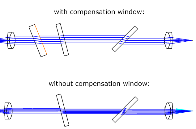

Last improvement was to include a flat transparent window. This is not a joke and it actually does something! When the beam with the Raman signal goes back into the system in its collimated state, it is laterally shifted to the side by the refraction in the dichroic beam splitter and the edge filter. Orienting the edge filter the other way with a negative angle relative to the dichroic beamsplitter compensate this effect but not does not completely cancel it. The consequence is that the collimated beam will hit the condensing lens a bit on the side which will create a cone of light that is not centred relative to the optical axis of the spectrometer. When working on liquid, this has little effect because the source is more or less Lambertian and thus create a cone of light that completely fills the numerical aperture of the system. However, when working on larger particles the effect might become visible and some light/resolution will be lost due to this offset position. The compensation window corrects for this effect by shifting the beam back on the optical axis before it hits the condensing lens. This is represented in Figure 4. It is a small effect that you can potentially neglect when working on liquids but I recommend keeping it in place unless you are really tight on money (the window with the support costs about 100€).
Figure 4 – Effect of the compensation window
That is all for the optical design since the rest was already described in the post about the breadboard version. I strongly urge you to read it if you haven’t yet because it describes the limitation of the system in terms of resolution and all other small (but important!) effects of the laser, the grating and so on.

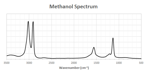

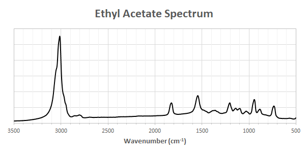

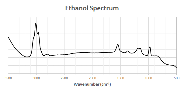

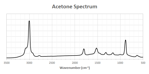

If you are wondering what type of spectra you can expect with the setup, just take a look at Figure 5 to Figure 8. It is all kind of common solvents that you can easily get in a lab. All these spectra are raw measurement without any type of baseline subtraction. Also please note that the wavenumber axis is only partially calibrated for these measurements.
Figure 5 – Spectrum of acetone, 1 min exposure
Figure 6 – Spectrum of ethanol, 1 min exposure
Figure 7 – Spectrum of methanol, 1 min exposure
Figure 8 – Spectrum of ethyl acetate, 1 min exposure
