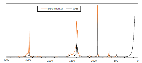

An experimental spectrum of nitromethane along with SDBS data are given in Figure 1. Each of the peaks are clearly resolved with a resolution very close to the one of SDBS.
Figure 1 – Nitromethane spectrum compared to SDBS data

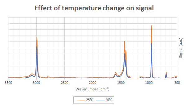

I also measured the effect of temperature on signal strength. The results are shown in Figure 2 with a nitromethane spectrum. The temperature effect is relatively large with a 9.67%/°C. Achieving a 1% change would therefore require a temperature stability of 0.1°C.
Figure 2 – Temperature effect on signal strength

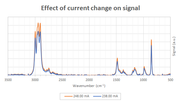

Finally, I also checked the effect of current change on signal strength. The results are shown in Figure 3 with an iso-propanol spectrum. The spectrum is a bit noisier than the previous one because I did not care measuring a blank spectrum first which tends to correct some hot/cold pixels effects. At 22.50°C, the system is not so sensitive to current change with only 1.65%/mA. Achieving a 1% stability would therefore require a 0.5 mA current stability.
Figure 3 – Current effect on signal strength
