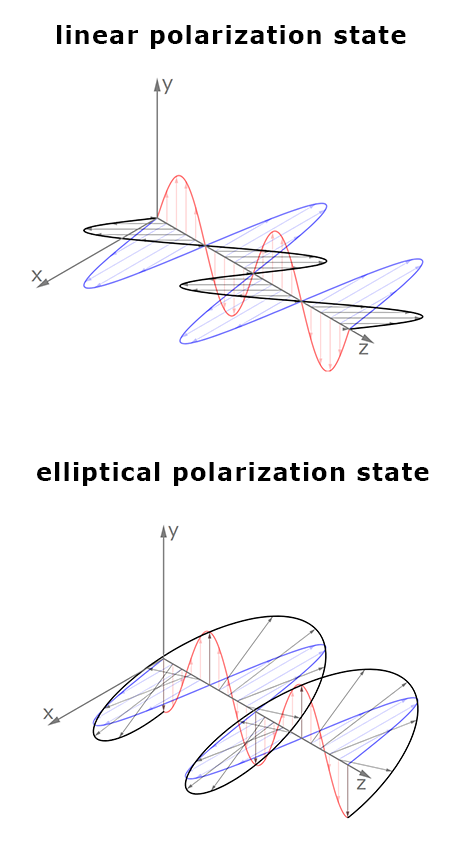

The wave now starts propagating very oddly as shown in Figure 1. While the initial wave was said to be linearly polarized, this new wave is now said to be elliptically polarized. I will show here-below why we talk about elliptical polarization and an example of physical phenomenon that can produce such polarization state.
Figure 1 – Propagation of an elliptical wave
The best way to read the results of Figure 1 is to consider the two separate components Ex and Ey (displayed in blue and red respectively in Figure 1) and to accept that the superposition of these two components yields the black path.

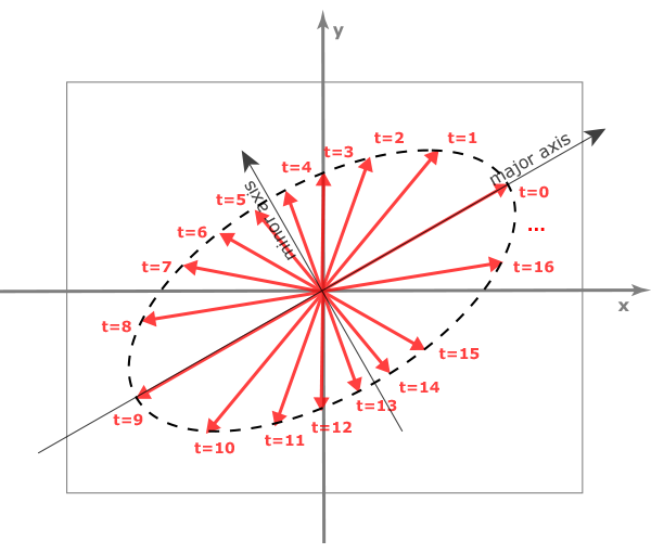

Another way to view what is happening to the electromagnetic field is to look at how it behaves in the transverse plane at some position z. By conveniently choosing z=0, we get
which is the polar expression of an elliptical path progressing at an angular speed ω, as shown in Figure 2 (time normalized for better clarity).
Figure 2 – elliptical wave observed in the transverse direction
The equation of the ellipse being
where δ=φy-φx is the relative phase retardance between the two components of the wave.

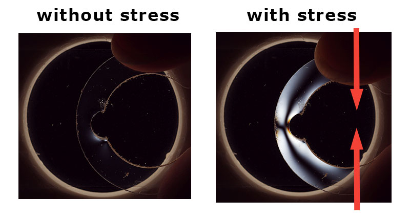

Other samples do not have natural birefringence but acquire one when their lattice is deformed such as when applying stress on them. We call this effect stress birefringence and it plays a very important role in optics. This is illustrated in Figure 3 where we visualize stress in a part under stress using a crossed polarizers setup. The area without stress remains black while color stripes appears in the area with the maximum stress. If you pay attention, you will see some residual stress in the non-compressed part (left-hand side of Figure 3) due to the machining process. Crossed polarizer setups are very convenient to spot issues like these after machining or molding transparent parts!

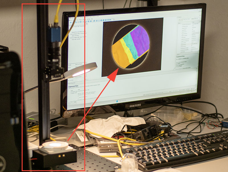

A very good example of stress birefringence can be obtained by pulling a cooking plastic film because it produces stress along the direction of the pull. Although using cooking plastic film works fine, a more repeatable way to address this experiment is by using transparent adhesive tape which is produced by elongating a plastic film in the first place – leaving residual stress in the tape and therefore birefringence. This is precisely what I did in Figure 4 by stacking multiple thicknesses of adhesive tape over a microscopy slide and observing them under a crossed polarizer systems using our fresh new polarized backlight. Note that all the CAD files required to reproduce this experiment can be downloaded here for free for all our Premium members.

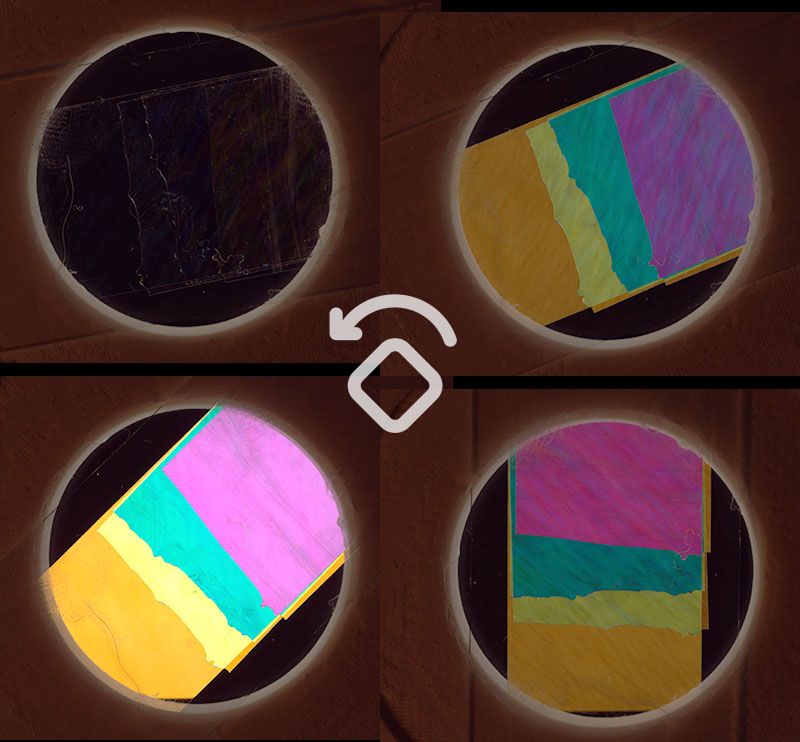

Not only does the adhesive tape show vivid colors in our test setup, but the colors also fade as we rotate the sample along the optical axis as shown in Figure 5 (color tones logarithmically compressed to better map the different light intensities).
Figure 5 – Rotating the sample
We observe in Figure 4 and Figure 5 that the color depends on the thicknesses of the adhesive tape (number of layers used) and that the light intensity goes to a maximum when the sample is at 45° to the backlight (polarizer) axis and to a minimum when it is aligned with either the backlight (polarizer) axis or its perpendicular axis.

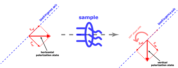

(c) At 45°, and when the phase difference between the Ex and Ey components approaches 180°, the input linear polarization state is swapped such that a horizontal polarization state becomes a vertical polarization state and vice-versa. This is illustrated in Figure 6 where the initial horizontal polarization state is decomposed into two vectors in the basis E45° and E-45°. But because our sample introduces a phase retardance of 180° along the E45° component (and none along the E-45° component), the net effect is to flip the E45° vector (because cos(180°)=-1), yielding a vertical output polarization state.

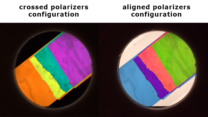

Also, if we modify our experimental setup such that both of the polarizer are horizontal (or vertical), we produce the inverted colors because, this time, the sample rotates the polarizer state such that light is blocked. This is illustrated in Figure 7. Compared to Figure 4, the background is now bright because the default behavior is to block light unless its polarization state is rotated – while in the original setup the default behavior is to block the light unless the polarization state is rotated.
