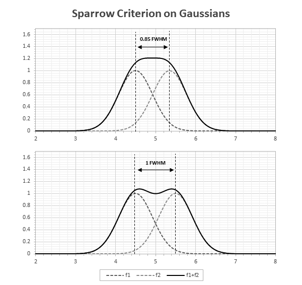

The answer is actually easy: they were trained for that. Any grad student in optics will be able to tell you about the Rayleigh or the Sparrow criterion for resolution which relates the resolution power of a system to its FWHM. This is illustrated in Figure 1 and illustrate that resolution ≈ FWHM. If you are interestedin the 0.85, it is coming from the Sparrow criterion which gives the exact moment where the second derivative cancels and where the two peaks start to be resolved.
Figure 1 – Sparrow criterion on two gaussian peaks

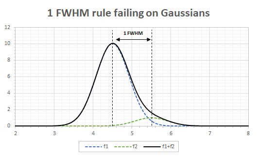

Then, is the 1 FWHM rule wrong? No, but it lays on a hypothesis that is often forgotten: it is true only for peaks of the same height. This is generally not true in spectroscopy where large peaks can be close to smaller ones. This is illustrated in Figure 2 with two peaks that have a height ratio of 1:10. Although the peaks are separated by 1 FWHM, they cannot be resolved anymore.
Figure 2 – 1 FWHM rule on two gaussian peaks with a 1:10 ratio

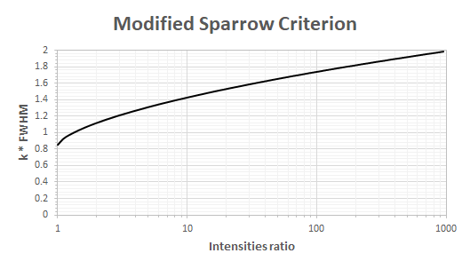

Under these circumstances, the resolution becomes a function of the peak height ratio. To study this dependence, I have run simulations on two gaussian curves with the same FWHM by changing the peak height ratio and checking at how many FWHM they could be resolved by the Sparrow criterion. The results are given in Figure 3. I have limited the simulations to a maximum ratio of 1:1000 because it is unlikely that the dynamic range of your spectrometer will be much larger than that unless you are making very long exposures.
Figure 3 – Adapted Sparrow criterion for varying peaks ratio
The conclusion we can draw from Figure 3 is that resolution is bounded by about two FWHM at the upper range and gets better for peaks of equivalent heights. This is an important conclusion because it allows designing spectrometers safely without knowing too much about the actual user experiments.

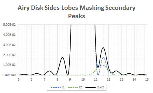

Second, diffraction-limited systems have PSFs that are Airy disks. This is actually a big problem for spectrometers because Airy disks have ripples (side lobes) that can be relatively high. These sides lobes can mask secondary peaks that have low amplitudes. This is illustrated in Figure 4 with a 1% secondary peak. The only way to overcome this is to change the shape of the PSF such that it looks more like a gaussian, since gaussians do not have these sides lobes. Note that gaussians spreads too on the side, but they do not ripple as Airy disk does. I don’t like Airy disk ripples because they can mask automatic detection based on curvature change, such as in the Sparrow criterion. Gaussians just don’t do that.
Figure 4 – Airy disk masking a secondary peak of low amplitude

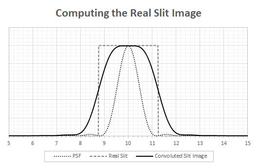

So far, I have only considered infinitely thin slits. However, what we read on the detector is actually the convolution between the PSF and the slit (with eventually a magnification depending on the optical design). This is illustrated in Figure 5. A next question is then: how does the slit size affect resolution?
Figure 5 – Convoluted slit images

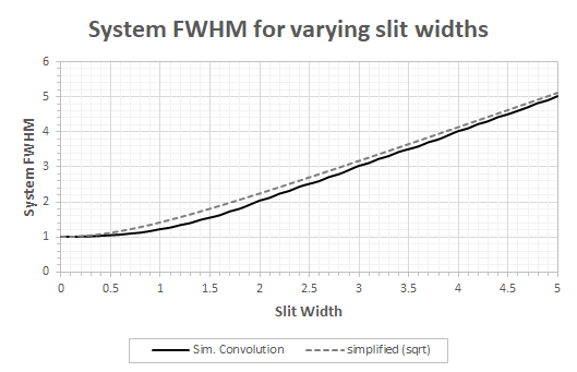

This is the part where designers usually becomes lazy. They have the PSF of their system, the slit size and they just sum the two. Sometimes, they refine the approximation when the slit is of comparable size to the PSF, and say the final FWHM goes as the square root of the sum of the squared terms just as if they were summing gaussians:
Many have committed this crime and I plead guilty too. As a system engineer and optical designer, I did use that approximation quite often just because I was too lazy computing the exact convolution. But is this such a bad approximation?
Simulations can help us see clearer here again. Figure 6 shows how the actual FWHM of a full system increases as the slit size increase. The plot is normalized with the PSF FWHM (so the slit width is expressed as how many times as large it is compared to the PSF).
Figure 6 – FWHM as a function of slit size
From Figure 6 we see that the simplified law follows relatively well the simulation with an error below 20% at maximum. We also see that the simplified law actually underestimate the spectrometer maximum resolution and is then relatively safe to use. So the lazy stuff does actually work! That will help me sleep tonight.
