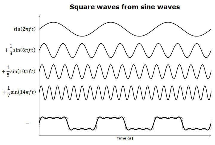

Every student knows that square waves can be made out of a sum of sine waves. If you don’t, just have a look a Figure 1, you will see that it is very straightforward. This is usually presented as an introductory example to Fourier series and, later, Fourier transforms. The question here is: is-it possible to make sine waves from square waves? And this is precisely what this post is all about.

But let first come back to square waves and Fourier series. It is possible to show that a square wave of frequency f can be written as an infinite sum of sine waves of odd terms (i.e.: 1f, 3f, 5f, 7f…):
If you look at the Fourier transform of a square wave you will get something like Figure 2 with a fundamental peak at f, then a peak at 3f of one third the intensity, then a peak at 5f of one fifth the intensity etc. For the sake of clarity, I will now call fn the product of f and n (with n a positive integer). So f1 is f, f3 is 3f, f5 is 5f and so on. f1 will be called the fundamental peak and fn>1 the harmonics. Remember that all of these peaks are pure sine waves because we are working with classical Fourier series.
Figure 2 - 1 Hz Square wave. Top: temporal, bottom: frequency spectrum.
What is important to understand (what you should have a gut feeling for) is that the harmonics is what makes the signal look like a square wave and not as a sine wave corresponding to the fundamental f1. If you remove all the harmonics, you will end up with a pure sine wave of frequency f1 (that is, f). And this is precisely what we are going to do.

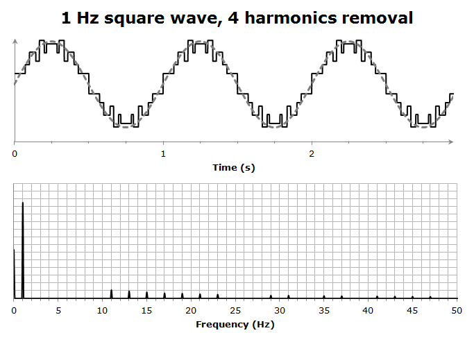

Think of a square wave of frequency 3f for example. Its fundamental will be 3f and it will have harmonics at 33f, 53f and so on. Now we will scale this square wave by 1/3 (using a resistor divider circuit) and subtract it from the original square wave. If we write all the peaks of the spectrum of the original wave and the scaled new square wave we get (I have limited the development to the fourth first harmonics):
So we got rid of the harmonic f3 and f9. Actually, you can show that we got rid of all the f3n terms.
We now have a wave that behaves like
We will then repeat the process but with a square wave at 5f scaled down to one fifth:
which get rid of all f5n terms. However, something gets wrong here for frequencies that are both multiple of 3 and 5. Let’s take f15 for example. Because f15 is a multiple of 3, we already got rid of it using the first subtraction. Indeed, the 3f square wave had harmonics at f9, f15, f21 and so on. So when we next subtract f15 with the 5f wave, we end up with a non-zero term that should be cancelled with further subtraction. So, be careful when applying the method because you should watch the effect of every subtraction.
We may continue by subtracting a 7f square wave scale down to one seventh which yields:
As a consequence, with only three subtractions we have cleaned the four first harmonics of our signal which now looks like Figure 3.

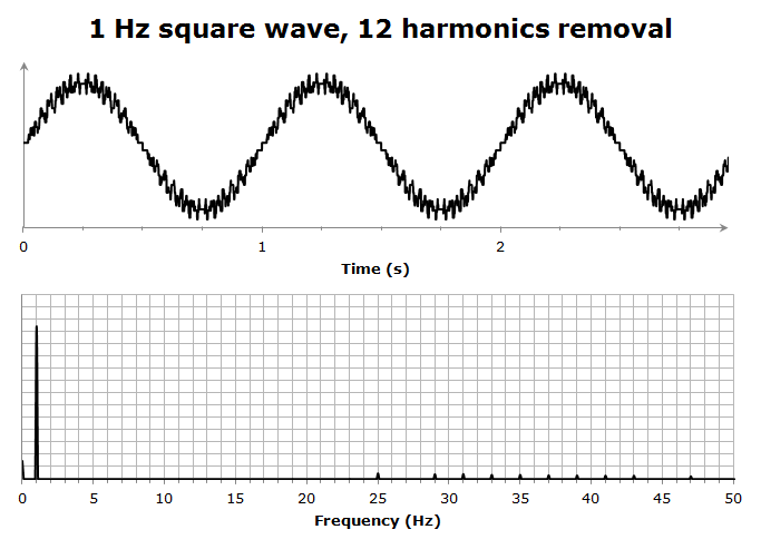

This already looks more or less like a sine wave but it’s still not really that good. By subtracting harmonics up to f21 we end up with a wave like on Figure 4. It’s already much better.
Figure 4 - 1 Hz Square wave with 12 harmonics removed. Top: temporal, bottom: frequency spectrum.
But wait… how much harmonics should we remove until we get a perfect sine wave? The theoretical answer is an infinite number of them because the Fourier series is infinite. This is where the low-pass filter comes into play. You may want it or not but somewhere in your circuit an element will limit the bandwidth to a maximum frequency fbw. To avoid non-reproducible results due to uncontrolled low-pass effect in components, let’s say we have a sharp low-pass filter at 100 kHz that will cut-off any frequency above that. We have seen that if we use a square wave with a frequency slightly below that we will get a perfect sine wave but if we lower the frequency too much we will leave the first harmonics intact. So we don’t have much choice and we can only play with a frequency of about 100 kHz.
In our example, we showed that it is possible to get rid of the four first harmonics by subtracting three square waves. That means the first non-zero harmonics is f11. What we would like is that all harmonics above f11 be removed by the low-pass filter. This will be accomplished with any output signal between 10 kHz and 100 kHz approximately. If we continue subtracting square waves up to, say, f101, then we could get any signal working from about 1 kHz to 100 kHz and so on.
